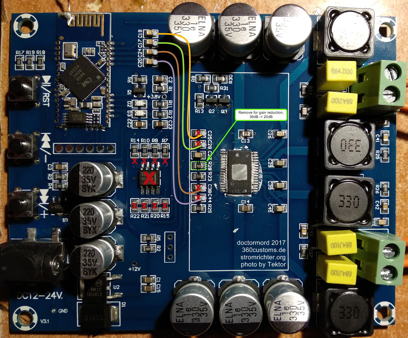

How to fix/remove/bypass the (unneeded) Diff2SE stage:
attachment.php
Keep wires (per channel) close together. Every component with an X needs to get removed.

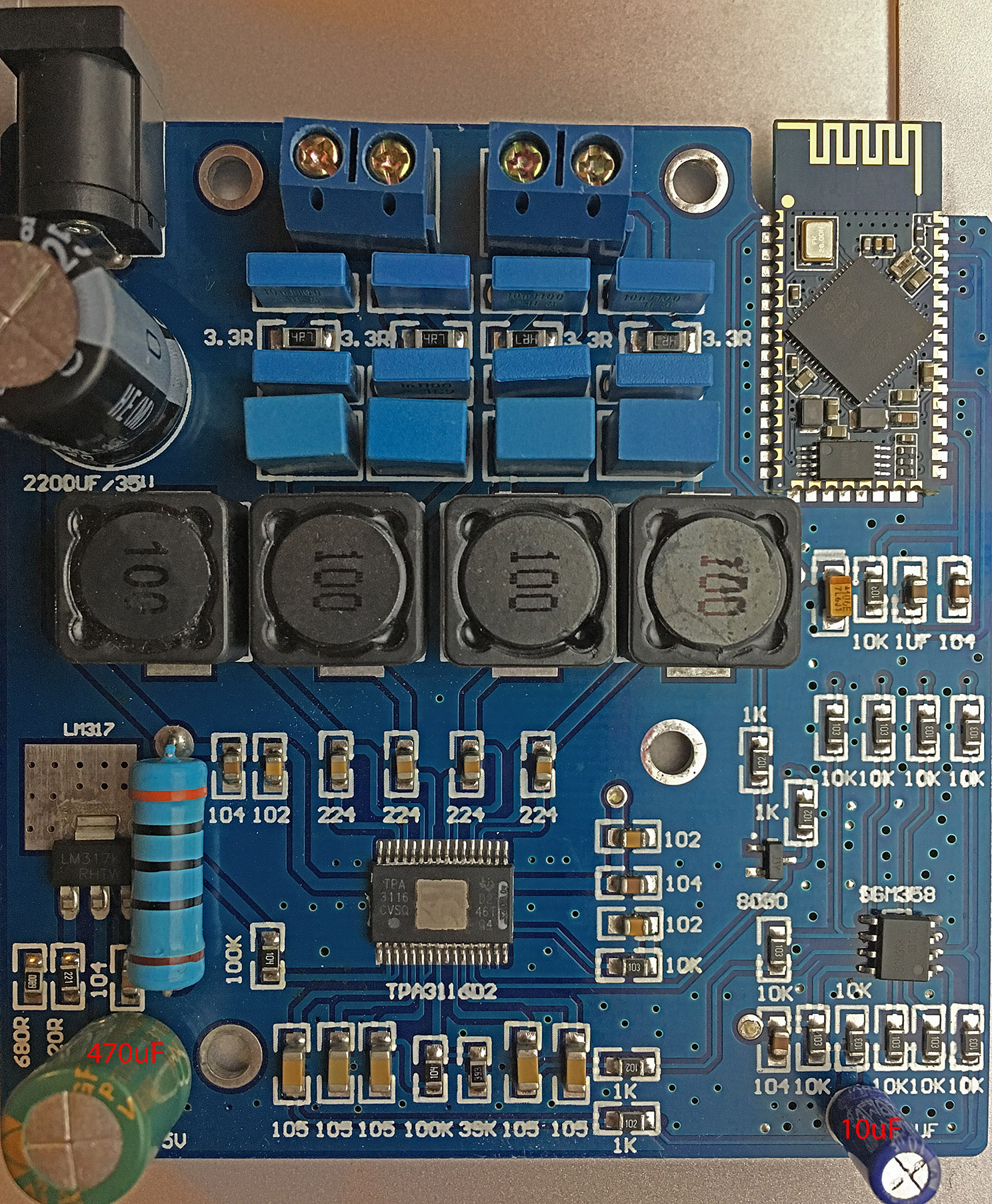

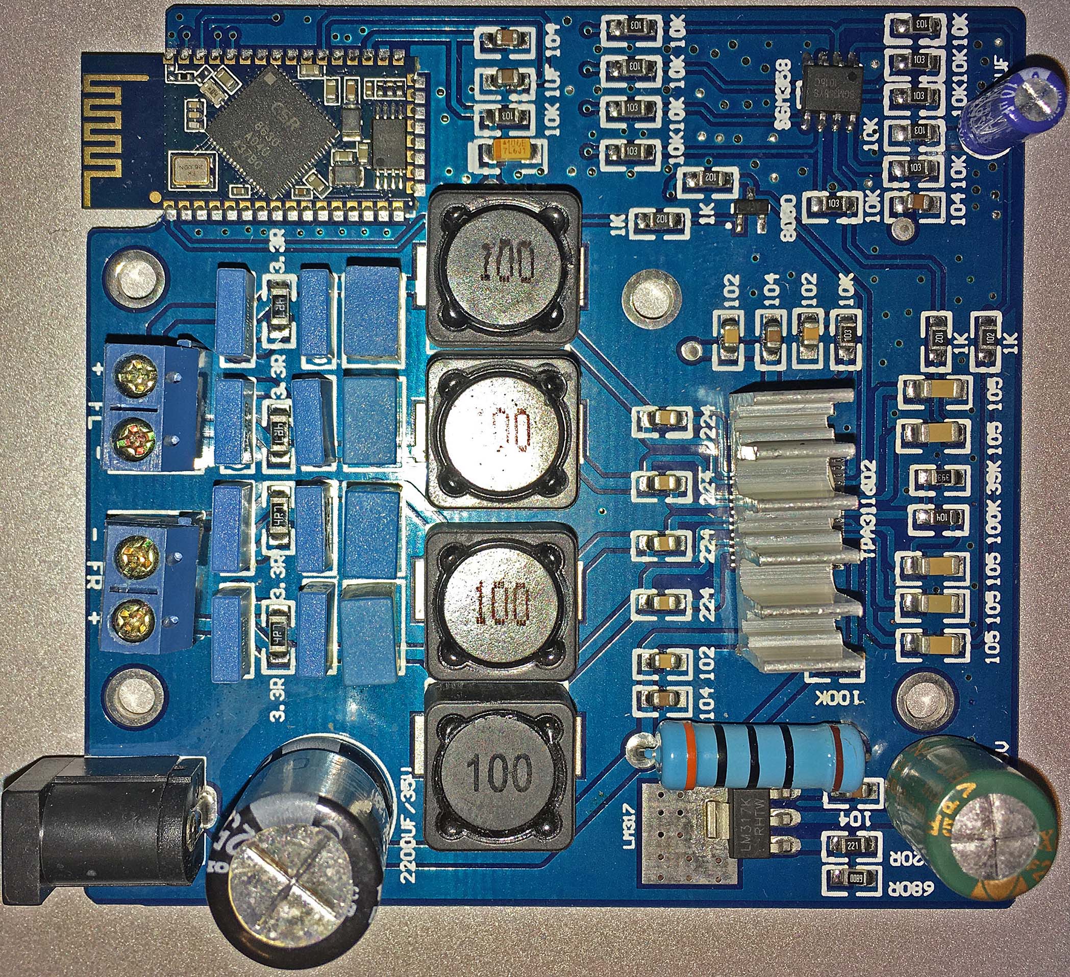

Sorry to almost raise this one from the dead but someone posted on page 2 about a YJ board very similar to mine (but mine doesn't have tone controls and is stereo only). But I wasn't able to glean a fix from his post. Amp is from here: Yuan Jing Audio - TPA3116 Class-D Stereo Amplifier Board [50W x 2] + Bluetooth V4.0 - USD $32.25
This board is a bit different from the Sanwu ones so I was hoping someone could give some pointers on getting rid of the hiss and turn on pop. The output from the bluetooth module goes thru 10K resistors and then in the SGM358 opamp. This is different from the Sanwu one that has capacitor and resistor before the opamp. I don't know enough about electronics to know if it's safe to bypass the opamp.
This board has some other really strange issues like the phase is reversed on one of the outputs and the bluetooth beeping sounds are always at 100% volume. I really wouldn't recommend it to anyone.
