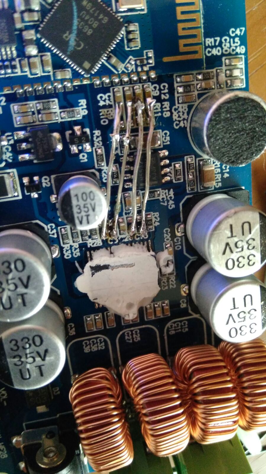

Just want to say a thank you to doctormod for this little tutorial. I bought the board from aliexpress for £11, did the mod and I can confirm audible hiss has gone down significantly, enough to be certain it's not just my imagination and then some. Much better 🙂

Now that's some solid wire. 🙂 Take care with the heats ink, not to short anything. I'd recommend to renew the thermal compound as this white snot is rather useless for heat transfer.

This is just an example. I'd try 1k series resistors with a 10k pot. 100k may lead into increased noise.

I finally got around test my v2.2 board.. Lots of white noise even with 83db speakers. After the mod it's dead silent even close to it. This must be one of the best cheap BT amps at the moment 🙂. It might even be quieter than the regular sanwus?? Thanks for the mod Doctormord!

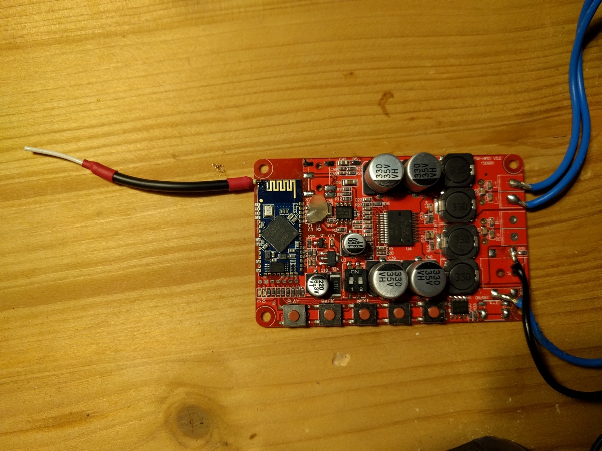

I wasn't too happy reworking smd but was really annoyed by the hiss, so i decided to try this. My board is dead silent now, i've just added a short piece of shielded cable to the tip of the antenna (shield not grounded).
As far as I know, it works because the antenna sends from the sharp point, so if we take this sharp end away from the board no more interference gets induced. I am sure this could have been fixed in the design of the board, even with their additional components there. In this Stackoverflow answer is an image of the radiation profile: https://electronics.stackexchange.c...ooth-antenna-affect-the-transmission-distance
The other mods i've done is to make it a mono amplifier and remove the connectors.
Soldering a short piece of copper cable (2inch or so) to the Bluetooth antenna sorted it out and reduced the noise to almost imperceptible levels. (best result was found by attaching the wire to the antenna at the nearest point to the edge of the board.
Follow up question... Why does this work?

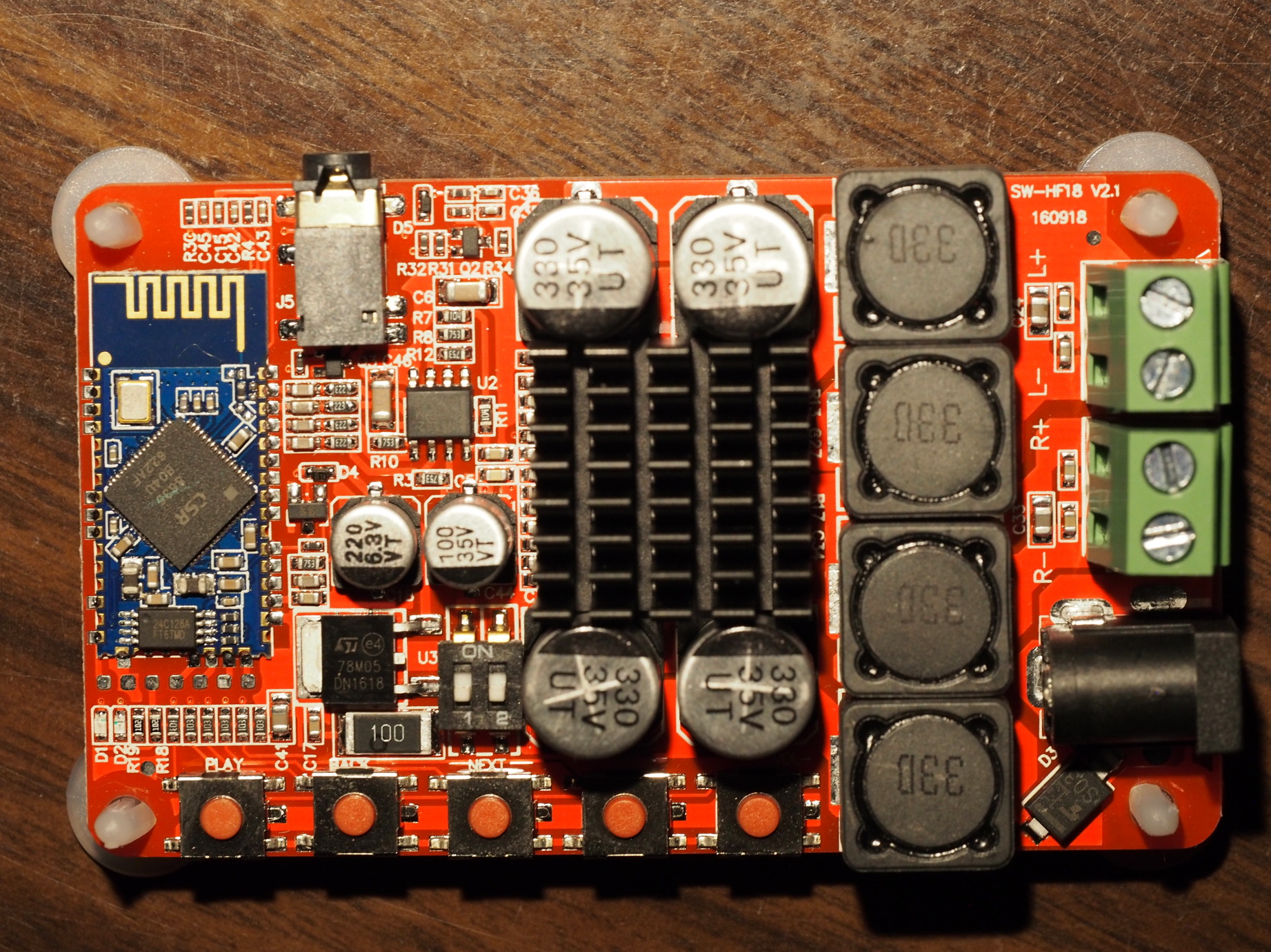

I have the same board and have noticed that although the usual buzzing, hissing, and popping on low volumes and disconnects happens both channels, on the left channel only, I get a sort of building up buzzing then pop sound. I'm guessing that this is to do with the capacitors loading up, but why does it only happen in one channel?
Also, does your suggested fix break the line input, because I would like to be able to use it as well instead of bluetooth

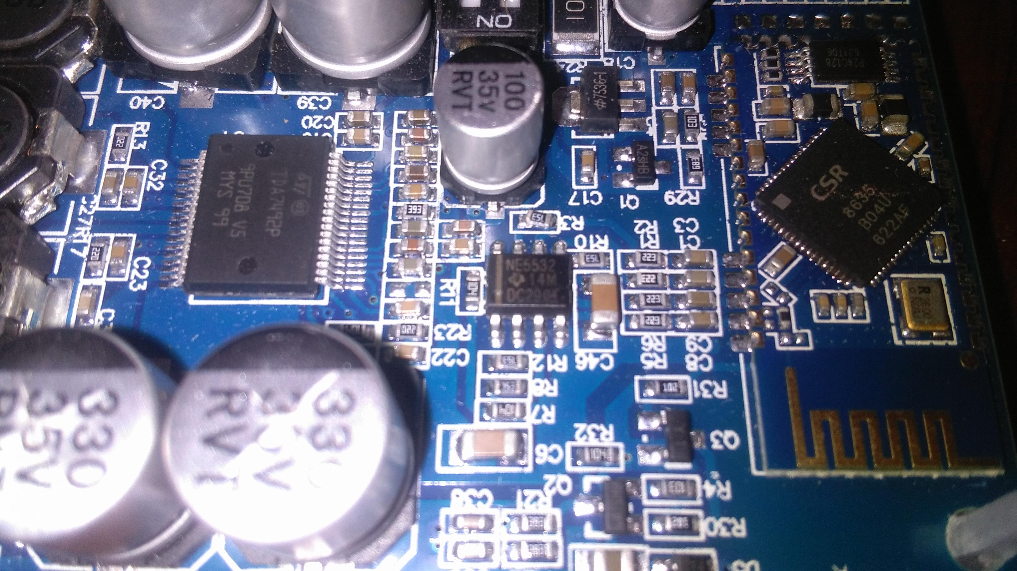

Yes, if the linein/AUX isn't routed via the BT module. (Which it isn't on the boards i know) This is due to removing the Differential2SingleEnded "Converter". (Opamp)
