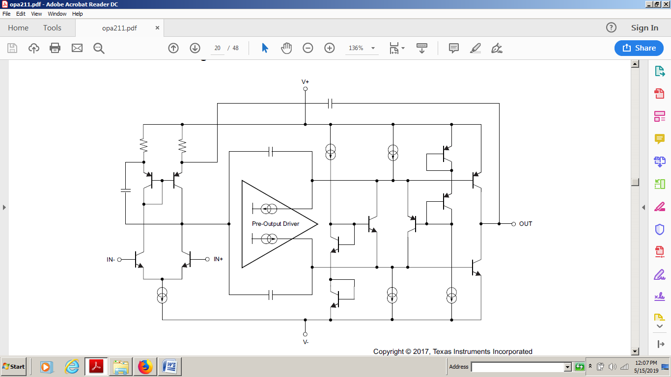

Emitter followers can be influenced from the 'outside' easily. [This depends (of course) on the internal construction of the opamp]
i can't see any emitter follower in opa211 datasheet...
you can't load the first op-amp because of the second one...and if you want it loaded you don't need the second op-amp anyway...you just load it and buffer it with anything.
You are right, I was stupid enough to post the idea not checking the datasheet :) OTOH you may be (like I am) interested(provoked) to try other opamp's :)

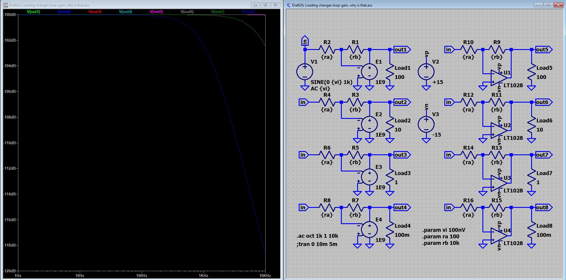

Loading the first op-amp's output with a 1 ohm resistor will cost you lots of loopgain, no matter whether it has an emitter follower or a Monticelli output stage, because the open-loop output impedance will in either case be well above 1 ohm. When you reduce loopgain, you will also have to redesign the frequency compensation.

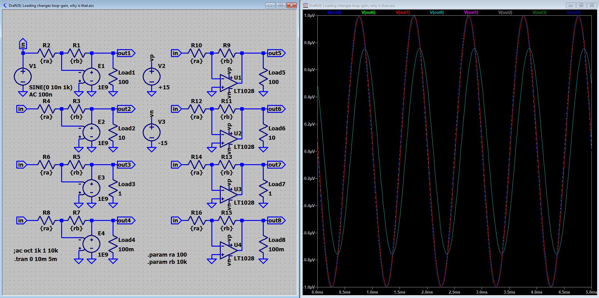

Only V(out8) has it's loop-gain changed by loading (it seems). When studying it better you will realize that the lowered output voltage is due to the output impedance of the amplifier.

See that, as predicted before, the GBW is influenced by low impedance loads. See V(out7) and V(out8)
