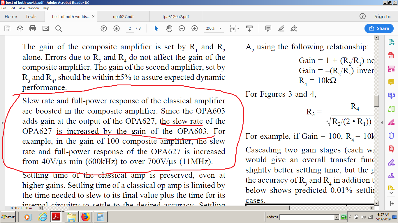

that gain in the second stage is supposed to multiply the slew rate of the input opamp .As A1 needs to have at least 2x the gain of A2 it's clear that setting a higher slew rate amplification will also lower the THD specs . Of course op211 doesn't need more slew rate, but with less expensive op-amps with good offset specs might be a good deal .That version has far less low-frequency gain due to the local feedback around the second stage.

As long as the input frequency f stays under certain limits following SR>>2*pi*f*Vpk, slew rate performance has nothing to do with THD. 50V/uS or 5000V/uS will provide at, say, 3Vpk exactly the same THD @1KHz or @10K or @100KHz.
SR does not get “amplified” or “multiplied” or anything like this. A2 simply lowers the output swing of A1 (which may as a result not enter into slewing limitations), then A2 (op amp with higher SR) provides the full output swing.

The circuit "multiplies" the slew rate of A1 only by reducing its output swing, that's it. You still wouldn't be able to exceed the slew rate of A2 or anything.
I'm pretty sure that syn08 understands this based on his reply.

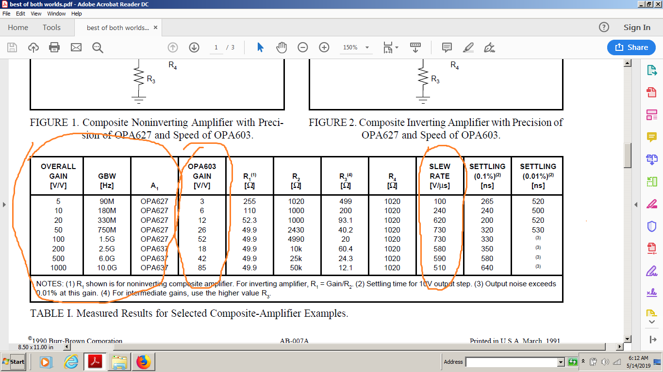

Calling it slew rate multiplication just doesn't make sense. The OPA603 has a slew rate of 1000V/us by itself. The composite amplifier in the app note is always lower than this if you check the table.
There's a lot of confusion about opamp slew rate. It is mostly determined by the (parasitic or comp) cap hanging off the internal gain node, and the internal current available to charge/discharge it.
How can that change when you wrap the opamp in a composite loop??
I suspect that in many of these app notes when they write slew rate they really mean rise time.

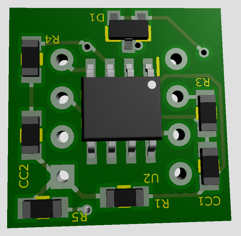

Back to topic. Anybody planning to build or measure any of these? I have a couple of spare adapter boards left. Say euro 5 including shipping?

Jan yes please! I wish to buy enough boards to build 3 composite opamps. Giving me the opportunity to make one unrecoverable error and still get a working stereo pair.
Sure, send me your address.
5 spoken for, 2 left.
Jan

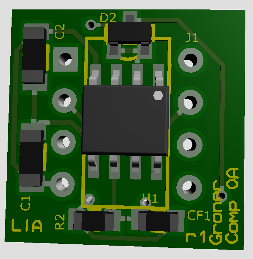

Here's the build info. As usual, the square pad is pin 1 of the DIL footprint. That also determines the top of the board when fitting DIL pins; the top also has the text 'Groner Comp OA'.
All parts are size 0805. Use MF for resistors, film caps for the comp and ceramic for the two supply decoupling.
Opamps are SOIC.
Don't forget to connect pin 1 to signal ground.
