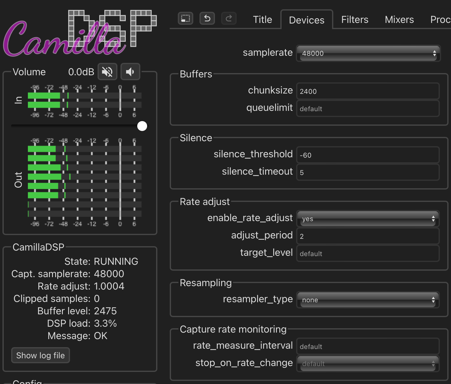

Hi @mevang, thanks a lot for your reply and help!
My status:
  • Wiim Ultra successfully connected via USB-C splitter (power supply on one of the outlets)
  • Wiim is recognising the Raspi as Linux DAC: Linux 6.6.28+rpt-rpi-2712
  • CamillaDSP works perfectly with a fixed samplerate (currently 48 khz)
  • I followed the camilladsp-setrate Github tutorial https://github.com/marcoevang/camilladsp-setrate until point 7. After that, I tried a few of the commands with the given flags, but usually got error messages and nothing changed.

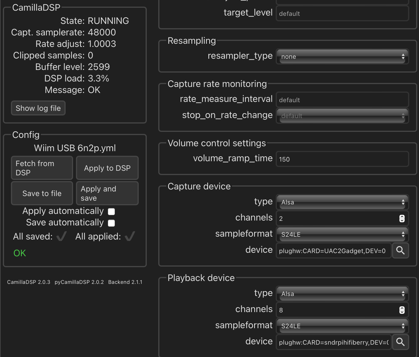

4) Check that the camilladsp configuration file specifies the USB Gadget as capture device and your DAC as playback device.
-> How do I do this? Which file is this?
I mean the .yml file containing the configuration of camilladsp.
The "devices:" section in that file shall contain the specification of the capture device and of the playback device, something like this:
devices:
capture:
type: Alsa
device: "hw:UAC2Gadget"
playback:
type: Alsa
device: "hw:sndrpihifiberry"
I strongly recommend you to study in depth the camilladsp README.md page:
https://github.com/HEnquist/camilladsp
it seems like the Wiim Ultra isn’t properly configured as the playback device in camilladsp-setrate.
In camilladsp-setrate you only have to specify the capture device. If you omit that specification, the default value is ‘hw:UAC2Gadget’, which is the correct one.
The playback device must be specified in the camilladsp configuration file as shown in the example in my previous post.

Please find two screenshots of my CamillaDSP device settings attached.
Capture device: plughw:CARD=UAC2Gadget,DEV=0
Playback device: plughw:CARD=sndrpihifiberry,DEV=0
Would be amazing if you could help me further based on these infos 🙂

.if I then go back to the 48 Khz track it's stuck on the 44.1 Khz setting.
If you have not already done so, please enable the ‘Rate adjust’ parameter, otherwise you may experience a buffer underrun (refer to camilladsp homepage for further information).
You can do this from the camillagui web interface by setting ‘enable_rate_adjust’ to ‘yes’ and clicking on 'Apply to DSP'. Or, even better, enter the following line in the ‘devices’ section of the camilladsp configuration file
enable_rate_adjust: true
