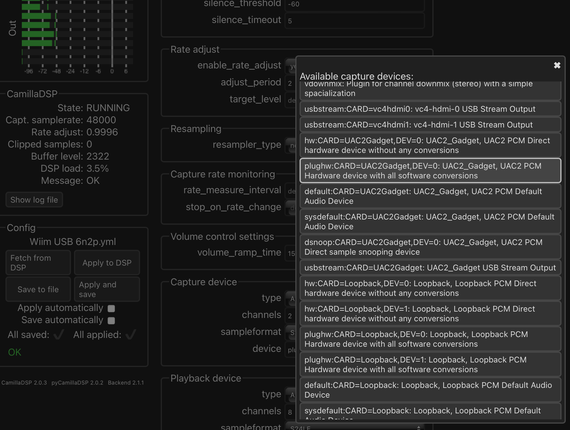

Well, the GUI config is another layer. I would recommend to modify the CDSP config file directly, no extra layer of complexity. But your choice...
I use the GUI, as I don't know much about Linux commands. All Linux commands, I learned / looked up only in the context of setting up CamillaDSP and CamillaDSP-Setrate. What is the exact file name of the CDSP config file? I'll try to have a look. This is what I see in the CamillaDSP directory:

Where do I find the g_audio config?
By now I understood, how I can open and edit the .yml camillaDSP configuration file (see screenshot). I also changed the device in nano to hw:UAC2Gadget, but that still doesn't allow me to play sound, so I reverted to plughw:CARD=UAC2Gadget,DEV=0 for now.
No idea how you load the kernel module in your setup specifically. There the module would have its params specified (c_rate, c_size, etc.).
If you want me to help, please do not post screenshots. Post the whole text info wrapped into the code tag so that one can read it easily.
Likely the accepted device format (samplerate?) does not fit the configured one in CDSP. CDSP logs would tell the details. Did you actually check the CDSP logs?

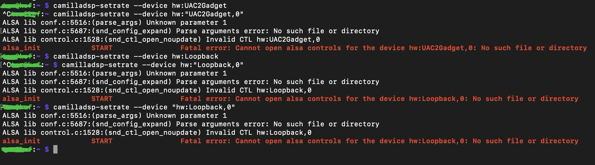

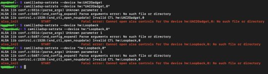

You should also indicate the device number to specify the capture side of the loopback device
Ah, ok. I'm wondering if I even ever got setrate running then, because it gives an error message when I specify a subdevice (such as hw:Loopback,1).
I assumed it didn't need to specify a device as hw:UAC2Gadget is specified without device as well. And fails too if I e.g. use: hw:UAC2Gadget,1
What should actually happen when I use the command? If I don't specify anything (just setrate without parameters), I get a blank response, and have to press ctrl+C to get my cursor back. I assumed this was normal behavior and it means it's running?
The same happens if I use
camilladsp-setrate
camilladsp-setrate --device hw:UAC2Gadget
camilladsp-setrate --device hw:Loopback
Just the blank response. If I specify a device I get:
E.g:
:~ $ camilladsp-setrate -device hw:UAC2Gadget,1
ALSA lib conf.c:5516: (parse_args) Unknown parameter 1
ALSA lib conf.c:5687: (snd_config_expand) Parse arguments error: No such file or directory
ALSA lib control.c:1528: (snd_ctl_open_noupdate) Invalid CTL hw:UAC2Gadget,1
alsa_init START Fatal error: Cannot open alsa controls for the device hw:UAC2Gadget,1: No such file or directory
Or:
:~ $ camilladsp-setrate -device hw:Loopback,1
ALSA lib control.c:1528: (snd_ctl_open_noupdate) Invalid CTL hw:Loopback,1
alsa_init START Fatal error: Cannot open alsa controls for the device hw:Loopback,1: No such file or directory
What should actually happen if done correctly?
Thanks a lot again!

My system is indeed configured the way you described it. Input to the Loopback is 0 and output 1 (I'm actually doing this opposite of what is specified by the mdsimon2 guide for other reasons). So I'm aware how ALSA works.
It's good info that the input to setrate needs to be the same side that goes to CDSP. I would have thought that to be irrelevant as the sample rate should be the same on both sides of the loopback? So I just set it to what I figured would be the source.
Unfortunately, it yields no difference in result:
Code:
xxx@xxx:~ $ camilladsp-setrate --device "hw:Loopback,1"
ALSA lib conf.c:5516:(parse_args) Unknown parameter 1
ALSA lib conf.c:5687:(snd_config_expand) Parse arguments error: No such file or directory
ALSA lib control.c:1528:(snd_ctl_open_noupdate) Invalid CTL hw:Loopback,1
xxx@xxx:~ $ camilladsp-setrate --device hw:"Loopback,1"
tor@kef:~ $
(Hope the text is readable, because the formatting looks terrible, which is why I resorted to screenshot. I will try to add a code tag to see if it will fix it).
At this point I'm pretty well versed in how the ALSA system works. My main issue is not yet having a full graps on Linux (beginner since 3 month of getting into CDSP and RPi). For example when you say to use Quotation marks, I'm not sure if hw should be included (which is why I tried both in the example above and previous examples. Thanks again for the help and understanding.
Indeed, the device number does not have to be specified. I apologise for giving you incorrect information; as I have already said, I am not an expert on the alsa sound system, I only learnt just enough to develop the software.
