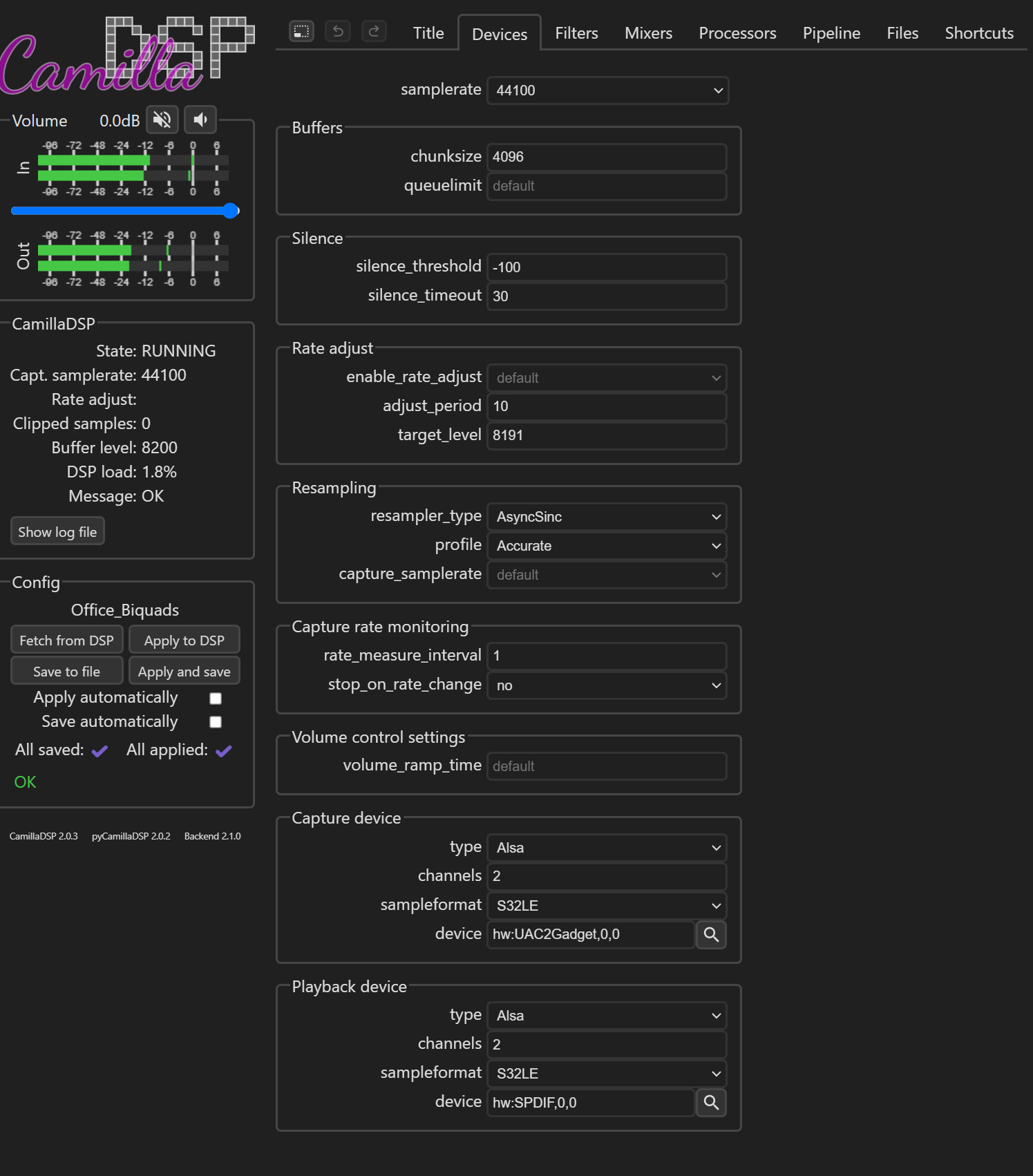

How did you switch to USB Gadget mode and enable loopback? It seems a bit that my issue to get camilladsp-setrate to work properly is centered around these settings. Could you please do me the favour and send me a few screenshots of your camillaDSP devices settings? Especially also from the Capture Device and Playback Device drop down menus, to see which device you've selected. Attached you'll see what I mean, I've highlighted with the mouse curser the device from the drop down menu that plays audio in my setup currently. Thank you!

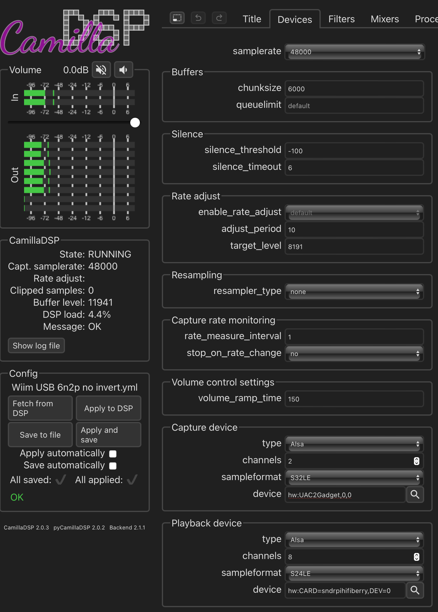

Sorry about the delay in responding, I just saw your post. I have not been in here much lately.
To implement USB Gadget mode and enable loopback, I followed step 8 in this tutorial: https://github.com/mdsimon2/RPi-CamillaDSP
Below is a screenshot of my "Devices" tab. I'm not sure what other settings you need.
  • Thank You
Reactions: Airharder
Terry, thank you so much! Pointing out the step 8 in the tutorial link, was exactly what I was missing to finally get this hw:UAC2Gadget,0,0 working as capture device! So I'm finally one step closer. Unfortunately camilladsp-setrate is still not working properly for me. Looks like I need to investigate further. So far I have used this code to enable USB gadget:

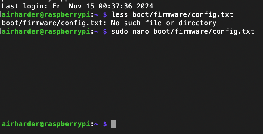

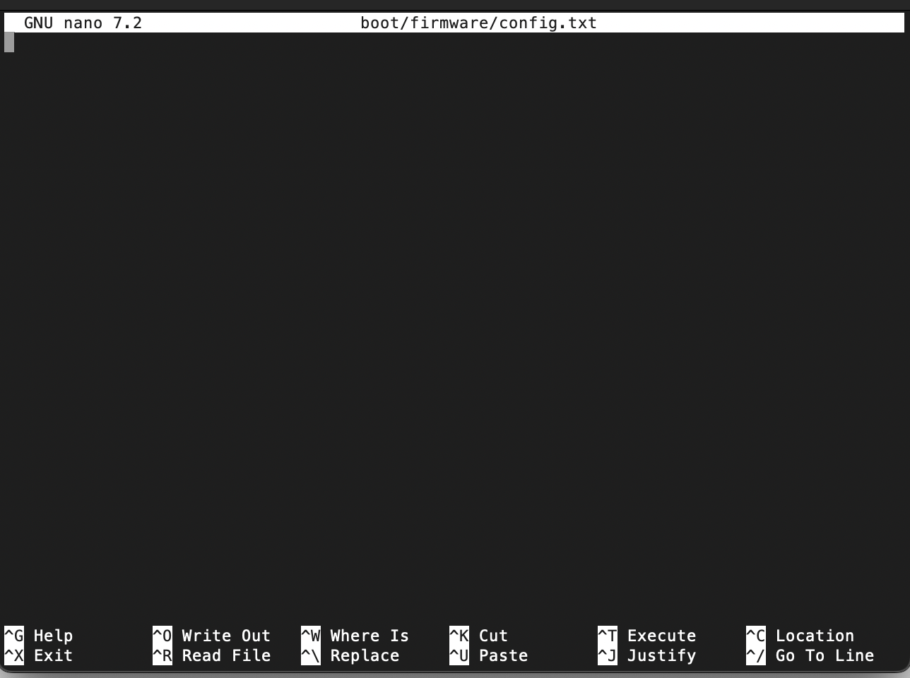

Code:
echo 'dtoverlay=dwc2' | sudo tee -a /boot/firmware/config.txt > /dev/null
echo -e 'dwc2\ng_audio' | sudo tee -a /etc/modules > /dev/null
echo 'options g_audio c_srate=48000 c_ssize=4 c_chmask=3 p_chmask=0' | sudo tee -a /etc/modprobe.d/usb_g_audio.conf > /dev/null

I made sure that hw:UAC2Gadget is the camilladsp-setrate device:
Please see the logs below. It works only with 48000 Hz, which is what I've specified in the USB Gadget. Specifying multiple sample frequencies in the USB Gadget didn't work for me so far - guess this is where the issue is now.

Thanks Henrik! As I'm new to Linux I haven't figured out how to get to these:
/etc/modules
I only see this:
Code:
airharder@raspberrypi:~ $ dir
Bookshelf   camilladsp-setrate    Documents  Music     Public    Videos
camilladsp  Desktop    Downloads  Pictures  Templates
airharder@raspberrypi:~ $ cd /root
-bash: cd: /root: Permission denied
With cd /root permission is denied. What am I doing wrong here - how can I access the above files?
Start by looking at the files with the "less" command, for example:
less boot/firmware/config.txt
And use "nano" to edit. You will need superuser access to edit theses system files so you will need to do "sudo nano":
sudo nano boot/firmware/config.txt
Other useful commands are "ls" (instead of "dir") for listing files. Add "-l" to get more details, "ls -l". And "pwd" tells you the current path.
  • Thank You
Thank you Henrik! I've tried these commands, looks like the boot/firmware/config.txt is completely missing (see screenshots).
How can I recreate this?
