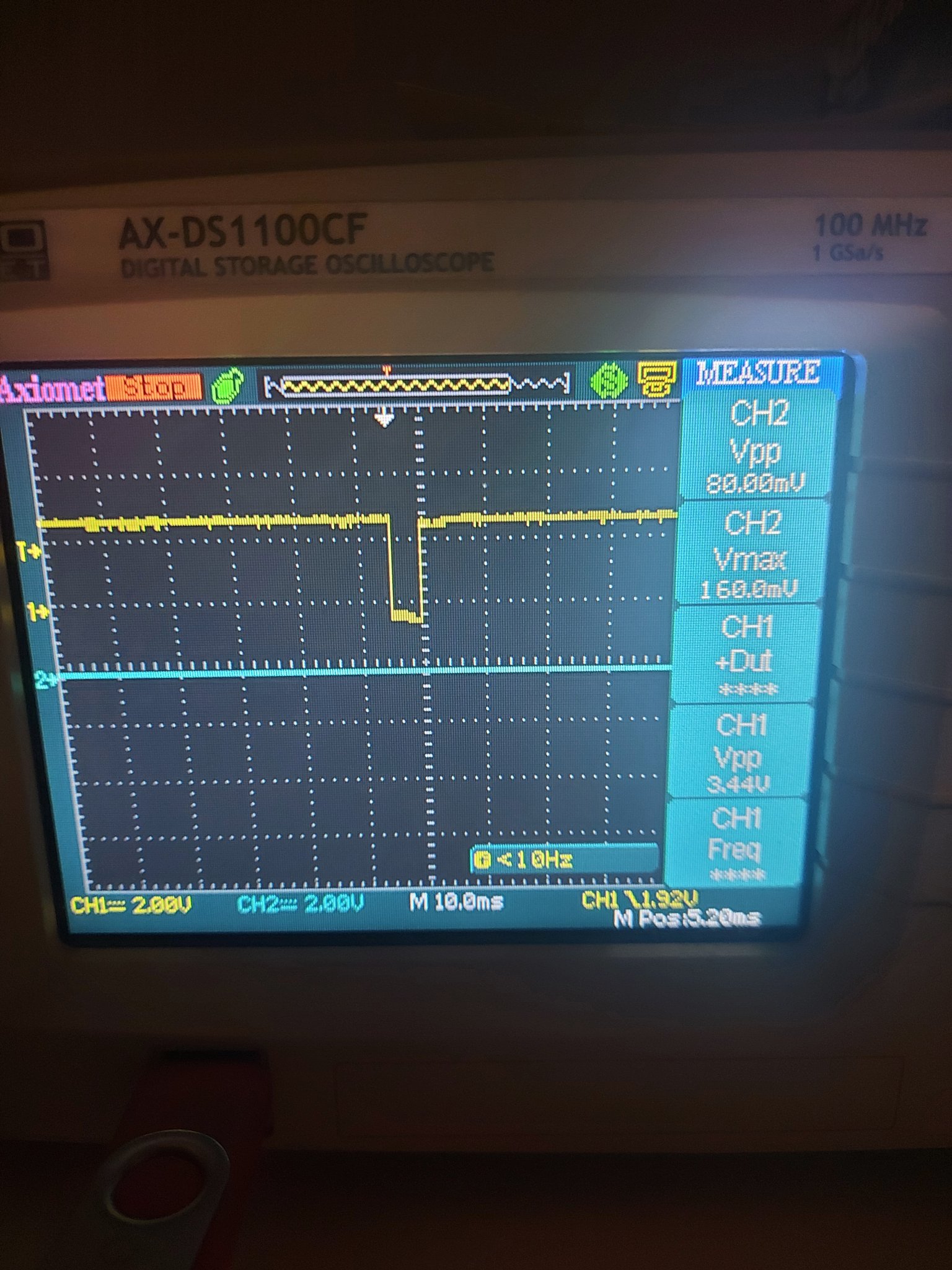

I have 39 ohm on output to 74ac157 and from 74ac157 also to dac.

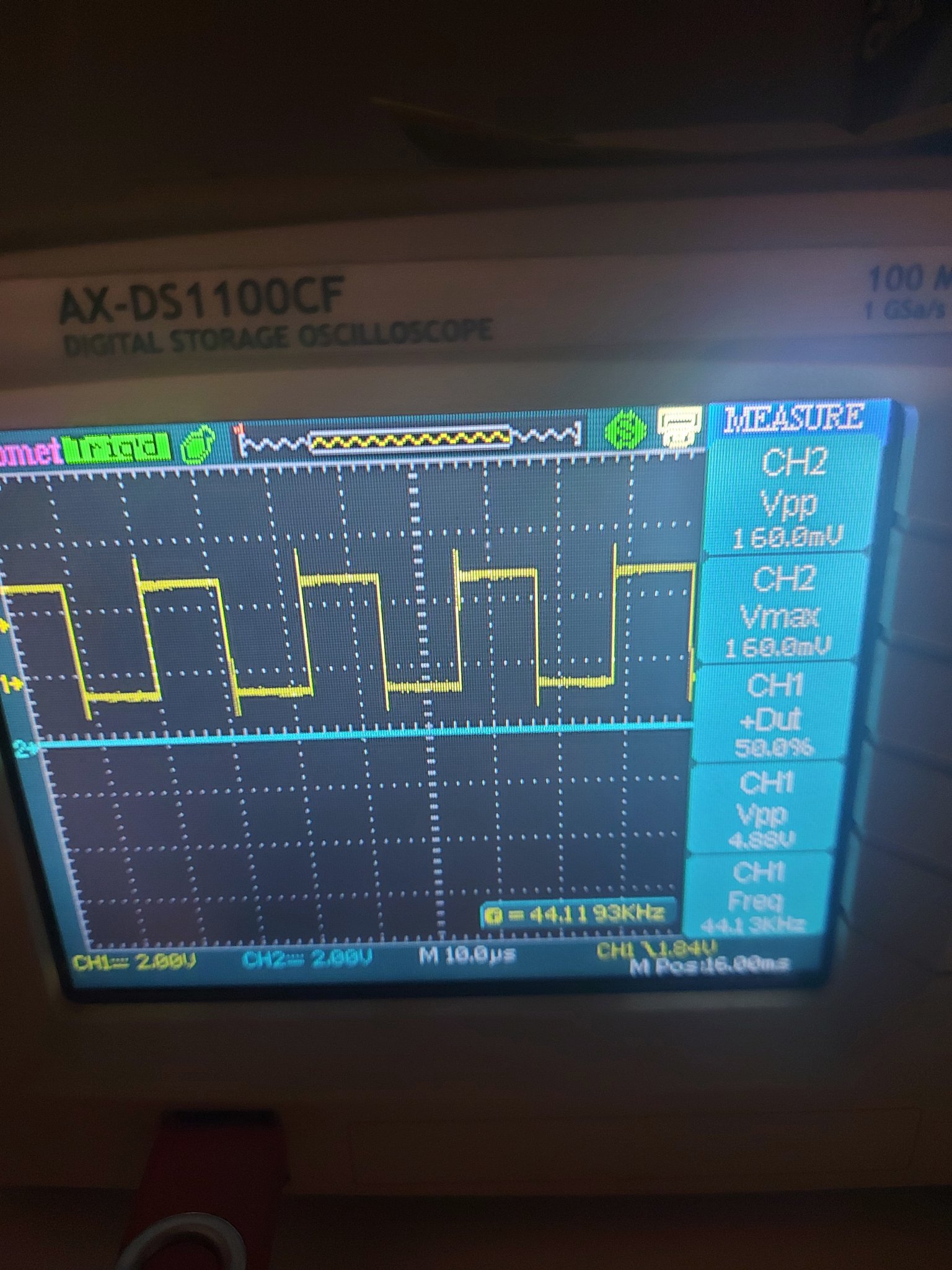

I saw, how look scope with/without this 39ohm, better with.

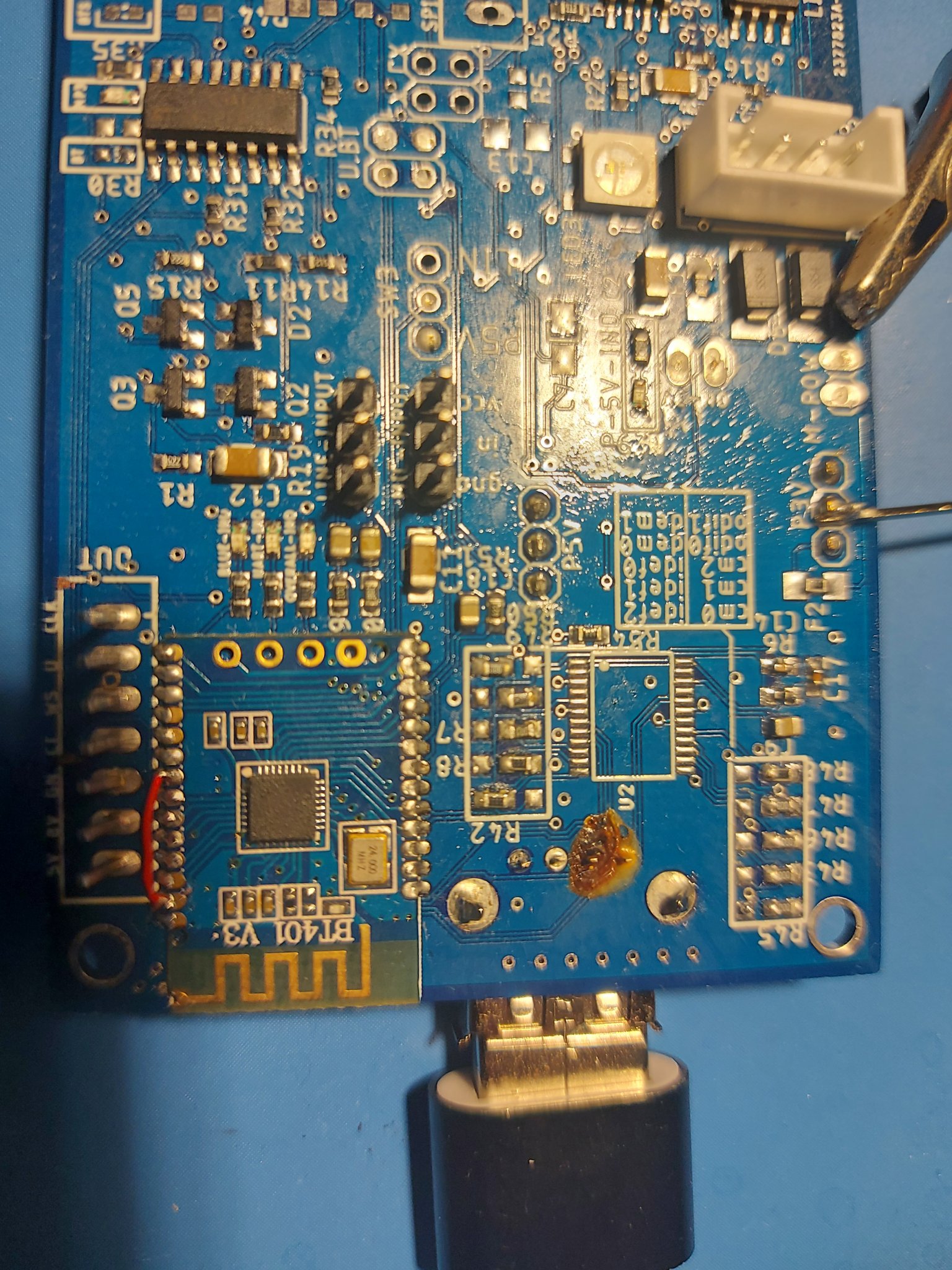

Now i have some problems with hardware, so now i need make some modification, i had to pull this chip up..
Do you have to scope to verify input signals are correct?
Yes, sorry for quality
input signals correctly connected, mute to L, setup:

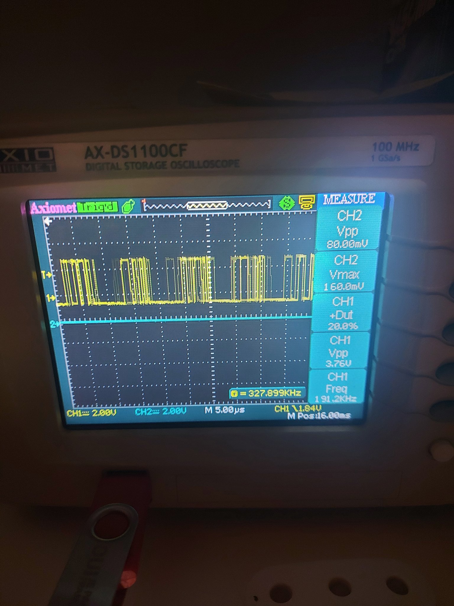

It is look like PLL not lock..output strange, all on L state, should be H...

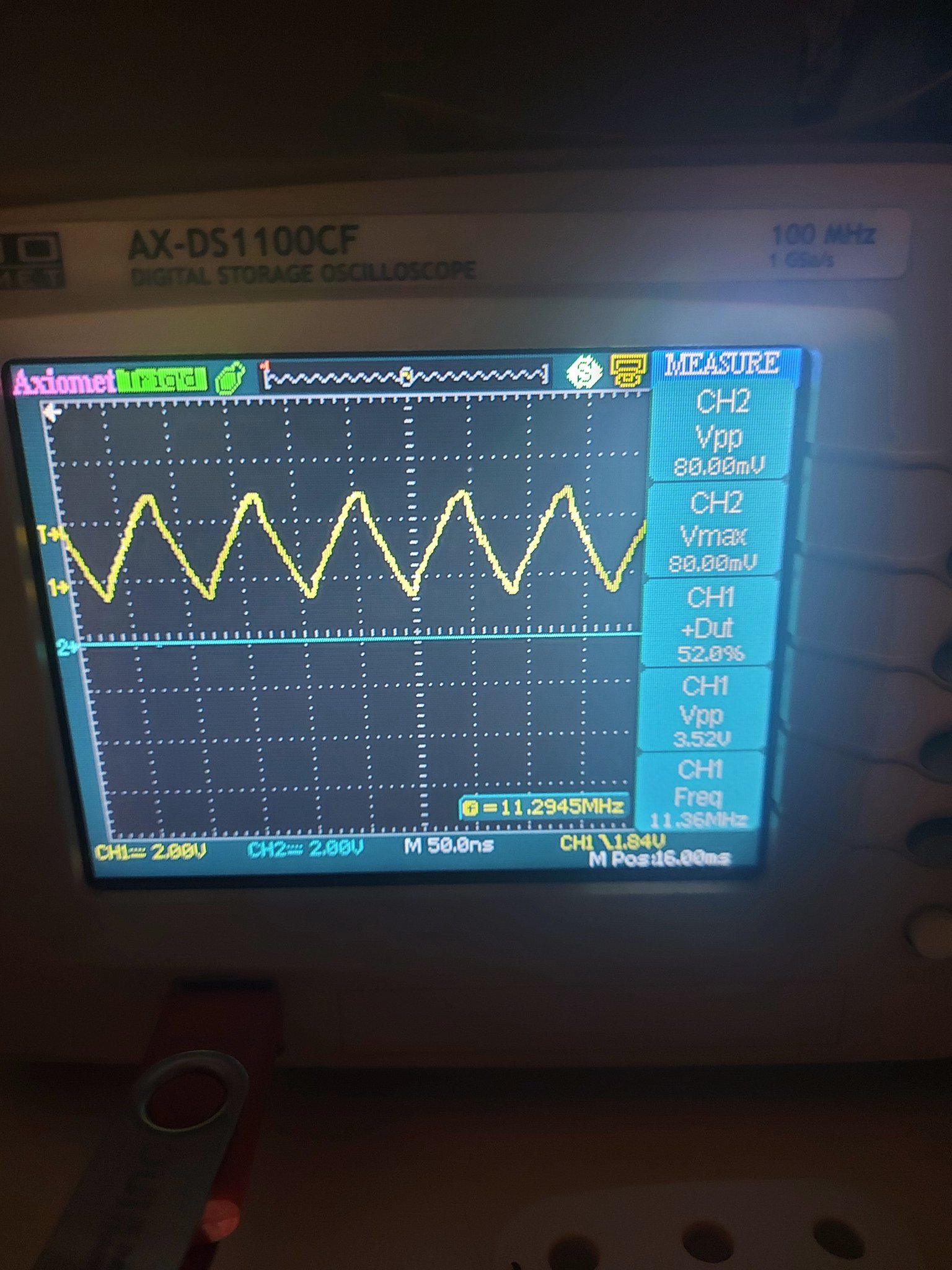

i looking for this...is clock should be 2,822,400MHz for 32 bits and 44.1K sample and not more?
i connected 11M..it is to fast....
I setuped bypass-mode, works correctly
output work, so chip has problem with setup cmode.

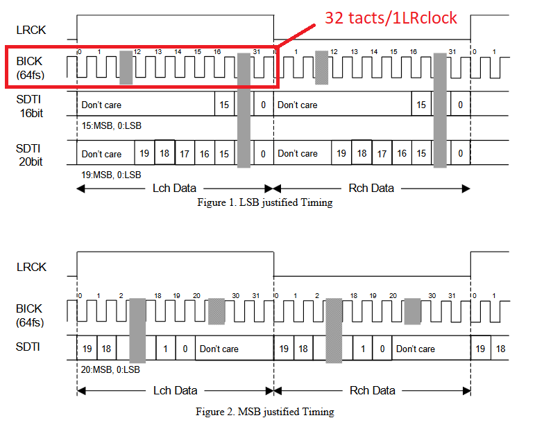

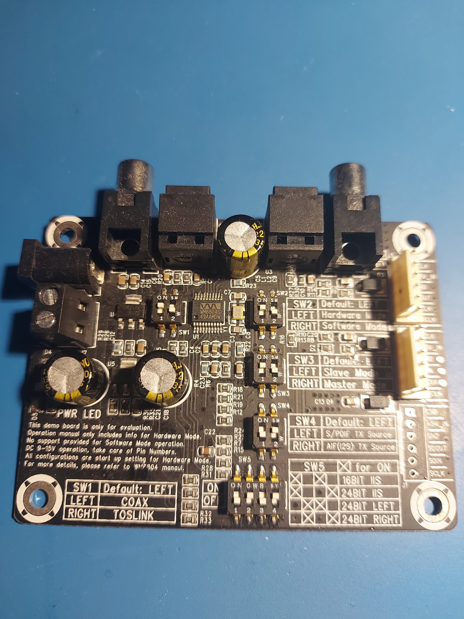

I2S clocks and data from the source device should be sent to AK4121 inputs. The 11MHz Master Clock is a separate signal that can be used as a frequency "reference" for the PLL (which tracks then incoming clocks to help convert the sample rate in the correct frequency ratio). Using a reference clock should assure that AK4121 output I2S signals will be synchronous with the dac clock. For that to work correctly the 11MHz MCLK signal needs to connect to AK4121, Pin-21. What you need to do is explained in AK4121 datasheet. Search for the term "MCLK" and read everything there is on it, would be my suggestion.
Nice, it was it!
I connect mckl to 21 and now bt working well with cmod1,2,3 on L..now only find setup for rest mode and should working..

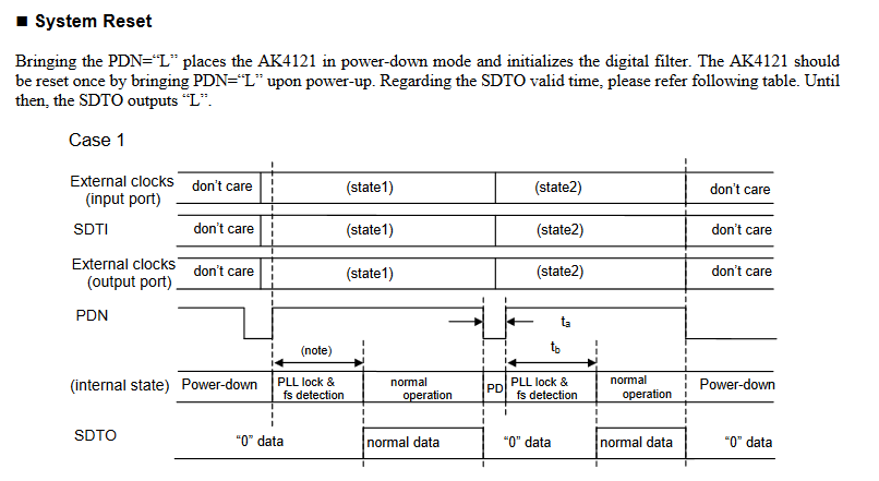

Ok i added reset 5ms and for one moment i can switch between BT (48k) to usb (44.1k) and i saw data..but i can not reproduced it..
It was look like zero data-> reset-> synchro-> normal data, but some reason it not work at 100%...i see lost LRclock when reset, but on datasheet is that reset can be done once after power on..so i cut power and connect to gpio (3,3v), disable power for 500ms, power on, after 300ms make reset for 5ms (second gpio) and put data to ak chip..
I have to investigate it a little bit more😉

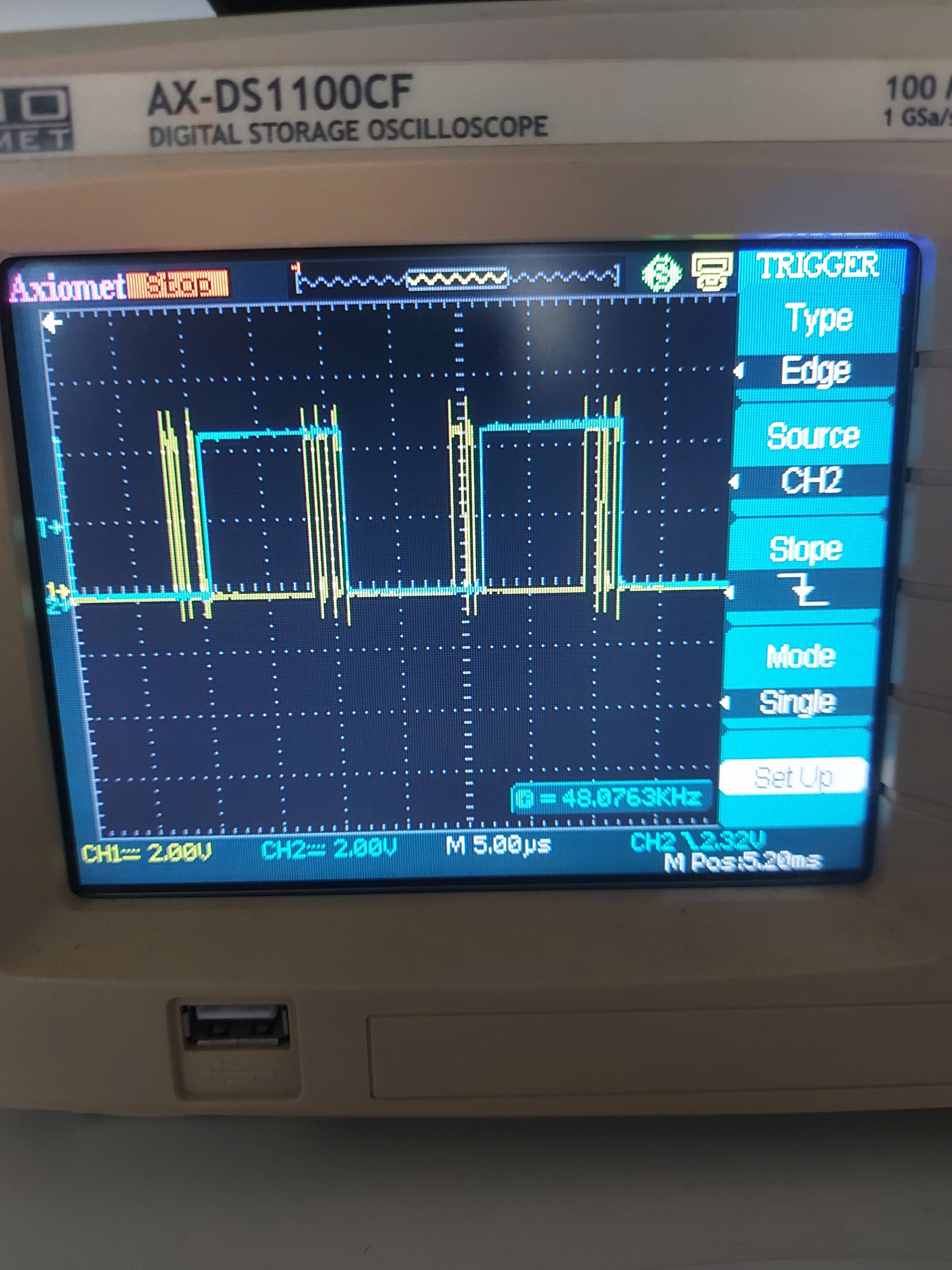

Hmm, the same divide for usb and bt, bt ok, usb can not lock..strange

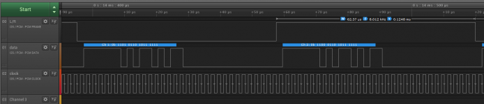

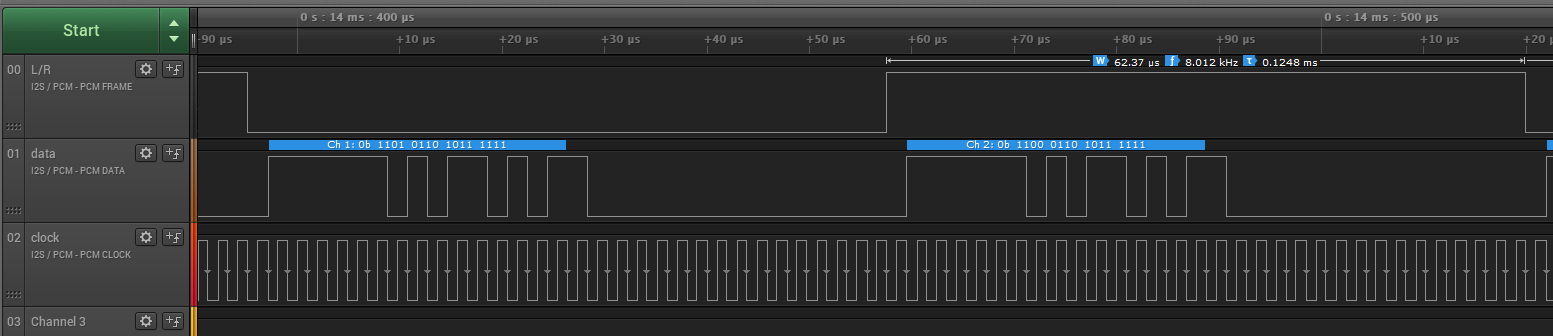

Maybe a good idea to check and make sure bt and usb clock frequencies are the same for BCLK and LRCK. Depending on the number of bits per word, BCLK may have to be different for a given LRCK.
Also, check to make sure bt and usb protocols are the same (I2S, RJ, LJ).
Master is different, 11.29m vs 12.29M, 44.k vs 48k. Looks like i2s for both.
Reset should resample chip, but mayby you have right, format is different..i will try to connect directly to dac.

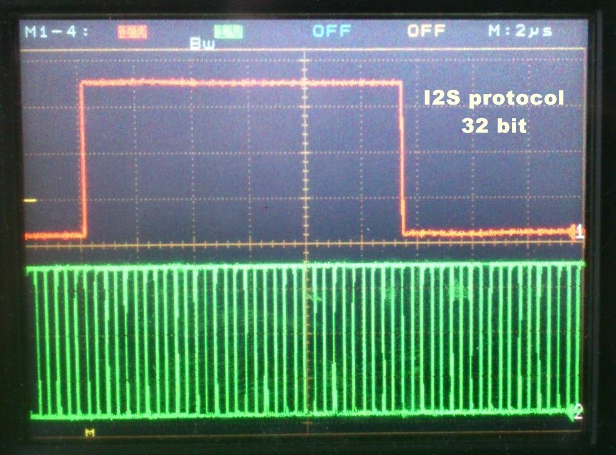

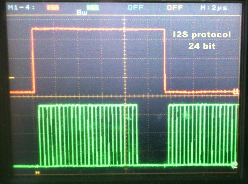

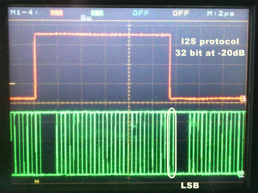

There is a way to see if you have I2S protocol, and how many bits there are, by using an oscilloscope. Using similar methods seems like it should be possible to identify LJ and RJ protocols. Some possibly useful pics attached I found on JL Sounds website, don't recall the exact link unfortunately. Top trace is LRCK, the frame clock. Lower trace is data at the bit clock rate. IIRC its what would be seen with a fixed-level sine-wave test signal.

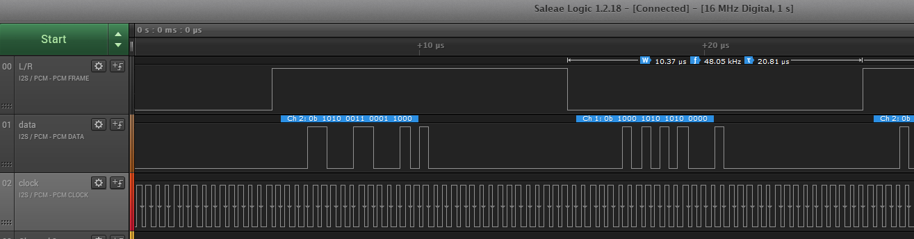

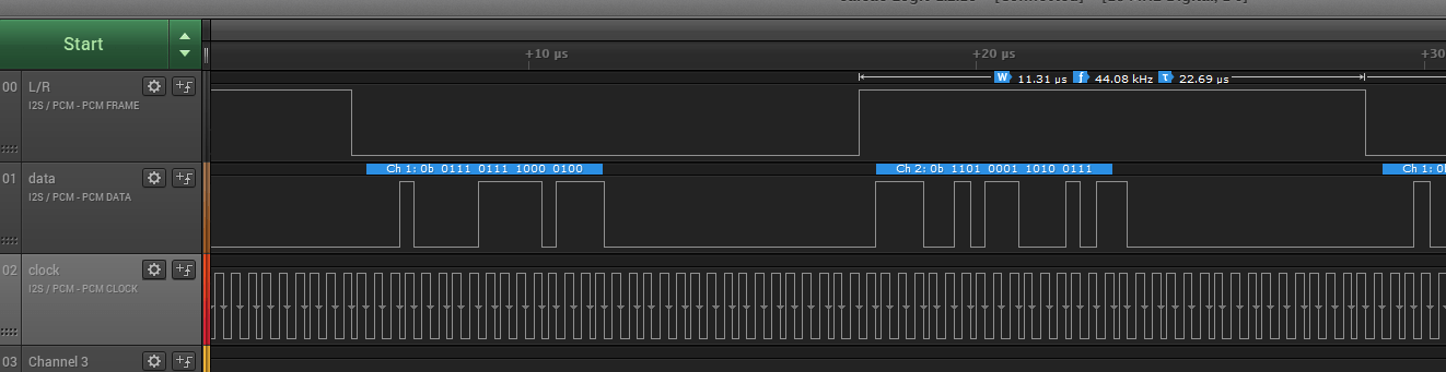

The first pic, bt.png, shows 32-bit words. The top trace appears to be LRCK (left/right clock). When LRCK is high there is the data for one channel, when LRCK is low there is the data for the other channel.
The bit clock, BCLK, shows 32 pulses per channel. All three pics look the same in that regard.
Now, the unanswered question is when in relation to LRCK edges does the data MSB start and the LSB end (for each source device). That's the difference between I2S, LJ, and RJ that we also want to take a look at. For that you will need to play a fixed level square wave, not music. Make a square wave at -20dBFS signal level, and another file with the signal level at 0dBFS. The -20dBFS file will make the more significant data bits all zeros. From that we can see which bit must be the LSB. Then we can see where the LSB is with respect to LRCK edges. The 0dBFS file will tell us how many data bits are actually in use by each source device. Also, we want to capture the bit patters when the square wave is at its peak level, not its edges. A LF square wave will have a longer dwell time at the peaks. We could try to use a rather LF sine wave instead, but we it might be harder to capture its bit pattern at the peaks, where we want to look. That's the idea anyway. Hopefully it will work.

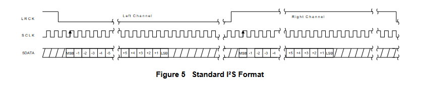

To better understand, AK4121 datasheet, page 10 shows where the MSB to LSB data bits go with respect to LRCK edges. If those diagrams aren't clear I will attach an application note which goes into more detail.
if it is i2s, should be like on screen.
ok i got it"
Therefore, the minimum required Serial Clock frequency is twice the audio sample rate
times the number of bits in each audio word"
so you have right, this is 32bit/channel
ok, i will try with sinus
