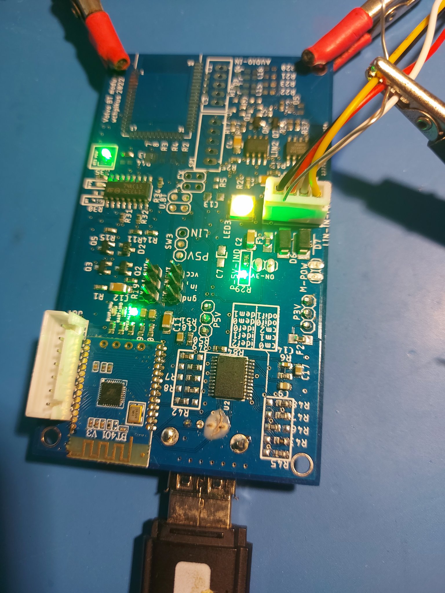

Ok success..
I have to use cs8421 and master clock from bt module.
Now bt, usb, call working well.
Setup do divide 256..
