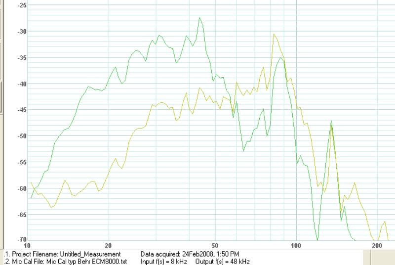

A conventional ported enclosure gives you efficiency between 30Hz and 60Hz. According to measurements and experience, this is exactly where you don't need that much efficiency, at least not for listening to music. Bandpass allows to boost the 60Hz to 120Hz range, which usually becomes quite weak (resulting in rumbly bass with a complete lack of fast "kick"), while still providing cone excursion control between 30Hz and 60Hz.

Ok after a buying frenzy I should have a carrozzeria EQ turning up and a hifonics parametric eq also.. Hopefully one of them should help out.....
Rob.

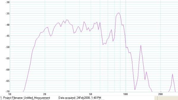

Eva, I've cut the port down, hopefully will measure Sunday.
Rob.
well it sounds like you have it worked out. good job. Eva i have to respectfully disagree, the mids should cover from 80Hz up. I guess that may be asking too much from Robs speakers if they are stock
Your DLS mids should be able to play down to 80Hz no problem. The sub only needs to cover from 80 down. I think using the bandpass to boost the upper bass will make the sub much more noticeable. It won't be omni directional, and unless you have a brick wall filter it'll play up past 80Hz. Sealed may be best, it rolls off at 12db/octave and thats what cabin gain is, netting you a pretty flat response. A 4th order bandpass could be used to physically protect the subs, while retaining a decent amount of flatness.(well I guess it wouldn't have to be flat, but I'd aim for 0dB of passband ripple.)

Sorry, this will result in the usual void between 60Hz and 200Hz. There are too many acoustical phenomena taking place inside cars and neither being modelled by WinISD nor by your brain.
The first wrong assumption is that a 6,5 inch speaker bolted to the door of a car can produce good SPL down to 80Hz.
The second wrong assumption is that 80Hz bandwidth at both upper and lower ends is enough for a 80Hz crossover to sum properly. Even LR24 (24dB/oct Linkwitz-Riley) requires 1.5 octaves of overlap, and LR-12 requires 3 octaves.
But the major mistake is to suggest tuning a bandpass box in the frequency range of maximum cabin gain...
Just got to say Judtoff there's plots earlier on in this thread of sealed subs measured in my car and they are way from flat....
I'm more home audio based so am trying to get my head round the 'tricks' the car audio guys use to deal with the cabin gain problems of the vehicle.
For example I've seen it written loads of time to set a gap in the xo points - ie use a 50Hz low pass on the sub and a 90Hz high pass on the mains. This creates a dip to eq out the cabin gain.

Car acoustics are evil sometimes. Have you tried changing the measurement position? Note that front speakers can provide enough SPL in the 70Hz region to change the way in wich the bandpass box interacts with cabin acoustics.

FWIW I went for a "linkwitz transform" for my car, F3 of the enclosure in the mid 70Hz region and cabin gain doing the rest for me, works better than I could have hoped!
