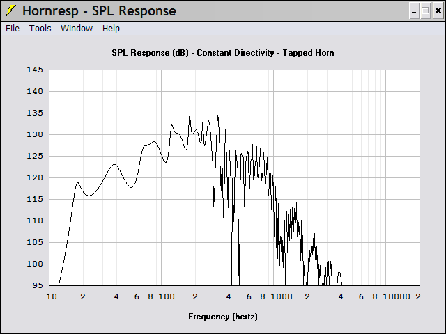

This would work, but at the expense of reduced efficiency.
BTW: Don't trust the sharp peaks predicted by hornresp.

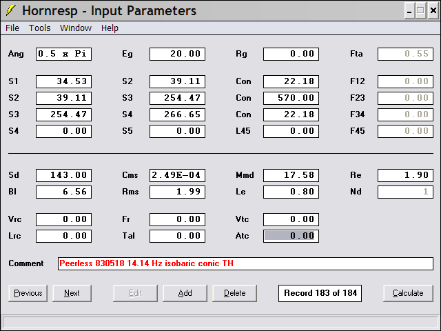

Haven't tried to draw it out, so don't know how much effort it will take to make the drivers fit, but the Peerless in a clamshell isobaric can be tuned low with obvious rising response and a big dip around the cabin gain peak with some much needed gain above it in ~81.33 L plus all the internal baffling. Since isobaric doubles Xmax, the SPL is more than enough if you have a 200 W amp into 2 ohms. The peaking at Fp can be damped if it's obvious/objectionable:

Hi GM,
That peerless horn does look like it would fit the cabin gain well.
I'm going to build a BP with the perfect 12.1's, and also have a look at building that horn aswell.

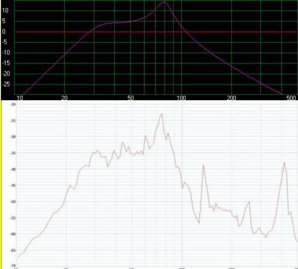

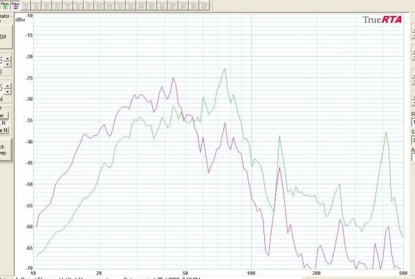

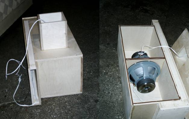

Ok I've finished up on a quick test box for the bandpass box.
Following are ground plane vs winISD model, a couple of pics of the box (yes it's ugly but made from off cuts etc..) and a groundplane vs in car plot. Looks like the huge dip at 60Hz is an acoustic problem, not something eq will fix.🙁 Hopefully my mains will work down to 60Hz or so and fill in the gap.

Be careful because the front chamber becomes easily detuned inside the car. Are you connecting the ports to the cabin? You have to tune it in the final mounting arrangement and it will always ask for a shorter port than expected. Any surface near the front port mouth will reduce Fb and Q drastically.
If both measurements were done with the same scale, then note how higher frequencies become attenuated inside the car. There isn't a dip at 60Hz, it's just that everything becomes 10dB attenuated above 60Hz.
