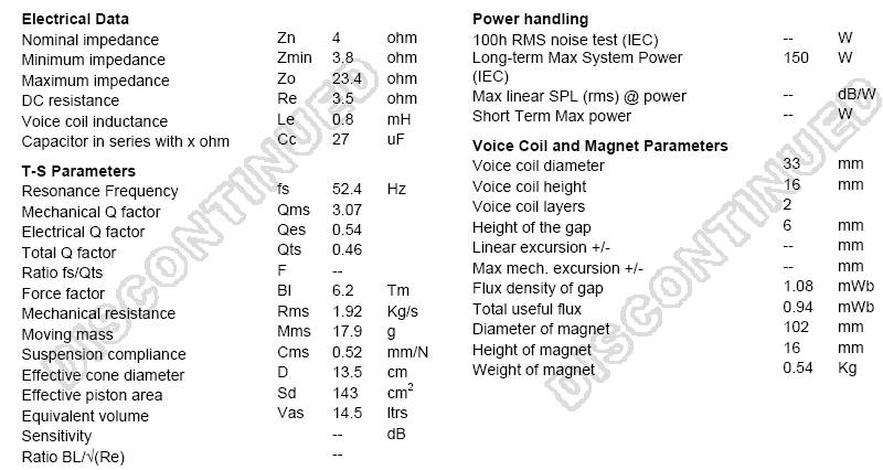

Thanks for the info. One small snag is the basket and magnet of the driver will not fit in that pipe - if its wide enough to fit the 12" in (31cm) then it would need to be 8.5cm high. The driver is 16.5cm high.
What I'm thinking though is that the pipe would be constricted by the driver so I could calculate the area of the driver side on, and then add that much area to the pipe where the basket sits.

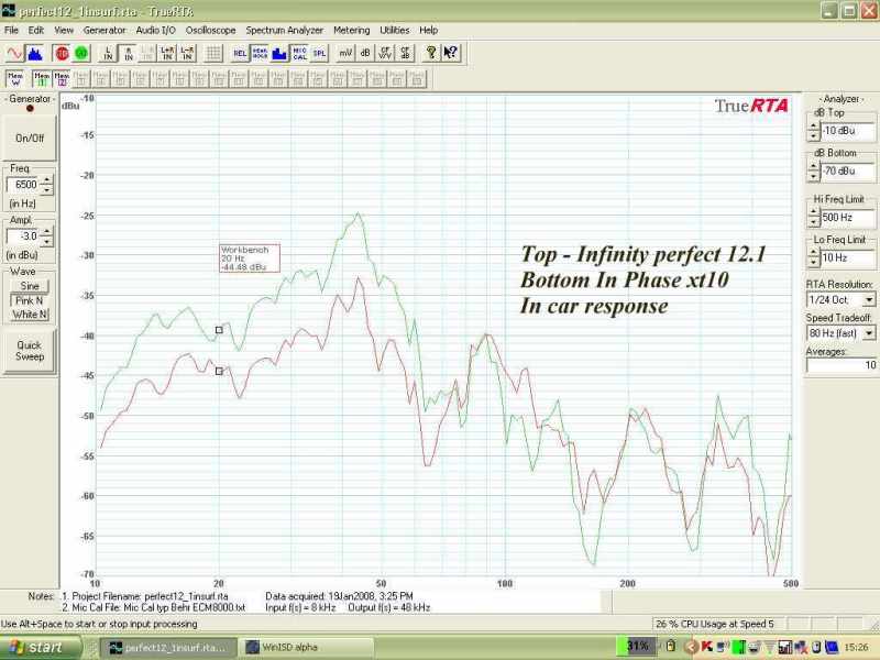

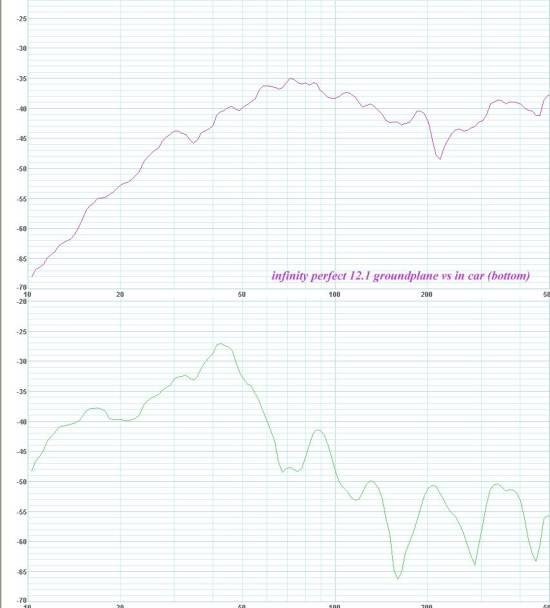

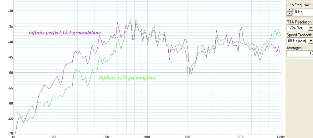

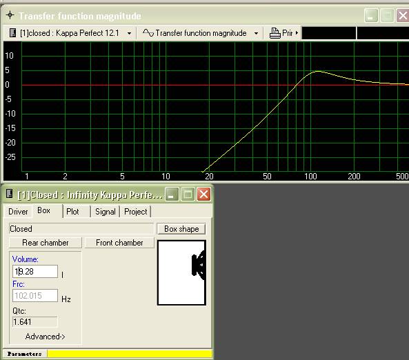

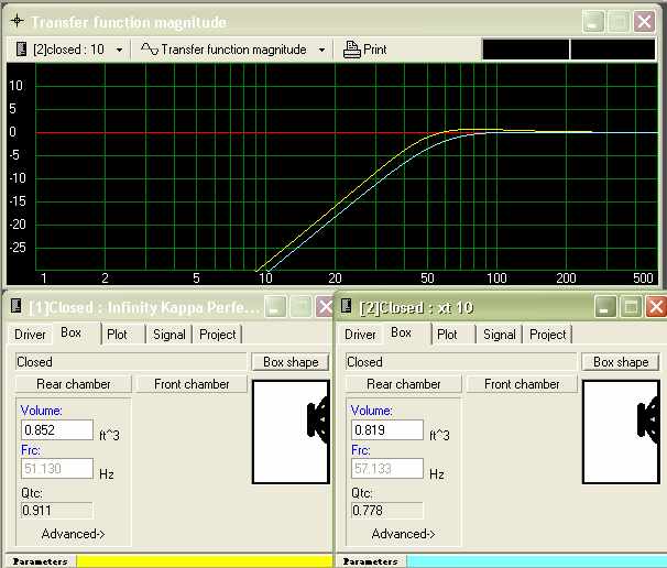

Ok I tested the in car response of the infinity 12.1 in 1 cubic foot enclosure (probably .8 once driver vol removed)
Also tested with my wifes old car sub, a cheapy 10" in a small sealed box.
I couldn't measure them outside as it's been raining all day so the winISD plots will have to suffice for comparison.
There's some interesting modes there, and it seems a need for a flat response from ~40Hz down. The 10" used to measure flat from 80Hz down in my wifes small hatchback.
Rob.

Eva said:
Anyway, be aware that in the car you are going to get a lot of boost in the 40Hz to 60Hz range and very little boost above 80Hz. A flat box tends to sound like a 50Hz resonator inside a car, and personally I find this rumble quite unpleasant.
You hit the nail on the head there Eva
Rob.

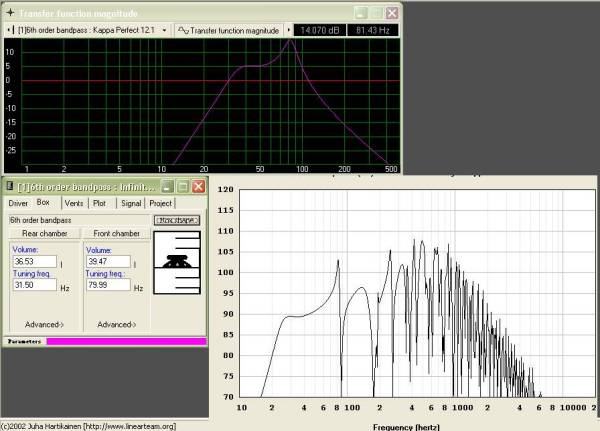

So.....
looking at the cabin gain, I'd need a speaker that is flat from 45Hz down, and from 45Hz rises up to 80Hz or higher by about 18dB, depending on how I interpret the graph.
I've had a go and can muster a rise of around 10dB which should help a lot.

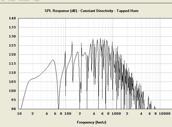

I've had a go at modelling a tapped pipe of similar size with my JBL 2020h driver. It seems to resemble the BP curve. Is there anything wrong with having such a sharp peak on the TP ?
Rob
Rob

Now you understand why I design my bandpass enclosures in such a strange way 😉 Most people think that I'm crazy when they simulate one of my designs and see the tilted SPL plot. The dip around 50Hz due to the distant tuning frequencies is actually quite useful when you get it.
The roll-off below 40Hz happens because the cabin of most cars is not that rigid and leaks the lowest LF to the outer world resulting in not enough gain. You can easily compensate this with a parametric EQ or by applying some treatment to the large frame sheets and panels, but be aware that cabin gain interacts with such a low tuned rear-chamber resulting in more 30Hz port gain than predicted by software. I don't usually aim for much output below 40Hz, it is around 100Hz where most car systems suffer a (depressing) lack of SPL.

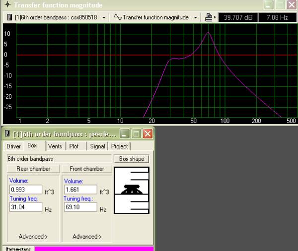

I also own a pair of peerless 6" 850518 drivers which look good in the BP, but I'm not sure if they'd be loud enough? They hit xmax at around 98dB @ 30Hz - if the 10mm xmax is to be believed.
Rob

Thinking out loud here....
What if you make the sealed box so small that it has a sloping response from ~90Hz down. Then add a bit of bass boost at 35 - 40Hz to flatten the response below 45Hz. ??
Takes up less room than all other options, even if it means buying 2 more subs....
plot done with 4 perfect 12.1's (should have enough displacement for a bit of eq)
If space is an issue and the driver/amp can handle the boost without excessive distortion, then why not? Otherwise, I prefer to design for all the acoustic efficiency I can get and attenuate as required since distortion goes down, not up.
