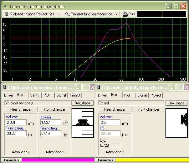

The pic below shows 2x infinity perfects sealed against 2 isobaric loaded in a BP.

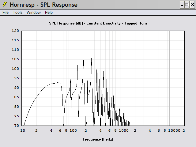

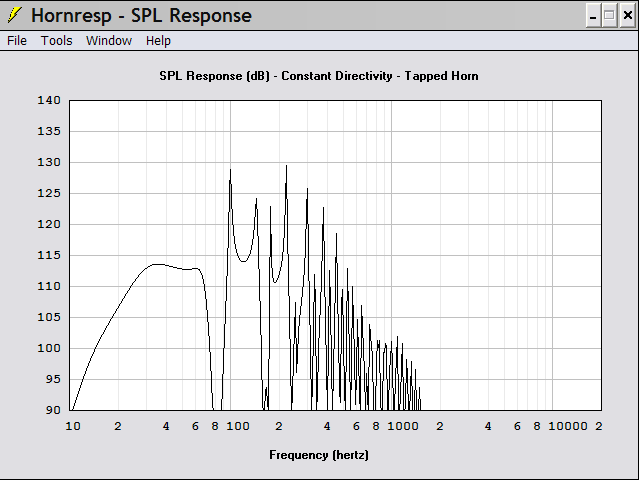

Greets!
Since a tapped pipe is a 6th order BP, I figured a single driver in ~the same size cab as your isobaric BP (~113.5 L) would perform adequately in a vehicle even without the second driver's extra Xmax/power requirements, especially after cabin gain is factored in. Anyway, this one at 35 V (306.25 W) doesn't reach Xmax in half space till ~16 Hz, so even with the windows down it can in theory make you deaf over time if you choose and you have a spare driver in case you break one.
GM
GM

So it would seem. 😉 FYI, the tapped pipe I posted has plenty of Xmax available to EQ its ~flat response to a rising one without losing any of its bottom end output potential, so at normal levels it will require little power compared to a typical car audio BP. Anyway, nice designs, you obviously put a lot of effort in them.
GM
GM

That looks like a good tapped horn GM - I have the driver inserted into hornresp but did not achieve anything like that.
EQ becomes a bit more complicated in a simple car setup, but I can use my ultradrive for test purposes.
Rob.

You attempted to use the tuning frequencies that I recommended with a too small rear chamber and a too big front one. Try to play a bit with the chamber volumes and see if you can get a better response (but some drivers just don't allow to tune the box that way).
Anyway, be aware that in the car you are going to get a lot of boost in the 40Hz to 60Hz range and very little boost above 80Hz. A flat box tends to sound like a 50Hz resonator inside a car, and personally I find this rumble quite unpleasant.
On the other hand, a 6th-order bandpass with tilted down response and some clean output up to 150Hz integrates very well with front speakers. Remember that even 24dB/oct LR crossovers require over one octave of overlap (and phase matching has to be considered too). If you use a wide front port and place it in front of the driver, the frequency response above port resonance will not fall as predicted by software, and phase will not rotate as dramatically.
Hi Eva,
Increasing the rear chamber and decreasing the front chamber just makes the curve more like a camels humps. I lose the 10 dB rise of the top tuning and the curve just looks worse. What you're saying actually makes the curve flatter rather than having a slope ?
Maybe the drivers just don't work in a BP.
I think I'll measure the cabin gain in the car before I continue.

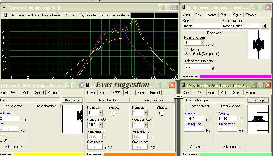

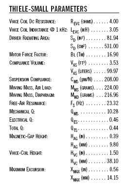

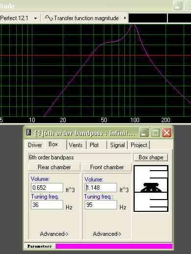

Your driver is difficult due to the high Qts. Drivers with a Qts around 0.3 are much easier.
This is more or less how I would do it... The sealed box plots are included for reference.
Frequency response:
Cone excursion:
Parameters:
In the 6th order bandpass, rear chamber Q is 3 and front chamber Q is 7. A Q of 3 is easily achieved by placing the vent near one corner of the box. Power for cone excursion is 100W in both cases, note the big difference in favour of the bandpass despite the increased output at all useable frequencies. In practice, inside a car, +/-5mm are enough for 500W or so (a long excursion driver is neither required nor desirable).
The frequency response is intentionally shaped to be 12dB down at 30Hz with respect to 60Hz, since cabin gain will tend to exert the opposite effect.

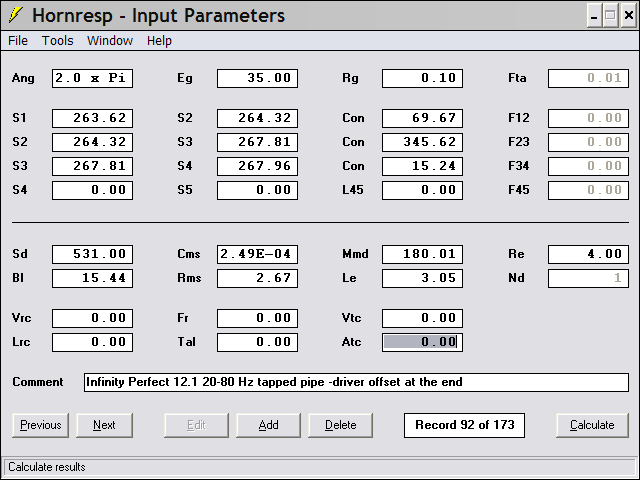

GM, can I be cheeky and ask for a shot of the input screen of hornresp ? I work with ply all day so it's easy to knock up simple test boxes but the tapped horn stuff just doesn't come easy to me. I'm just getting used to the basics of FLH's and then along comes the tapped horns and I'm having trouble keeping up😱
Rob.

OK Eva I'll definitely build the version you've suggested there and post measurements here.
I'd also like to have a go at the tapped horn version from GM.
Would be an interesting comparison.
I promise to build and measure them both btw - am not just dreaming here.
Rob.

Sure! Which one? I decided to quit wasting time/BW posting the input screen until needed since nothing much is getting built. Again though, it's just a tapped pipe, not horn since it wouldn't fit in ~113-114 L to match your box design.
GM
