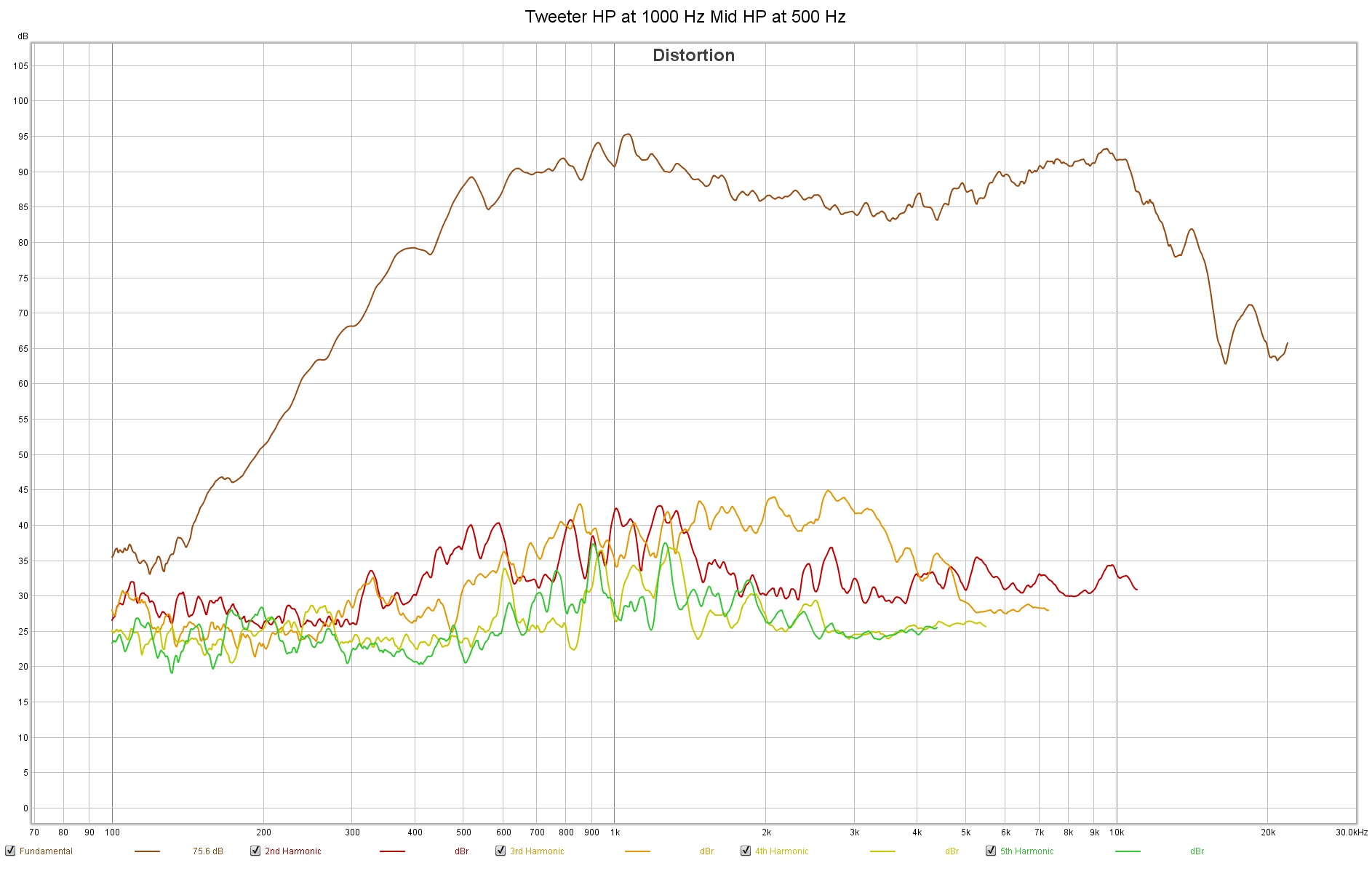

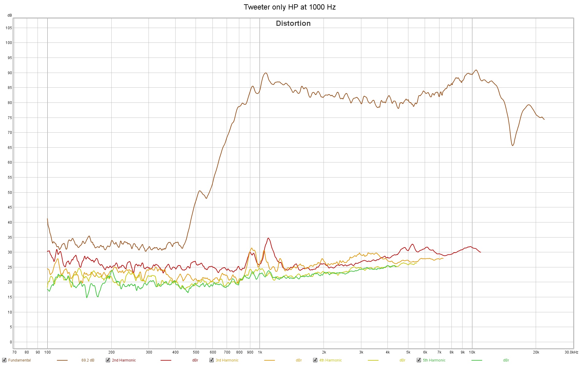

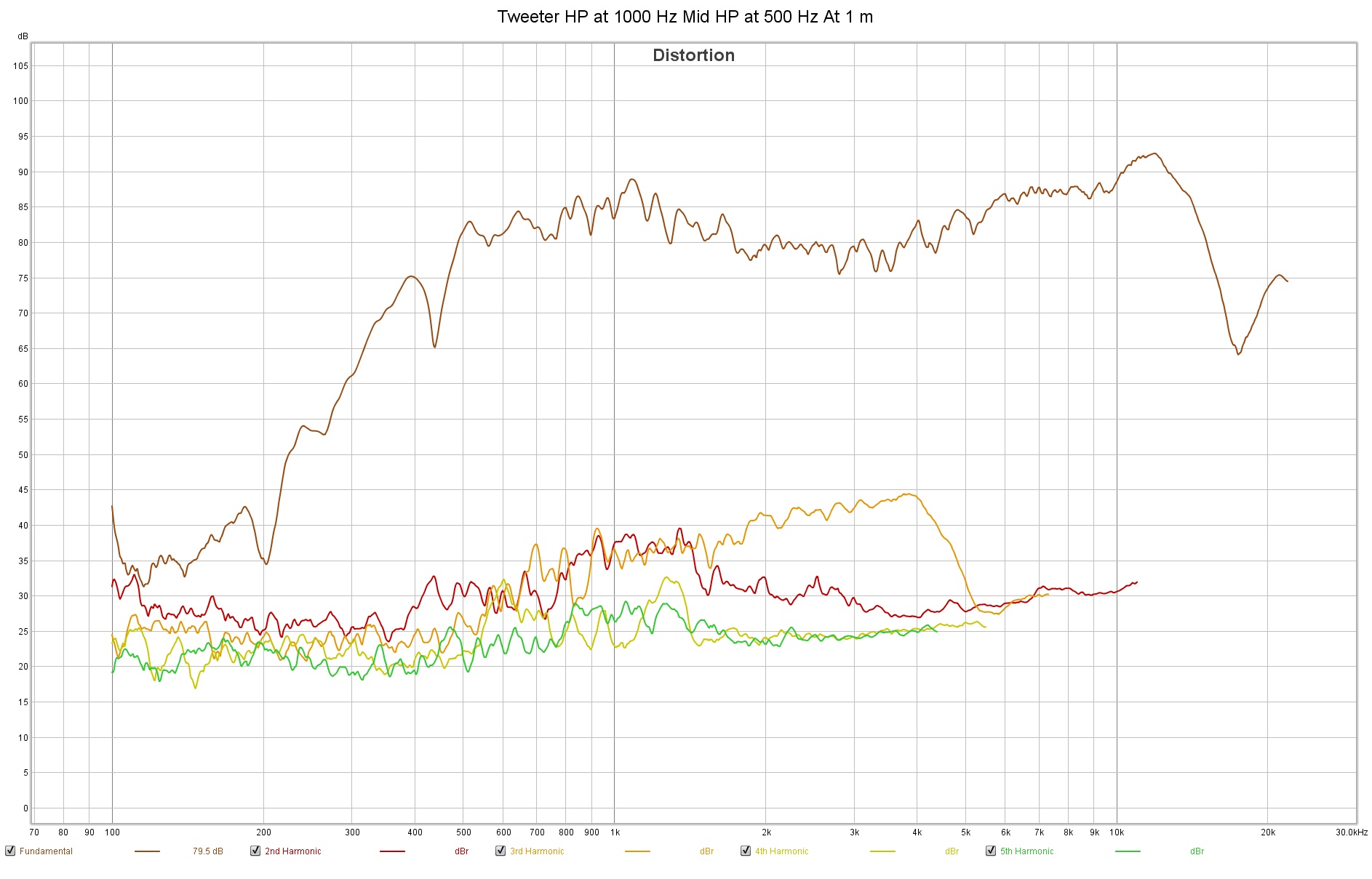

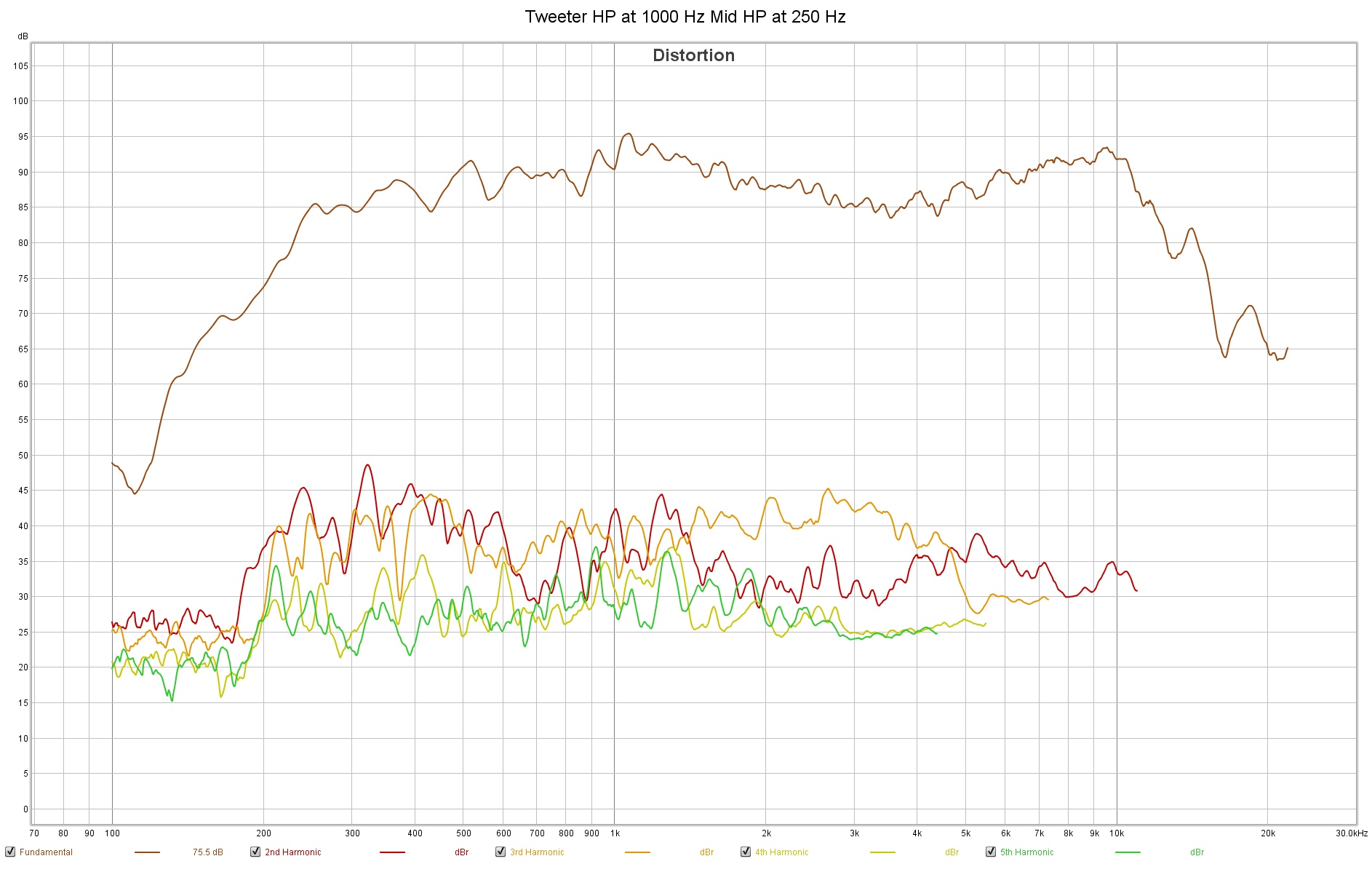

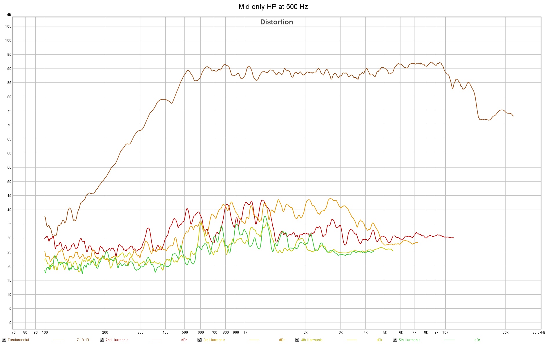

Some first measurements then at approximately 1 W.
Only two membranes and no back pole pieces.
So the SPL at 1W 1 meter is a little bit low and the distortion is a little bit high.
But I reckon that the back pole pieces will add 3 to 6 dB and they will also lower the distortion levels.
Doubling the amount of membranes twice will also add at least 6 dB.
So I guess it'll be above 95 dB in sensitivity at 1 meter for the full SALS?A!
Frequency response slopes down above 15 kHz and are more or less the same for both mid and tweeter.
I don't know how much the narrower back pole piece for the tweeter section will help.
