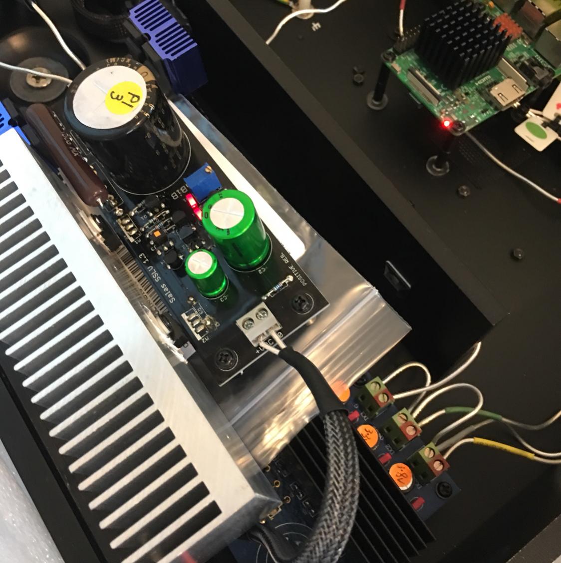

I finally got it working for my pi3!
Salas ultraBiB is used for the first stage regulation: output is 8Vdc.
Second regulation is a LT1963 low noise reg to split into 3 voltages: 5V, 3.3V & 1.8V for pi3.
I replaced M1 with IRF9630 as suggested by Salas; I also replaced the R1 with a 0.15 Ω resistor. Transformer is 50VA, 2x9Vac secondary winding.
Improvement? Definitely yes!
Before, LT3045 reg was used in the first regulation stage and it was already a wonderful improvement over the wall-wart.
With UltraBiB, the dynamic and soundstage and everything gets audibly better. Full of energy for rock songs and powerful enough for big performance. Background is very silent now.
I am very happy with it!

Almost 4 Ampere constant current setting! Now that's some real dedication to run the Raspberry Pi 3 computer from a shunt regulator

That 50VA traffo must be having a pretty bad time, though.. 😛
Probably running both 9V secondaries in parallel?
yes, 2x9Vac connected in parallel 😀

Hello Salas, I've recently been using one of your shunts to power my AK4495 DAC. However on switch-on I am getting switch on spikes of a few volts higher than the set voltage, before coming down.
I'm running it at 5V, but with the standard 220uF reference cap, it spikes up to 7.9V. Adding an extra 470uf in parallel, it now spikes at 7.0V, which is safe. I changed the 0r33 resistor on the input to 10V, but that didn't help.
The regulator sounds great - better than the Paul Hynes shunt that it replaced - so it's obviously working well. The LEDs are at normal brightness, so reference current looks normal. Any ideas what I should check?

It normally tests softly without an over voltage peak on single event capture mode when the digital scope is set to very slow. So that's an odd occurrence. Does it do it on a resistor dummy load as well? Can you verify? Trying to firstly understand if it's a malfunction or a momentary oscillation with a particular client circuit. So to analyze for helpful ideas.
It behaves the same with or without load.
I did find I had 270R in R9 - just changed it to 680R (the closest higher value I had) and while the spike is still there, the voltage does ramp up more slowly, up to about 3V, then rises sharply to 7V before dropping down to 5V.
Is it worth going to 1K for R9?
