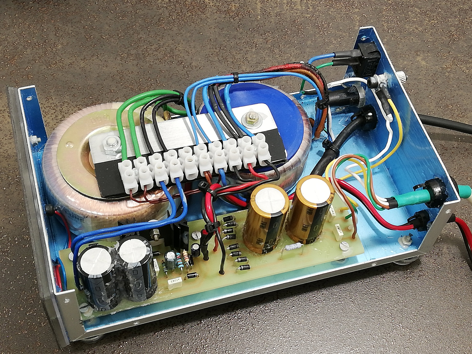

My project
The first thing Salas is to thank you for this great project that you have shared with us 🙂.
I also wanted to show you some pictures of how I did it.

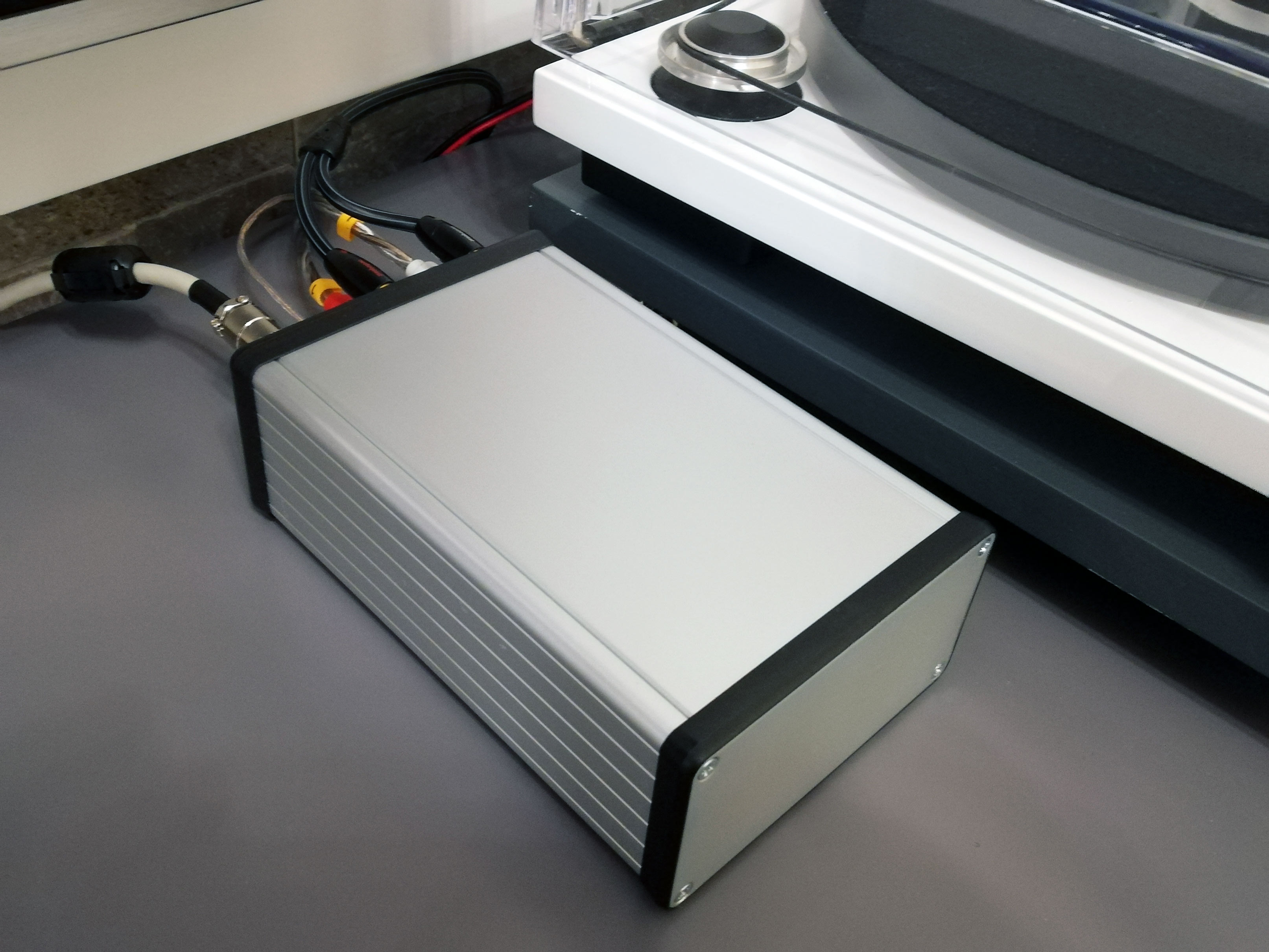

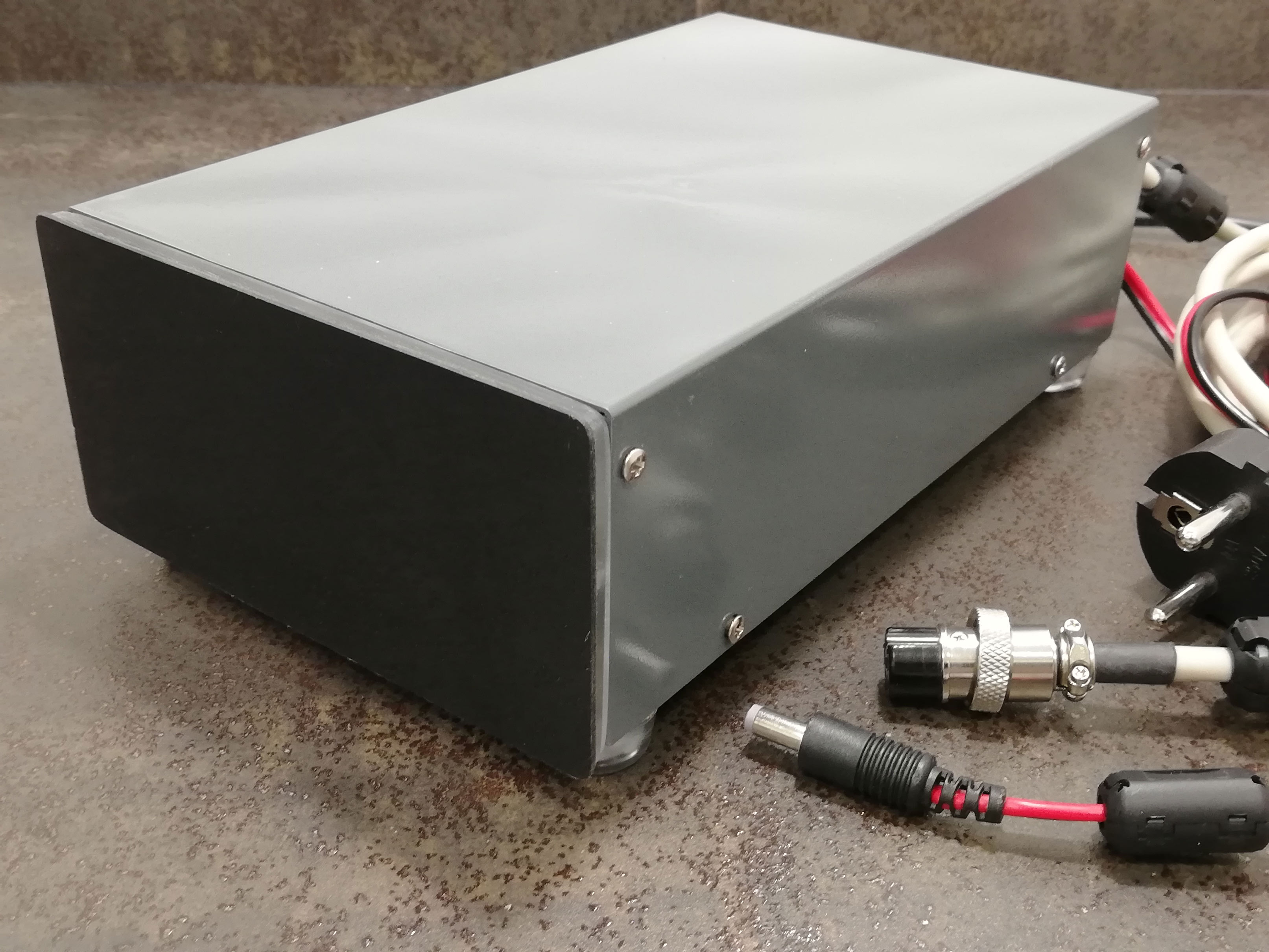

The purpose of the power supply is to feed a preamplifier with RIAA correction for a turntable.I have not used the original PCB and I have designed a custom for the box and that also contains the preamplifier.
The transformers and rectifiers I have mounted in another separate box and physically separated from the one that contains the preamplifier. I also include the turntable motor power supply.
Any criticism or observation will be welcomed
Fully handmade DIY is always nice to see. Does it work well as a whole without noises and giving a good sound? If yes, its a success.

Thanks Salas.Fully handmade DIY is always nice to see. Does it work well as a whole without noises and giving a good sound? If yes, its a success.
This RIAA preamplifier is connected to an 80 + 80W Exposure amplifier. It does not have the slightest hum.
Only at the top of the volume is heard a shhhh that is appreciated by bringing the ear to the speakers. I attribute it to the opamps that I use, an OPA2134.
It's possible?.
As for the sound, it seems extraordinary to me, but I do not have to compare it
Hiss noise level to stay satisfactory low when with the 8nVrtHz JFET input OPA2134 depends on a. Phono gain to be moderate b. Cartridge impedance to be high c. Total system voltage gain to be moderate d. Speakers sensitivity to be moderate
a & b are pointing to MM cartridge type is better for use with that chip.
So yes, that little hiss is due to the chip. In your case very well controlled while no other noises like hum & buzz are present.
