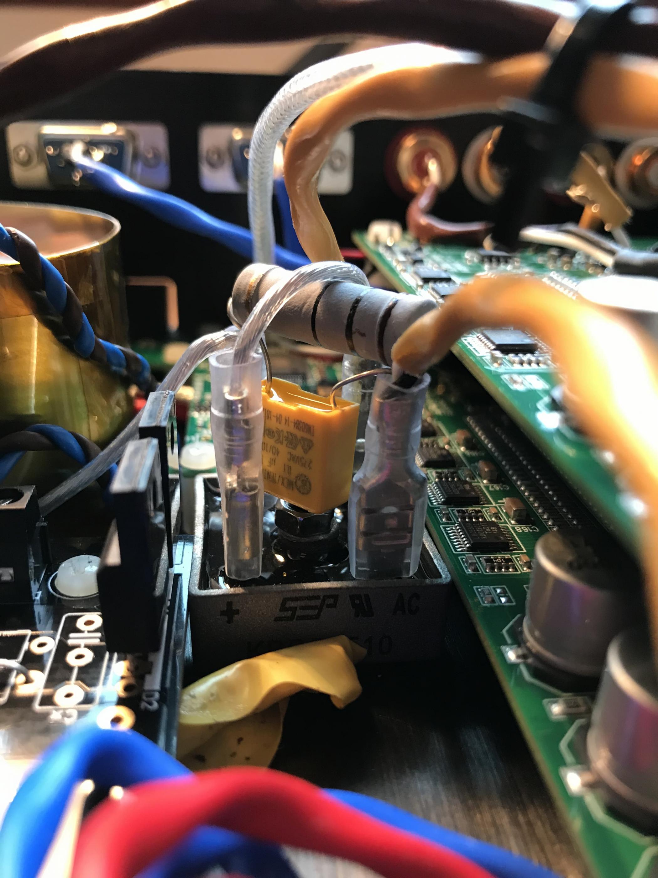

Just finished a couple of major repairs... Don't forget to connect the GND on Amanero to ISO GND, even if you connected a power source GND to it already. Otherwise you'll be scratching your head at random clicks for a very long time. Also completed the ground loop breaker circuit. Unnecessary but just might be useful when connected to some other device in the future.:D
