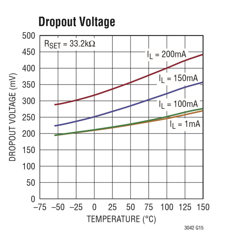

That's crazy, thanks so much for the calculations!... I admit I was a bit confused why a linear regulator has quite significant voltage drift but this totally clears things up. And I was totally incapable of actually substituting your formula with all the right things.... Also 10C is definitely conservative here. 20 is probably closer to reality.
Btw, I was curious and checked out the LT3042 datasheet. Does this graph mean that it has a smaller temp drift?
For say an actual 15C delta (locally on Q2 Q3 and LED1 LED2) the practical result would have been even closer with calculations.
That LT3042 graph is about its drop out voltage. Like the hotter it runs the more Vin-Vout difference it needs to stay in regulation. Such chips have compensated internal CCS for driving their external Vref setting resistor so don't expect any thermal settling for Vout to tell home about. Chips have the luxury of mutually compensating many internal parts in a well controlled super mini and enclosed surface. Those LT actually use the CCS and I/V on resistor Norton Vref principle for unity gain low noise Vref as the BiBs always used to have 🙂
