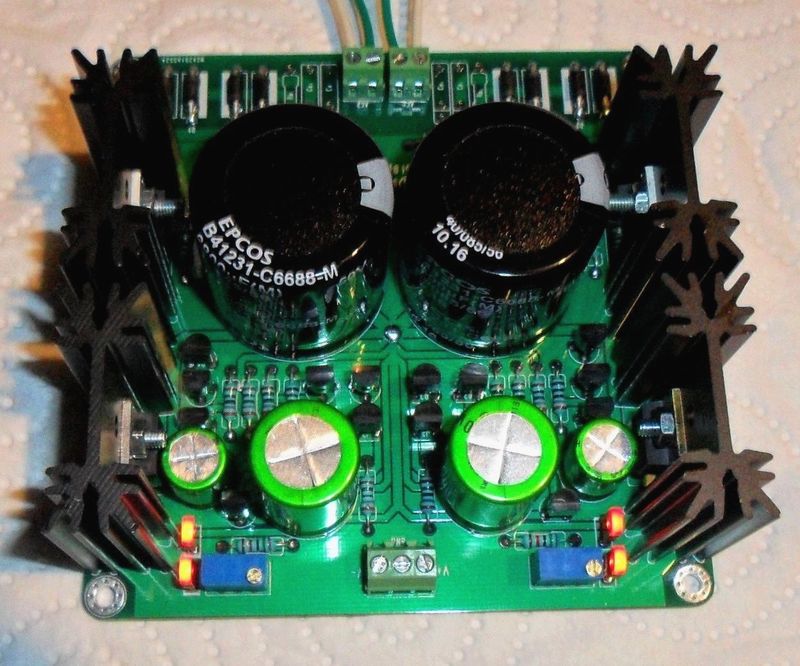

Board is set to give 13v.,adjusting trimmer VR1 together with wrr, around 3k3, but no way can't reach anything higher than 7v. output.
No load and off, probe from Vout to 0v.:
Healthy reading is climbing like a capacitor till infinite (no reading).
Damaged board reading also climbs, but slower and locked to around 5k. Ohm.
Now i see C2 220uf reversed on defective board, but always thought thouse Nichicon BP are non polar.
It's worth to switch?
So some part must have been compromised. Should show hundreds kOhm and then climb. Flux is well cleaned around M1,M2 gate pins?
Now i see C2 220uf reversed on defective board, but always thought thouse Nichicon BP are non polar. It's worth to switch?
BP are both ways positioning caps. But there could be some dodgy one or got overheated in soldering, became leaky and loses the Vref that its there to filter? Because we are in the twilight zone of failure scenarios now, if you will try change M2, change C2 also, even with Panasonic polar to see what happens.
Hi Salas, you got here when mentioned cleaning flux. Now is fixed the board, a relief, altrough it was clean loocking I reclean but this time with a lot of alcohol, almost submerged, trying to fill inside terminal blocks, etc.. and it works!
I use high silver content solder, which need extra amount of flux and temperature to ensure proper joint. And althrough I always clean right after, for sure not enough below or inside some places. Never is enough advice againts conductivity of solder paste. I feel very grateful and sorry the long.
Lessons learned:
- When weird things happen, do open output impedance checks also, as in post #740. If readings are low, probably something leaks.
It may be conductive flux residue. Use 0.5mm lead solder wire with internal flux if possible, don't add flux externally in places not strictly necessary, and clean well.
- Mosfets have very high impedance gates, this one is a high open loop gain and wide bandwidth circuit that may get compromised from leftover flux or dirt and puzzle you.

Just like JOIMONF, I had my fair share of challenges building 2 pairs of UltraBiB for the DCG3. I had mounted the MOSFETs to the preamp chassis by drilling holes. As I did not drill the holes accurately, I had to make them bigger to compensate for the imperfection alignment.
I proceeded to adjust the VR1 to +/-17V before I connect it to the DCG3. I had to tie the 2 zero outs together and that was when the LED went off. This only happens to one of the 2 sets. So I have one working and the other, not.
Salas gave me some ideas to investigate, e.g. incorrect part placement, swapping the M1/M2. This was when I realized that despite using the SIL-PAD 900 insulation pads, the MOSFET tabs had electrical continuity to the chassis. I had used plastic screws and nuts. In fact, 6 out of 8 of them had this issue.
After much investigation, I found that because I had drilled bigger mounting holes and over tightening of the MOSFETs to the chassis, it has caused the metal tabs to touch the chassis.
I have addressed them and now have a working dual mono DCG3 preamp.

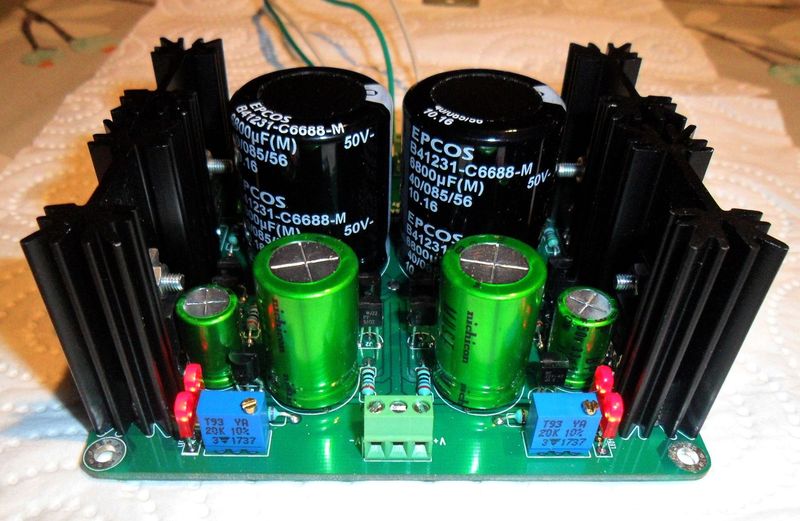

Hello everyone
For my special needs I drew a layout of this regulator and adjusted to 200mA and +/- 15V. The operation is perfect but the small heatsinks deserve to be higher because they are relatively hot but it goes anyway.

Congratulations and let us know how you gonna like it. Did you also check its oscillation free by examining the rails with the scope?
P.S. Nichicon ES is 85C type. Better use 105C C3 because you located it next to M2 so it will be receiving more radiated heat than in the regular board. Unless you measure manageable temperature on its body for your application. Every 10C less than rated, electrolytics stated lifetime doubles.
