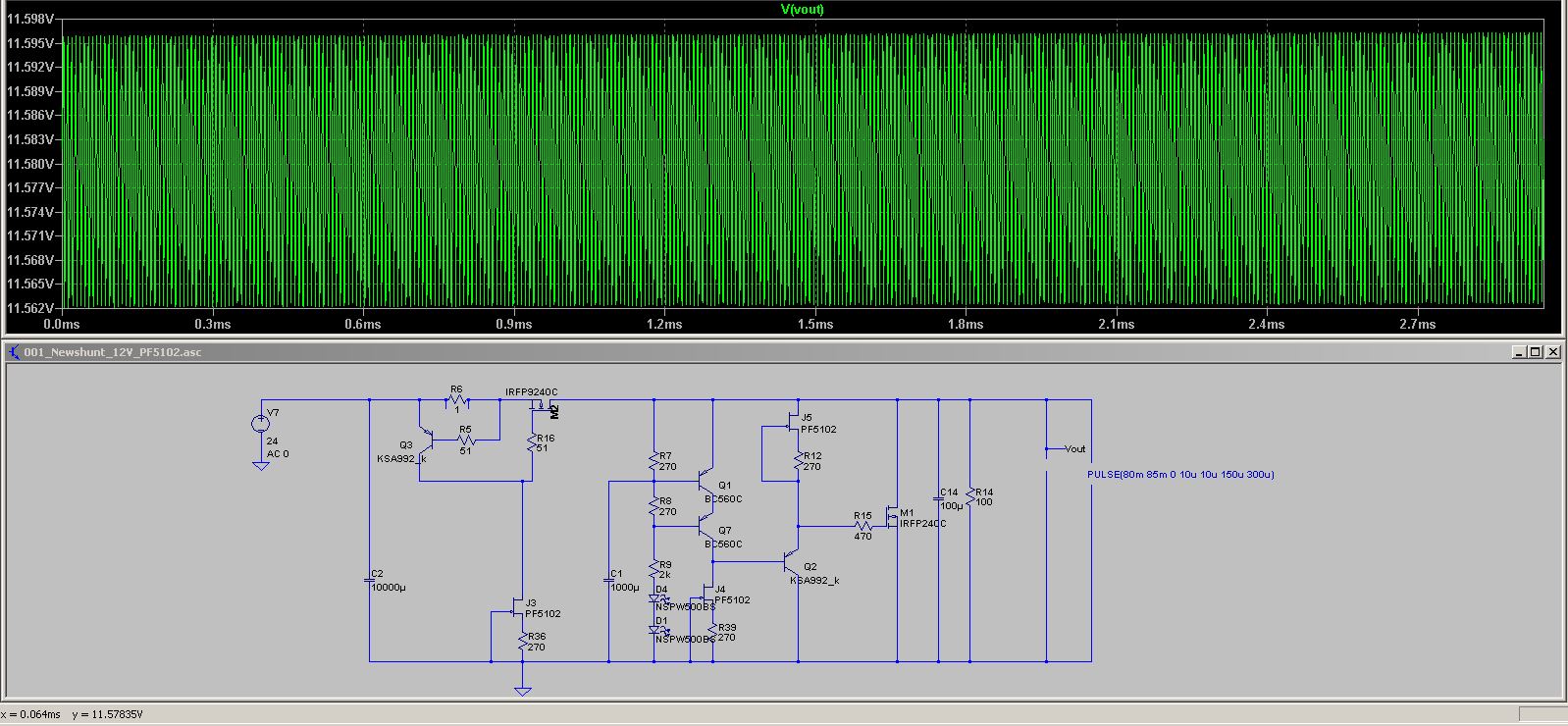

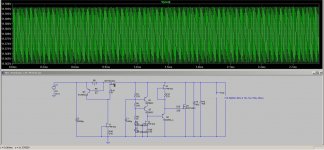

Hi salas, I was curious about the simulation and its stability and when I did the same simulation as per the first post and what I found is oscillation at any value. Infact I have got all the same models instead of substitutes. Im curious that if anything to be corrected in the schematic or is the reg stable as is? If its stable then why is it oscillating for any resistor value ( consider increasing the gate resistors ) its not getting stabilized.

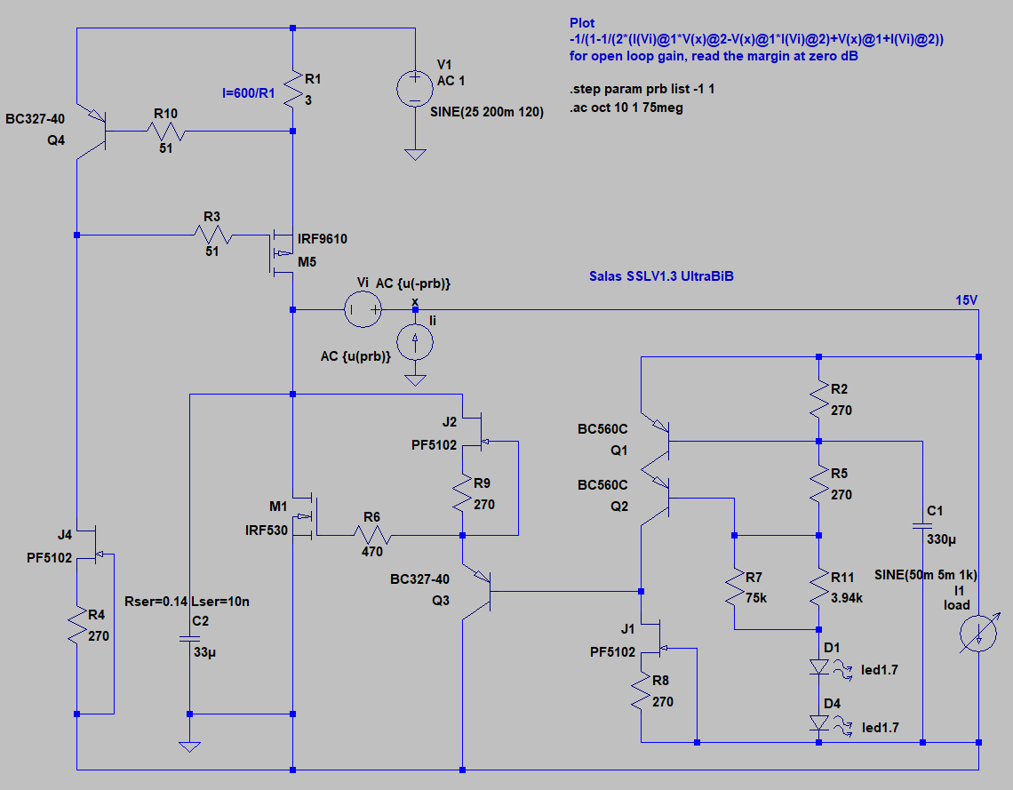

Fact is it doesn't oscillate because its in use by people and works fine. It does not oscillate in my simulation either. Its calculated for 60 degrees phase margin at 100mA spare. There is the open loop gain curve in post#1 with cross hairs at zero dB showing that. Must be some wrong models you use. The BJTs & MOSFETs I see in your schematic are different types. Don't forget to add the recommended ESR in your simulated output capacitor too.
Thank you for the reply salas so I have a question that what if top stop the oscillation in the simulation? do i need to add 100uF between the base of Q2 and ground? ( But can we do this in reality? like to reduce the oscillations if occurs ? using 100uF wouldn`t that degrade the performance of the reg?Fact is it doesn't oscillate because its in use by people and works fine. It does not oscillate in my simulation either. Its calculated for 60 degrees phase margin at 100mA spare. There is the open loop gain curve in post#1 with cross hairs at zero dB showing that. Must be some wrong models you use. The BJTs & MOSFETs I see in your schematic are different types. Don't forget to add the recommended ESR in your simulated output capacitor too.
I have used the same transistors as you have used in the simulation. May be the model source might be different. I have got the models from diyamp.txt and kt cordell models and some Jfet libs available online.
If you have a working schematic and models can you share it.

My LTspice .asc is linked to my computer's customized libraries so it will not run self standing on other computers. I give you the models I used while the 327-40s are internal LTspice ones you can call up just by picking or stating them. Don't pay attention to the designations vs the PCB schematic like which one is M1 Q1 etc. they are random here.

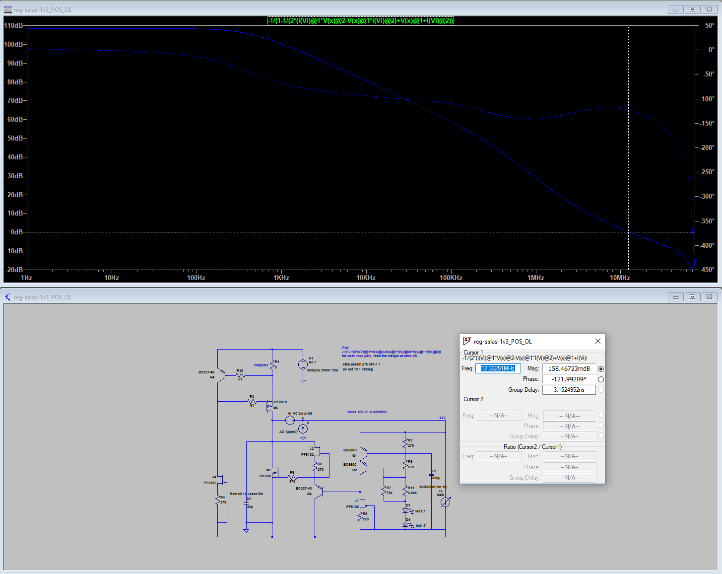

Copy the simulation schematic, draw it to your LTspice by also adding all the voltage & current sources you see, write the exact spice black commands and values. Don't forget the ESR and ESL you see in the 33uF cap. The Vi Ii {} statements are for AC Amplitude in the small signal entry area for sources, x is a label net. Run AC analysis as written and right click on its window to add trace -1/(1-1/(2*(I(Vi)@1*V(x)@2-V(x)@1*I(Vi)@2)+V(x)@1+I(Vi)@2))
You should see the second pic's phase result at 0dB gain when with 3Ω CC resistor (200mA CC leaves 150mA shunt current after 50mA output load). This result when subtracted from -180 degrees gives the phase margin. The 25V input source has 200mV 120Hz added ripple also in case you will go looking for PSRR.
Finally, when you simply run .op (DC analysis) you will see a straight 15V green line at the output, nothing like the green fuzz in your picture.
