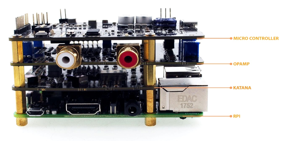

I'm still waiting for the propotype board that supply +-15VDC 1,5A for Katana Opamp board. Pls give me some notes of chosing parts beside your guide document in first page.

1.5A for an op-amp board (?) sounds much excessive. Even when discrete and when there is a controller. What is its real mA consumption for the +/-15V rails, can you measure? You wouldn't want to set the CC way high with R1 for no reason because there will be much heat and possible stability problems.

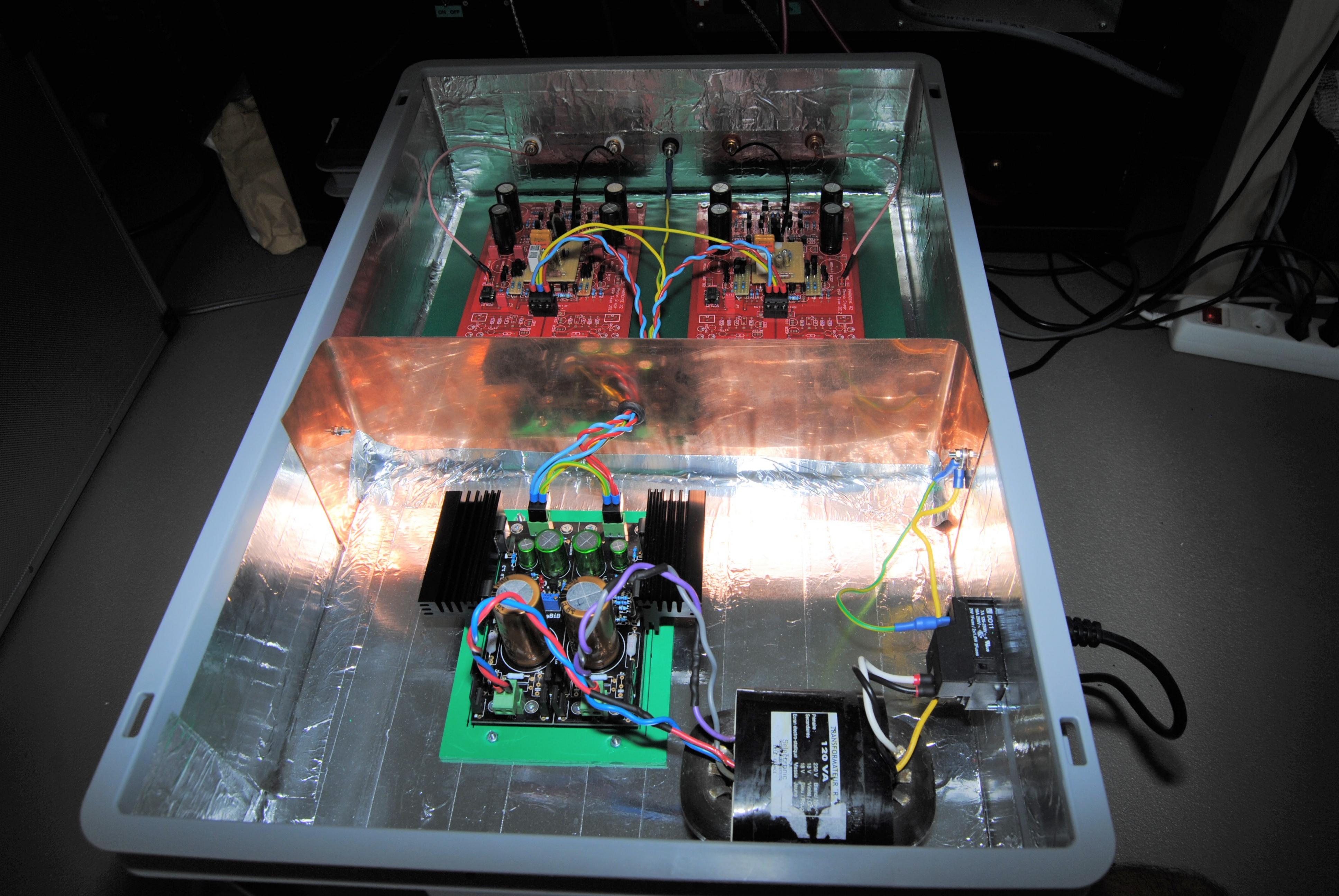

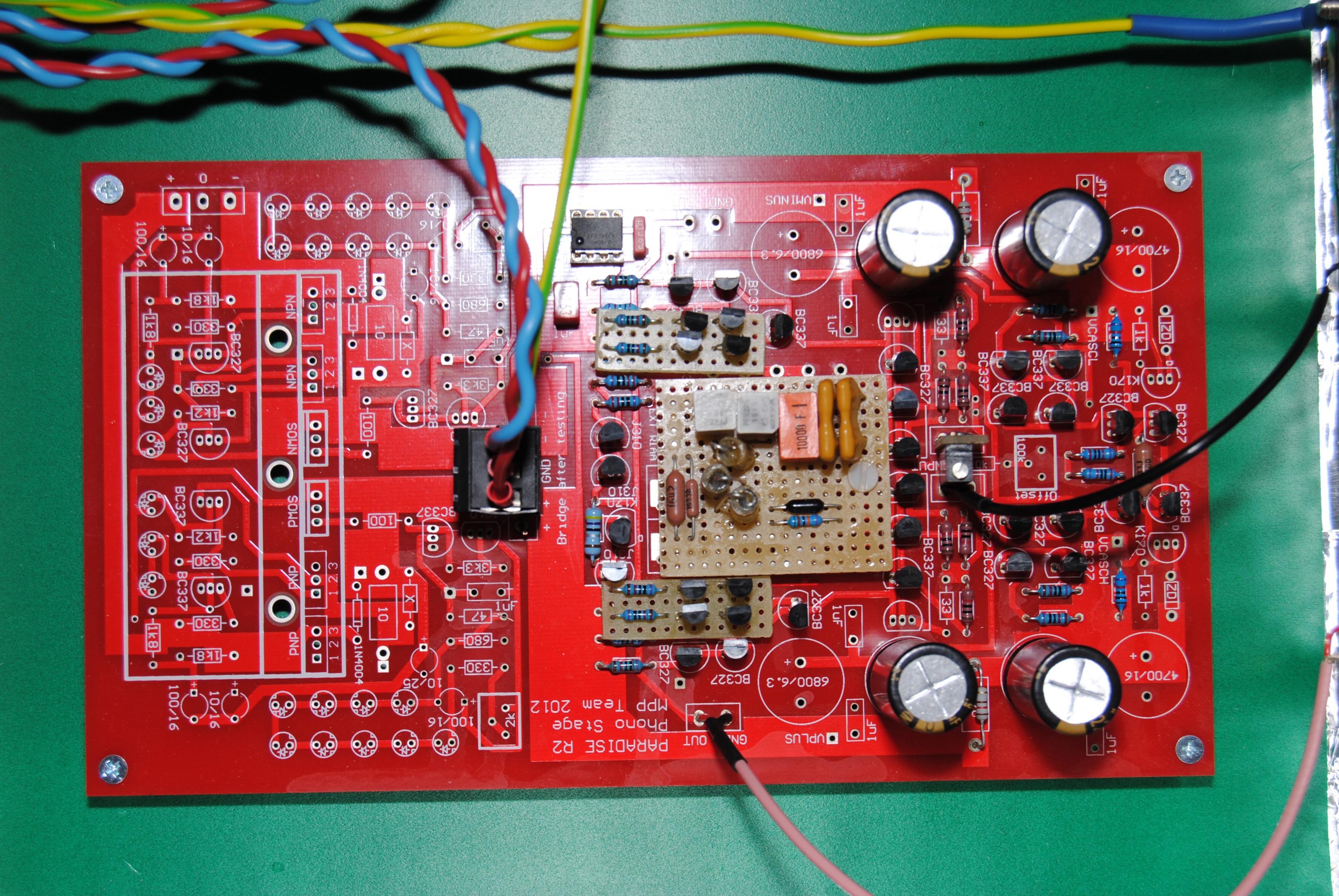

Finally finished second board and wiring so now I can listen to my new rig.
I modified a paradise board so inputs are now jfet and no need for ips current nulling.
jfet ips has less gain so I modded the main mirror so it now has gain.
Result is 63dB at 1khz

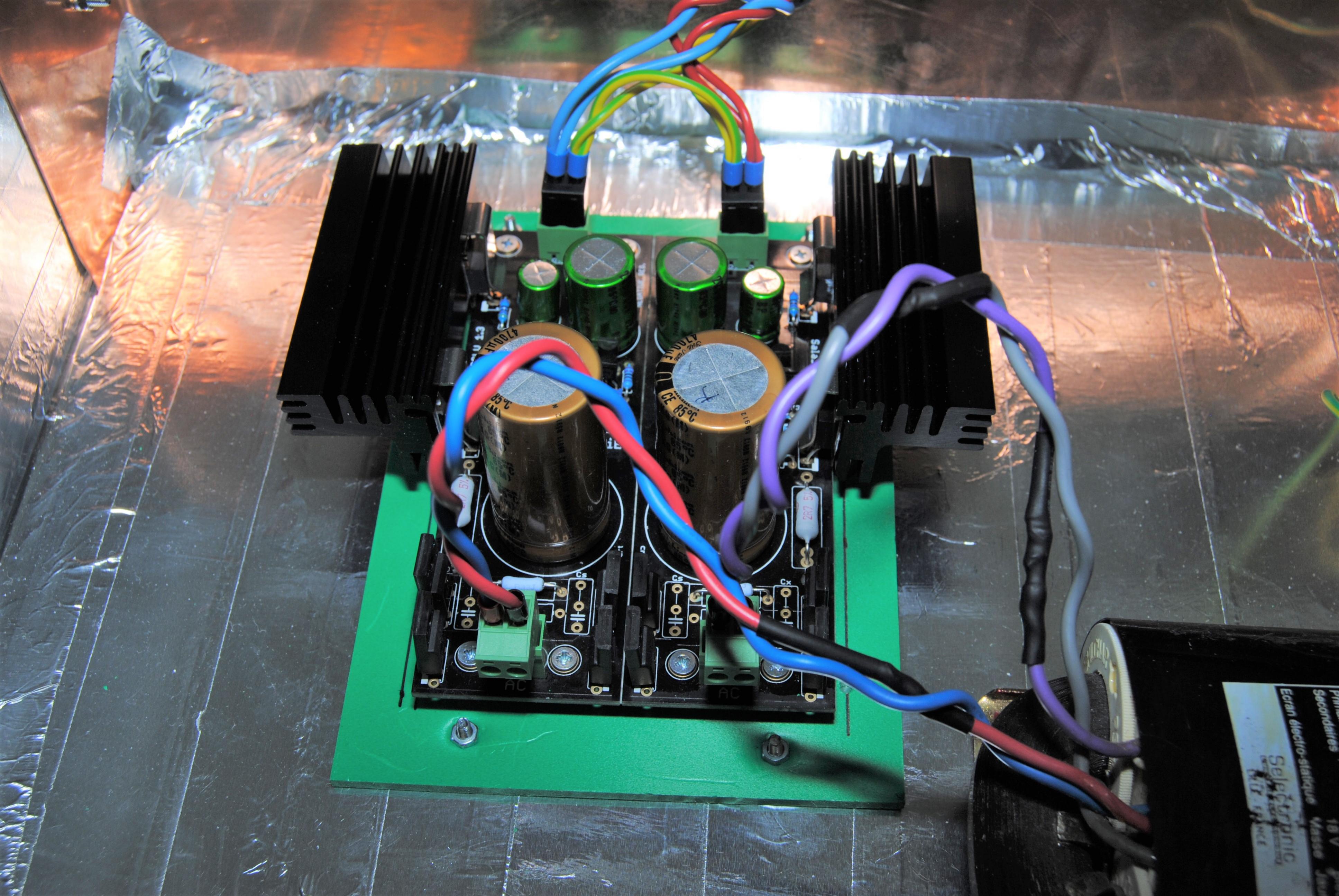

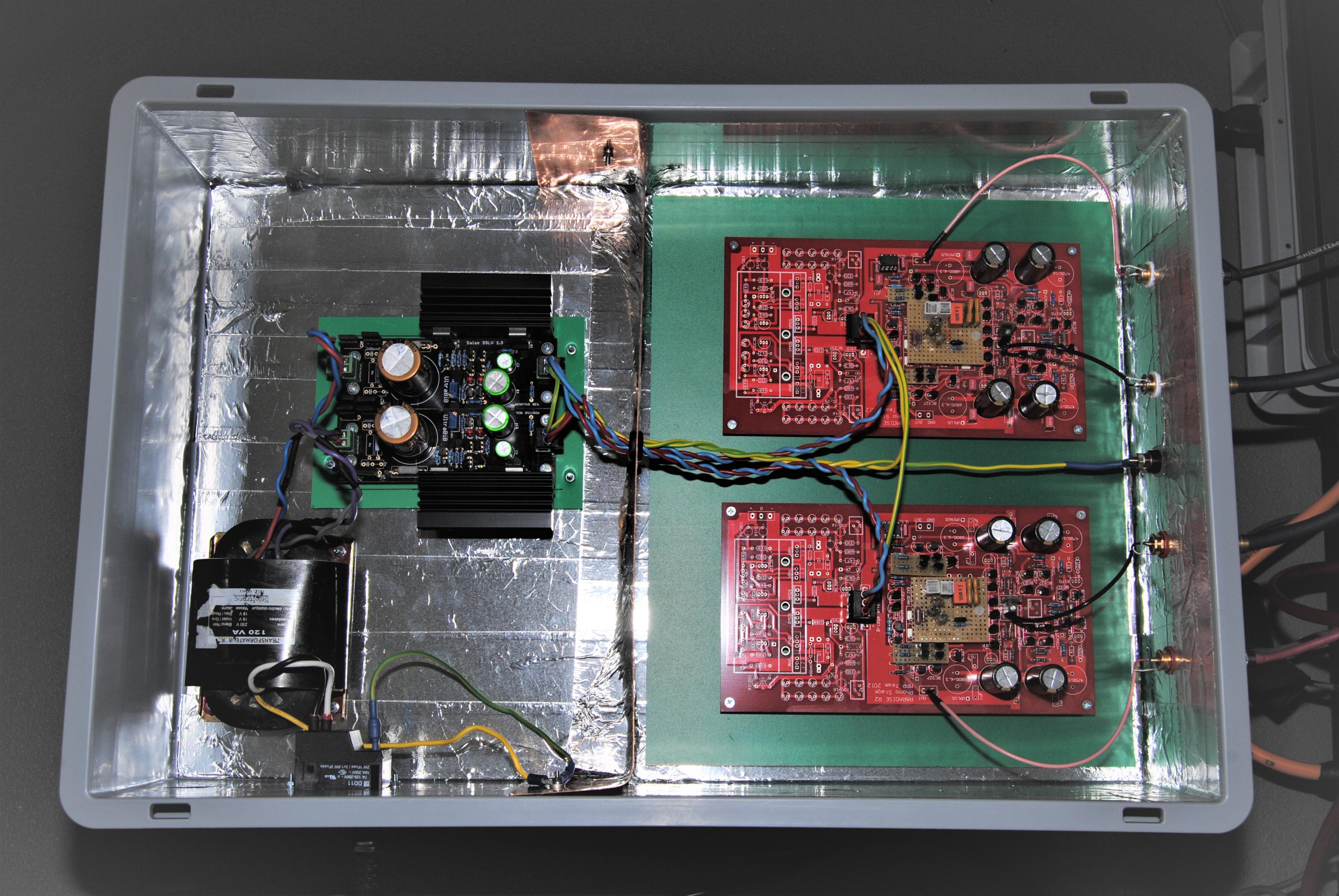

The ultrabib is super stable and noiseless and I have one pos and one neg to power both riaa boards.
The result is an exceptionally silent preamp (no noise no hum) with an energic sound with really outstanding bass but this time with quite clear and extended highs as well.

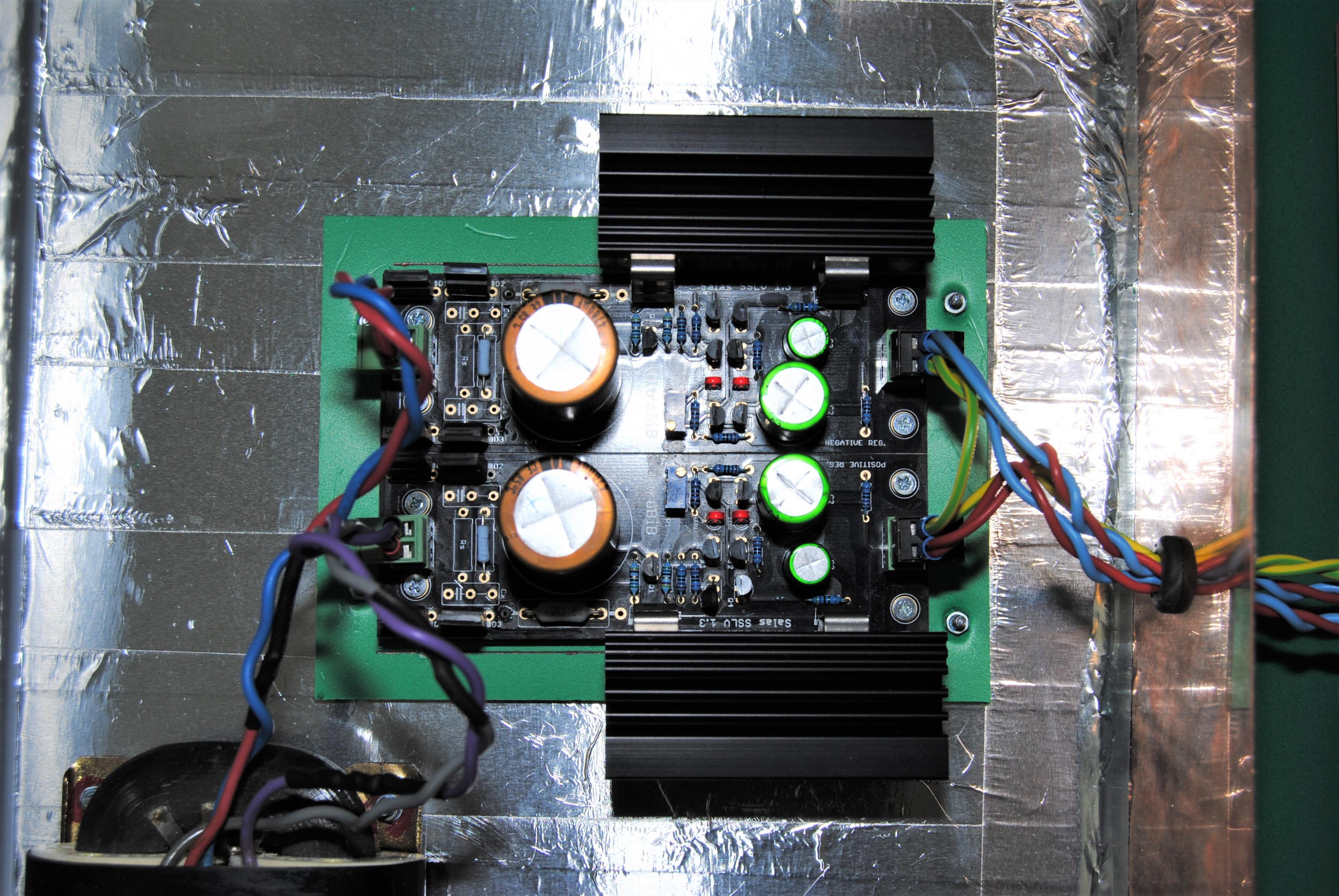

Each phono board spends 70mA pos and neg so I need at least 140mA from each shunt.
Setting current output in the shunts for 180mA with 3.3ohm R1 does not work.... negative shunt does not light up.
Setting shunt current to 220mA (R1 = 2.7ohm) works perfectly so I have a 70mA margin on the voltage mosfet.

There's possibly some inrush current flow for the Paradise's input stage large value decoupling electrolytic capacitors and/or to its mirrors low R high C rail filter cells so you needed more CC in the end than you initially thought of.

What type are those C1 capacitors in the UltraBiB ?
P.S. Ah now in the close up pic I see Gold Tune at an edge...
Some more pics
Luckily the 2SK170s are GDS pin order and the BC337/327s are BCE so you replaced them right in the Paradise's PCB with no leg tricks 🙂
The Katana documentation ( Amazon Drive ) is not clear on the exact +/-15V power requirements, but there is one useful spec. The +/-15V is generated by an on-board switching DC-DC converter. That converter's power requirements are stated to be 5V @ 180mA. This hints to about 30mA of current draw per 15V rail.
But then to make things a bit confusing, there is also this spec: "5V-800mA load for OPAMP".
So it's best to ask Allo.
But in any case, the power consumption will be nowhere near 1.5A.

I would imagine if you will ever add another one full PSU, i.e. extending to dual mono Tx + dual mono UltraBiBs, to can possibly extract even more subjective performance out of that Paradise special mod version. Of course you had experienced the original circuit with its own dual mono on-board PSUs before and any deterioration due to single external shared PSU would have been alarmingly obvious.
So no noise and good sound on a 63dB gain phono shows that using a single shared UltraBiB is still adequate for very good cooperation with such sensitive high gain type of circuitry.

As I suspected, there must be some confusion going on with that Katana stack's third floor board consumption spec. Thanks for looking into it. Anhton82 must investigate his real mA needs for correct CC setting a bit further now.
Of course a power test with some dual bench supply that directly displays the consumption or with LM317-337/LM7815-7915 or other handy diy PSU plus a DMM in series current mode between it and each rail input of the loading circuit will answer the steady/peak mA question without a doubt.

I will build a second set of ultrabib (in it's green form) and add another TX in the near future.
Right now I will concentrate in listening to better evaluate it's strenghts and possible drawbacks.
I am really amazed with the bass performance.....
Maybe you could even cut away the unused Paradise PSU sections to make its boards shorter and bring the UltraBiBs closer to save on DC power cables length and floor plan area. But this is arguably bit of a hardcore suggestion aesthetically.
