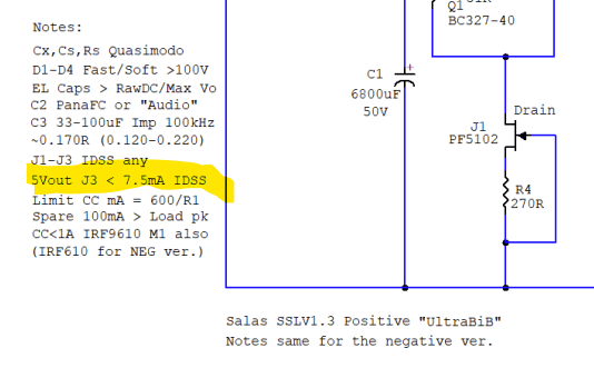

The stability problem with mine version could easily be the modified CSS part of the regulator.
In my implementation there are no source resistors for the 2SK880s. I use them only for simulation purposes (Idds).
I am tempted to try a diode (1N4148) in place of R9, once I figure out the reason for the instability.
I have a trial PCB at 3V3 on the bench, full smd for space saving.
Regarding 2SK880s, i am now testing it with 2mA Idss of the Y classification without source resistors
If I use the GR classification with a source resistor to reach the 2mA, in what will differ?

I suspect my lack of knowledge prevents me from being assured that the things I do I do right 🙂
It is embarrassing but I ll give a go.
15 V from the psu. G,S pins shorted. Meter in ma range, I put one lead on the V+ and another on the drain- measurements bunched around 8-9ma.
Am I doing it right?

I forgot to order Rf so connected bench psu to C1 to test.
Target output is 5V so my 3296Y-1-502LF positive trimpot is fine but negative side is just above -5.22V and stops there.
Should I order a different trimpot or there is a way to adjust Rvv or similar to fine tune dc?

I repost in case it got lost between others
Regarding source resistor
Does it somehow serve like it works better in the linear region than in saturation?
