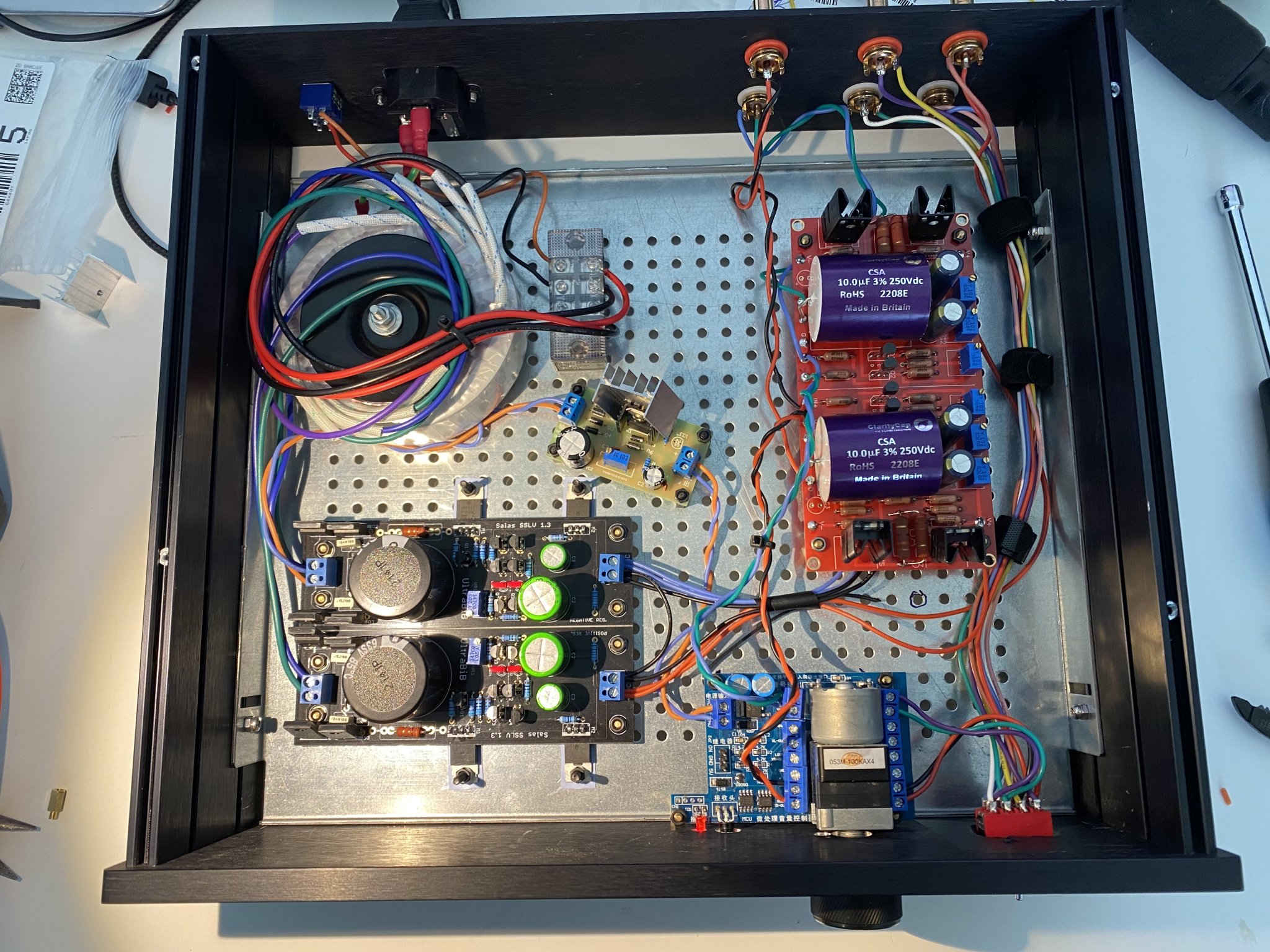

It is a board from China where I replace apot with the Alps pot.Nice. Is the motorized pot Panasonic?

Next step is to move the Muses volume control from the other preamp I have.
One more question pls.
I am considering to put 2-3 regulators into a dedicated chassis.
The cable length between regulators and the preamp & volume control will be around 1 meter + internal cabling around 30 cm. So, in total 1.3m = 4 feet.
Would you advise any extra compensation at the preamp board (some capacitance) for such lengthy wires?
