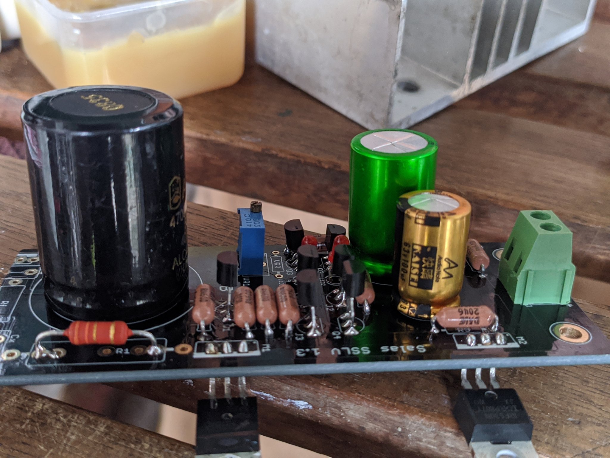

I seem to have populated a board with green LEDs. I know (think) this will give a higher voltage reference? By 0.4v or so.
Are they ok or should I swap in red ones. I thought I remember seeing someone populate neg rail green and pos rail red but maybe that was another thread!
Green are also ok if you're not going for 5V minimum voltage setting. I don't remember that build. Maybe he populated with different colors to make the positive and negative PSU visually distinct.
36v across C1. 30v in.M1 was bad though, so you did well to replace. How much raw DC develops across C1?
Yes, J's are PF5102s. 30v is a bit higher than I need. I should be using 24v tranny but it's what I have for now.
Going to pull Q2 and all the other Js and Qs I haven't checked before trying it again.
30V is AC. Measured at the input of the Ubib. C1 is 35V DC.
Pulled all the remaining Qs and Js. Q2 was good as were all the rest, except for Q3 which was bad.
Total so far- M1 and Q3 went bad, the rest were good. I'll add them back in with a new Q3 and see how it goes.
No, could have been soldering or de-soldering. I use Hakko equipment for both. Maybe just my error.Any idea as of why? Too long under the iron maybe? Is the iron mains grounded?
