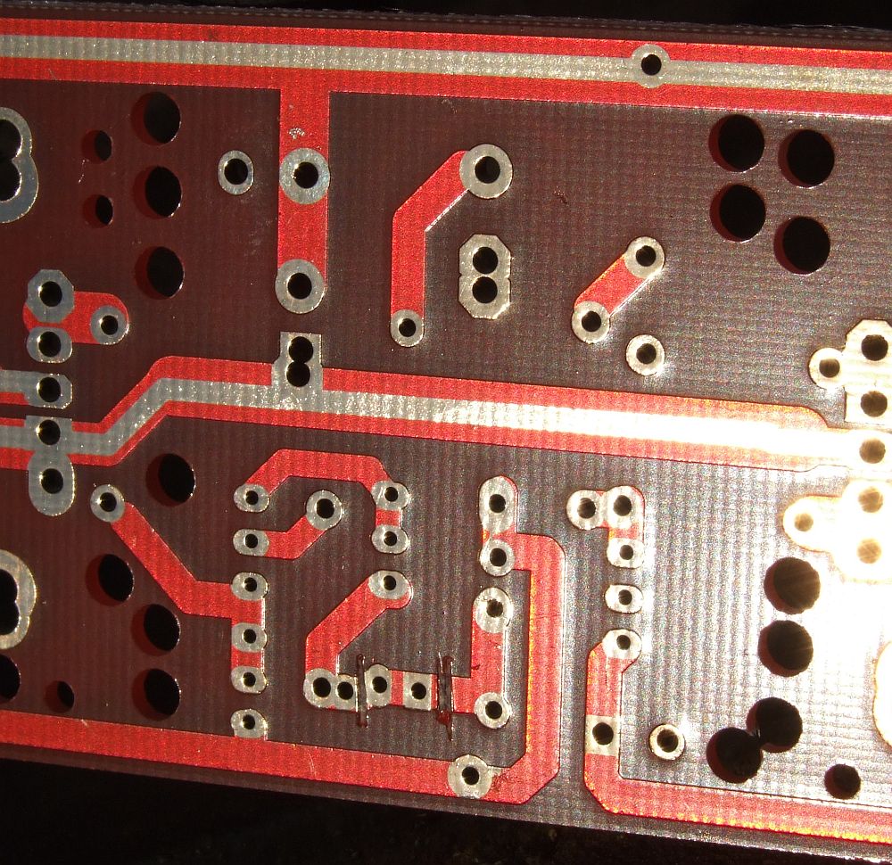

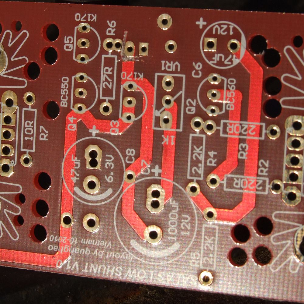

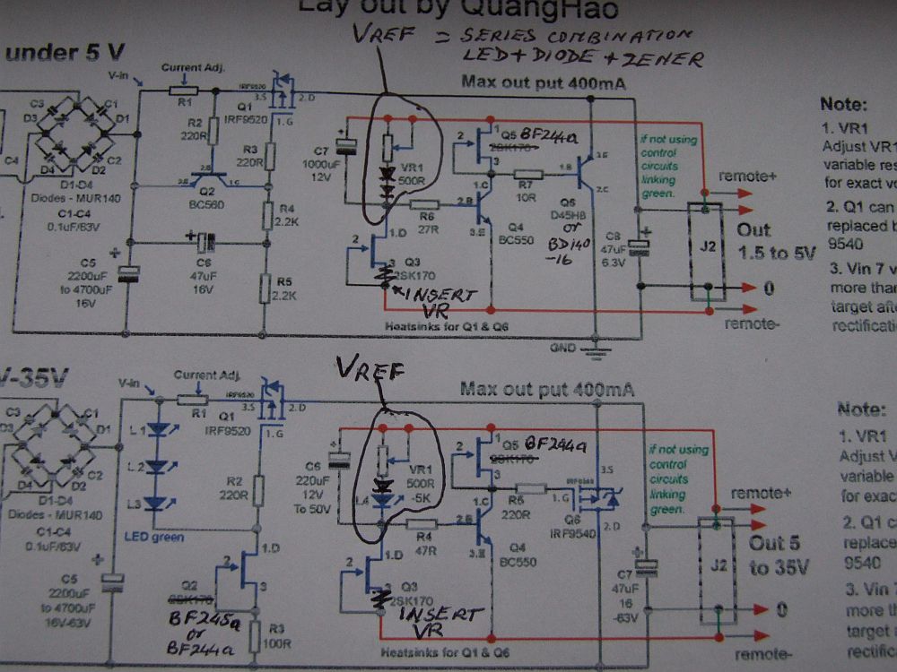

PCB modifications to Vref
Trace cuts next to R6 allow extra LEDs/diodes/Zeners to be added to the Vref string.
The schematic shows the Vref string, both the <5V and >5V versions.
The output voltage trim adjustment is moved to the CCS source lead. 0r0 to 200r gives an adequate trim range.
More to follow.

Why there's still a trimmer in Vref section if the trimmer moved to CCS sources lead. Bit confuse here.
I consider any variable resistor to be temporary only.
Use the minimum resistance to set the voltage you need, then replace with a fixed low tempco resistor. Then final trim in the source side of the CCS and again replace with a fixed resistor. I have some nice 1W 100r pots that I can use as temporary VR for setting up.
