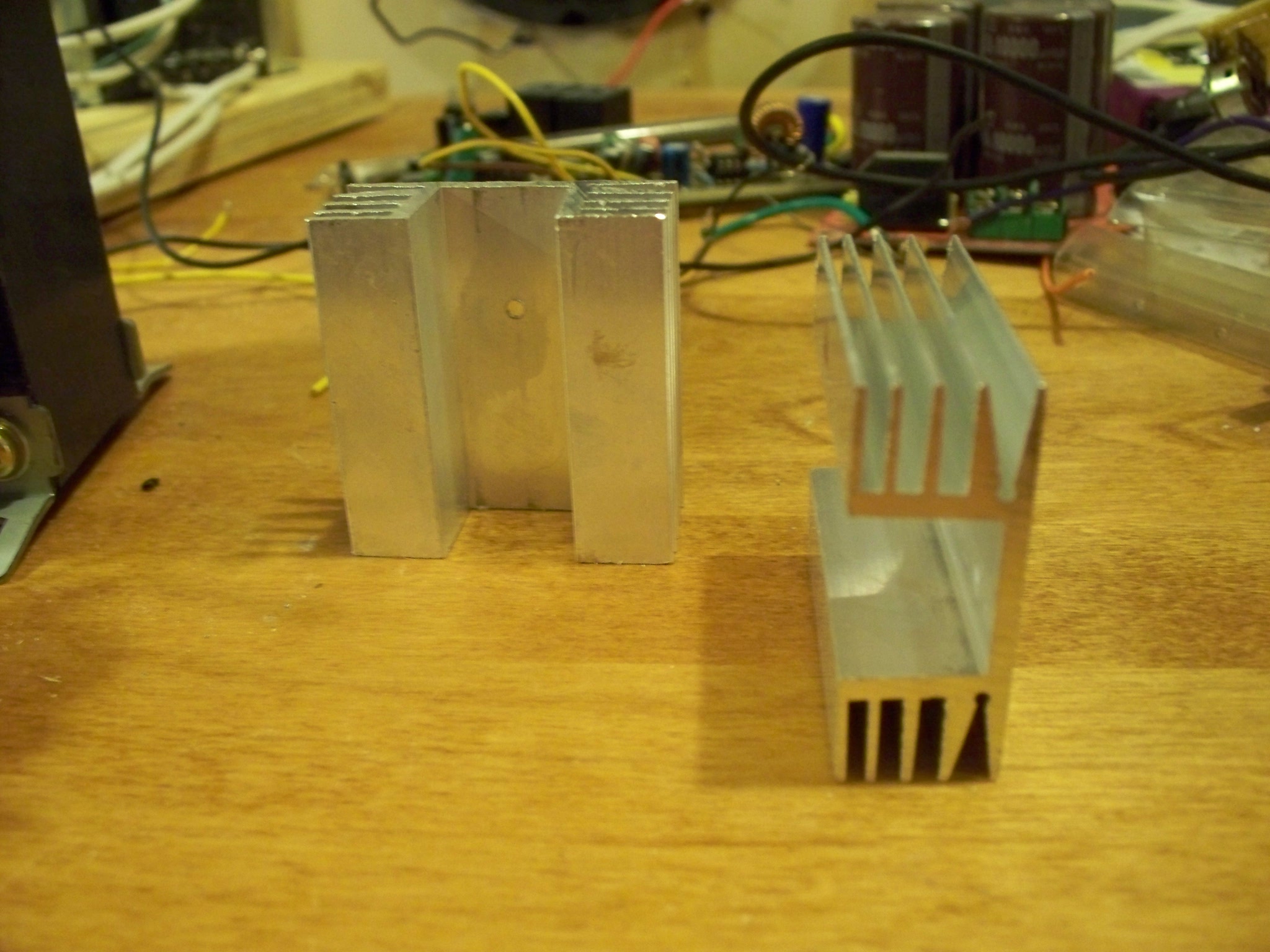

Thanks for the heads up! I'm thinking about 800mA but my heatsink is quite large... I looked a up it up and it's at very least 7C/W so hopefully that will do the trick!

I am using these ,no heat problems yet.they run about 85 F @.400 ma
got them at a aluminum surplus and cut them to length,got about 50 for 10.00 bucks.

What about the heat, would it be too hot when using a much smaller size heat sink????
you can calculate the dissipations of the two main FETs from the supply voltage and the output voltage.What about the heat, would it be too hot when using a much smaller size heat sink????

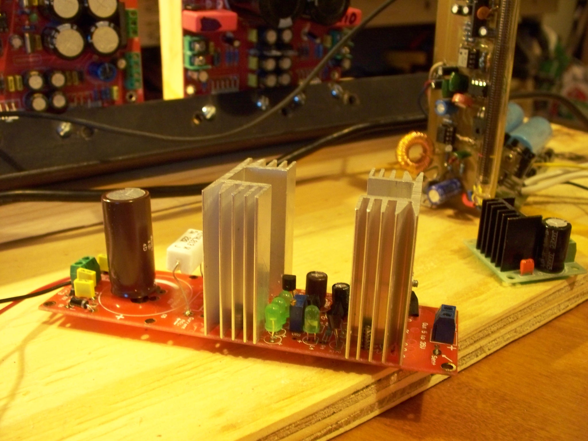

I haven't ran a new board yet,,,,,I did find a stability problem on the one in the pic, you have to give them a minute to get to temp and then under a load if you blow on the heat sink it will change the output,my solution is to put them in a enclosed box and vent it, so it will not get any unwanted airflow,
I have read about using a zener to reg,but not tried it yet,I don't think that the drift maters that much, the most has been about .03 volts,

I built the boards to spec on the silk ,I am putting 40 ac in but the most I get out is 13.0 vdc....Do I need to chance some parts I haven't gone digging yet but will have some time soon....

The LEDs are lit to be sure CCS is going on well? Have you connected the remote sense wires? It's really strange this reg is solid as a rock...

all LEDs are burning ,4 of them,I have a 22R and a 1K trimmer,.47 uf and a 220 uf, I did connect the sense wires to the output pads,I have loaded the output with a 300r and a led,I can adjust the trimmer from about 4.o to 13vdc I have 43vdc at r1,I did check the big fets out of board there good,I am going to do the sk170 next,all the parts are new,,,
both 5 to 35 board are doing exactly the same so If i screwed up I have done it 2 times,lol
Thanks for all your help this problem is probably something I have cause but it will get fixed I am sure...
