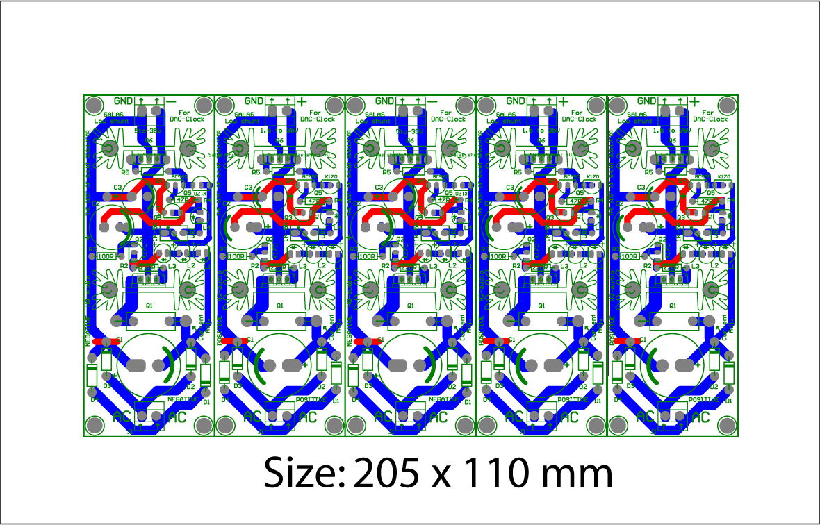

I can't see the sense traces to monitor the output voltage.
You must change Vref to a minimum of 3 components: LED + Zener + resistor and if room an extra LED or optional VR.
All the jFET (sk170) locations could be changed to 4pad from the existing 3pad.
The alternative gate pads would connect to the opposite side drain/source pads. This simple one extra pad avoids the need to modify the jFET if converting polarity of the PSU. And requires no extra PCB space !!!
I like the new smaller size, 41 by 110 is more manageable.

Im sorry very, Im later
This is layout, the comments you add me, Thanks
Quanghao
Dear Quanghao
Did you consider that lay-out proposal (#226) , when you decided to make your own layout?
http://www.diyaudio.com/forums/powe...tic-salas-low-voltage-shunt-regulator-23.html
I'm sorry but this went on for too long and changed way too many times for me to keep track. Also, last time I saw the price of the set, I couldn't really afford to pay for the boards I want anymore, so I'll remove myself from the list for now.

where has the sense gone? I concur with all AndrewT's suggestions with the jfet pads, which we have been talking about quite a bit and many agree. as I mentioned I would love to see optional TO220 pads for the diodes, takes up no extra space and means I can stop bending them to fit. of course sense lines can be hacked in by the end user, but its not ideal, I would love to see connections for AMC coax connectors there for the sense lines personally; a man can dream.
