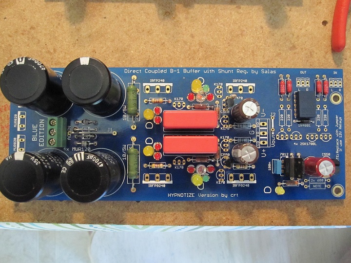

1st power up
I am still waiting to the Texas Components TX2575 resistors, but the rest is ready to show 🙂
The other resistors are PRP9372 and the four 470R at the gates are Takman REX carbon film.
Because i´m also waiting to a special made shielded transformer, i use one of my 12V secondaries from my DAC project transformer for the 1st power up.
Everything works perfect!
Nice big informative pictures. Is the heat on the small sinks comfortable with 22R CCS setting resistors? V+/V- OUT you hit close together?
The heatsinks are perfect. With only one 12VAC input i have +10,09 VDC and a -10,16 VDC at the outputs.
Thank you both and crt for this project!![]()

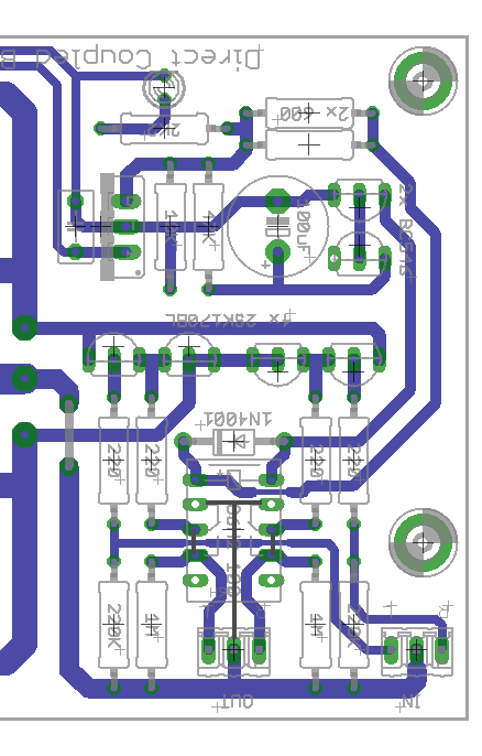

Ok, I need someone to verify if I have mounted the relay correctly. I am almost done and just waiting for 240/9240 along with deciding what resistor to use in the 220r position on the buffer. I also purchased some some 2sk170 from spencer and should be here shortly.
BTW, my LED are set at 5.4v and 9.4v, should that be ok?
