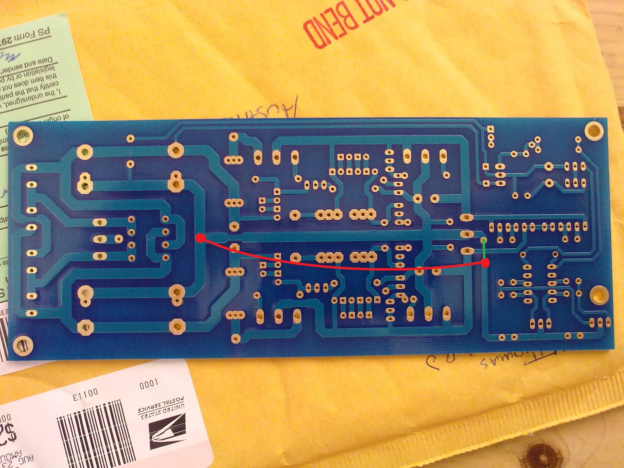

I have a question/suggestion concerning the grounding-scheme. Please see the attached picture. Normally the buffer's ground would be connected to the PSU's ground via the green jumper. If done like that, the buffer's return-current would share the shunt-reg's return-current path. In a power amplifier this can lead to problems when there are large current pulses from the PSU. Here we have a regulator with a constant current draw and a tiny buffer...but still, wouldn't it be better (lower impedance) to route the ground like depicted with the red jumper?
The printed ''tail'' lets the filter caps currents recombine locally. Then you add yet another parallel tail only for the audio. I would not expect it to change anything. It ain't buzzing even on Tea's Lowthers as he reported with his proto, so...
