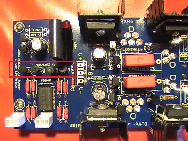

Is it ok to use LSK170A and mix them up with some of the 2sk170BL's for my 2nd unmatched board ?
Thanks,
JG
LSK170A is lower IDSS like 2SK170GR. If you got IDSS matches for the 4 audio JFETs between 2SK & LSK they are compatible though.
Hmm,
where do the matched set of 2sk170's go on the pcb board?
Thanks,
JG
You will see 4 in a row,
that is where I placed the "Matched" set of 170's
on my Blue Board.
I just guessed I may be wrong,
I ask the same question and receive the same useless
answer as you just received to look at post 4,
Looking at post 4 is the same as looking at the board in your hand.
There is an example link in post 4 showing the audio Jfets positions and how to arrange the slightly less in IDSS from each pair, reserved for the two inner positions. The guy who gave the answer was useful. Look better.

wow, I caught that in a glance before I even had the boards. way to ingratiate yourself to those who might help you if something goes wrong
For what its worth, I think these boards are very well designed and Salas, Tea-Bag and others have been VERY helpful and open with their time. The boards are also dirt cheap, imho compared to what you would have to spend on a retail product.
The picture of the schematic, board and solder screen with grounding layout is very useful. The BOM on the 1st page of this thread complements the board perfectly with little doubt, imho. If there are doubts, then post a question, but be nice about it. Insulting the original designer(s) gets you nowhere.

We are here to learn ...i think, you owe it to yourself to read the thread, especially post 77, then thank Salas et all and be happy you got a whole lot for nothing....and by the way post 4 has an Example which profusely explains things....look closer...find the link....
