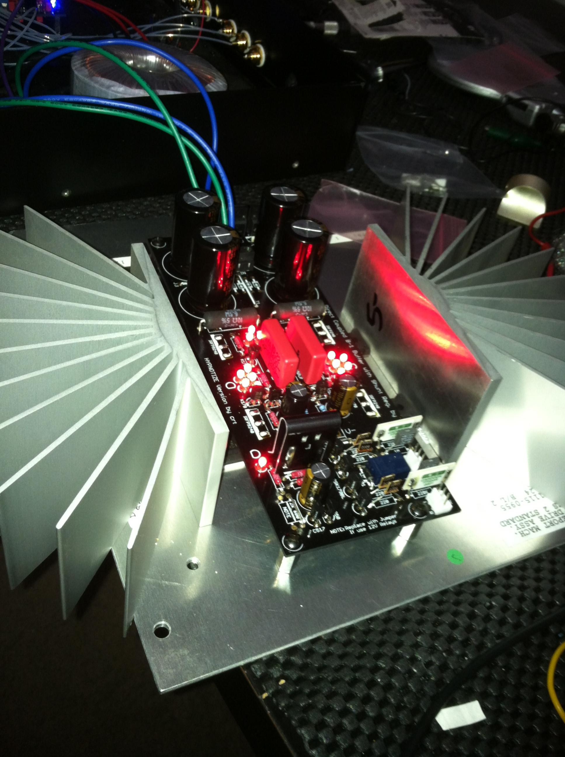

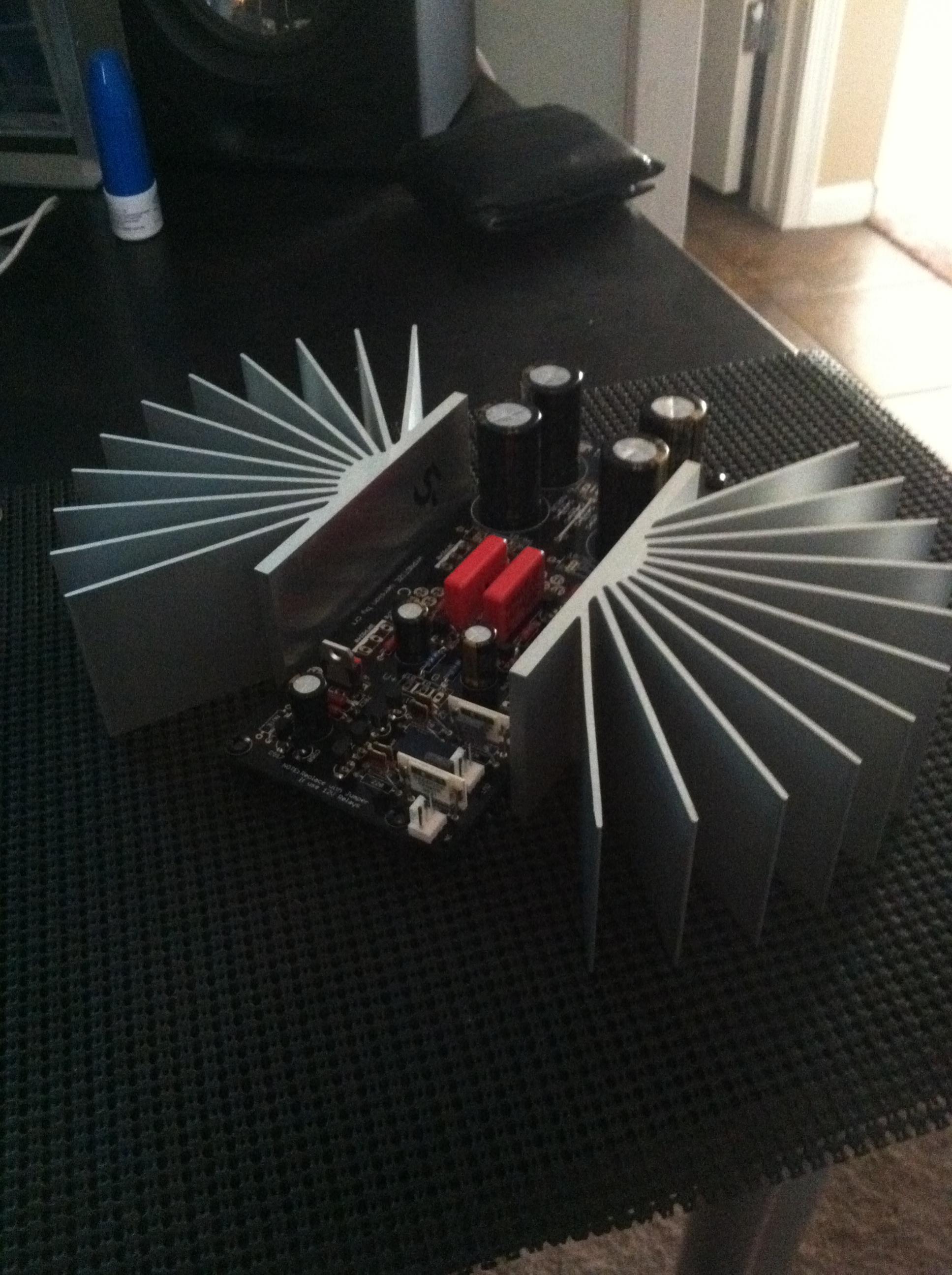

Here's my build so far. I went with Caddocks and TX2575s on the IN/OUT branch.
I just need to match the LEDs for Vref and CCS. I'll do that today and get some woodworking done tomorrow.
I just finished the kit from T-B. All LEDs up. The Vdrop on R1 was about 2.0V at V+ side, but it was only 1.7V at V- side. And they would drop to about 1.95 and 1.66 after a few minutes. One side Vdrop seems to be border line (2 +/- 0.3V).
Also, the V+ measured to be about 10.05 and V- to be -10.14 so that V- was actually slightly higher than V+. Output DC offset was about 2mV and 3mV at L&R channel. The fact that |V-| > |V+| worries me. I am not sure if there is something that need to be fixed?
When I matched the LEDs, I only use the diode mode on a Fluke 179 and read the voltage. Was that not the "good enough" way to match LEDs?

The Fluke 179 luckily has a 2.5V diode test spec and gives results for LEDS also, but any meter to save its battery never gives more than essential current to turn them on. Hence it won't give a reference measurement at the current range they see in our specific circuit. BUT your PSU results are no problem for the DCB1 tolerances. Your DC offset is not spectacular but in spec too. For mostly aesthetic reasons you can try to near the running currents in both CCS. The -V side drop is weaker due to different Vgs of your POS and NEG Mosfets. Use ~25% less setting resistor value on the negative CCS. I.e. 10R on POS and 8.2R on NEG as it is set now, or 5.6R and 4.7R for a hotter running system @ ~350mA if you feel your sinks cool enough now. It usually becomes even nicer when running higher. Do those things in leisure, your DCB1 is good for use as it is.

Don't change the LEDs.
The output offset is determined by the accuracy of selecting jFETs with the same Idss.
What I couldn't figure out is why the building note suggest +Vout will be slightly higher than -Vout.
That note comes from the original version Mezmerize where I deliberately mismatched the polarities a bit for creating more second harmonic and aiding offset in a low CCS, not heatsinked, small size aim. The hot rod Hypnotize naturally presents a bolder tonality due to PSU boost and the symmetry I restored in the local Vref CCSes by orthodox design.

Resistor differences can add to it also, but with modern parts tolerance spec they aren't the main contributor which is VGS given that reasonably close LEDS are used.
