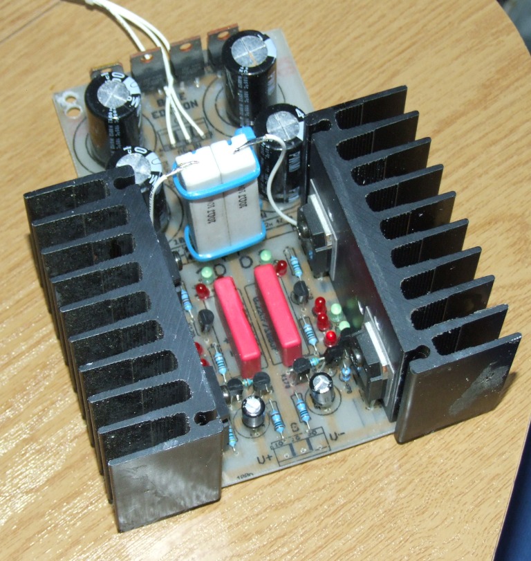

Hi all
I've been reading this thread for a while
I'm on page 131 for now- its great!
Finished stuffing my board but did not connect to in/output
Vout is 10.13 & 10.20
V at 10R risistors 2.09 & 1.92
DC offset set at lowest reading (2M) shows 0.003 & 0.001)
Looks okay right? but mosfet are not getting warm at all- is this okay?
IK
IK
What do you mean lowest reading 2M? 2 millivolt scale on your DVM? If yes, then it measures fine all over. About heat depends on sinks. If you had bolted it to a thick chassis with big sinks it can be cool at 200mA and 10V you run. That 2V/10R=200mA has to go somewhere could not stay at CCS. Is any other component from the non sink ones suspiciously hot beyond the 7812?

I did bring mine to slightly above 600ma and noticed improvement in the imaging. To me and my tin ears it was worth the cost of the two 2.5R resistors. Cooling is still good with the "Tea Bag" style heatsinks. I did replace the top of the metal case with a perforated aluminum sheet, just in case.
I've also been playing with the three 100uf caps. I've tried so far Slimic IIs, KZs, Cerafines (older and newer) and STD blackgates. I burned each for about 24 hours (some say not enough for the blackgates) and so far I like the Slimics the best. Compared to all the other caps they sound more defined and increased a bit the width/depth of the sound stage. They also strike a good balance between adding a tad more definition and brightness to the sound. I found the Cerafines were the least bright sounding of the lot, but their sound stage was not as well presented as the blackgates and Slimics. Compared to the Slimics, the blackgates sounded a tad brighter. The originally installed KZs I would rank as last in this pack for me.
All the caps were 24-63v except the blackgates, which I could only find 160v ones for a reasonable price.
Another change for me was to replace the 220k caddock resistors for naked foils (which I was able to afford after taking a second mortgage on my house...). I had already replaced the 220Rs with naked foils. This change opened up the sound when compared to the caddocks. Cymbals also seem to have more texture and extension than with the caddocks. I kept the 1m resistors as caddocks.
I've read some people recommending the FC and NHG panasonic caps, they are cheap enough that I will order some and try them out. The blackgate Ns have become unobtanium and the few I've seen from trusted sources (trusted to me) seem to run abut $50 each. I think I will be skipping these...
All of this is in my system with my ears, the mileage of others will of course vary.
I will post photos when I paint the aluminum perforated cover.
Thanks again for all the support, my system has never sounded better than what it is sounding today!
