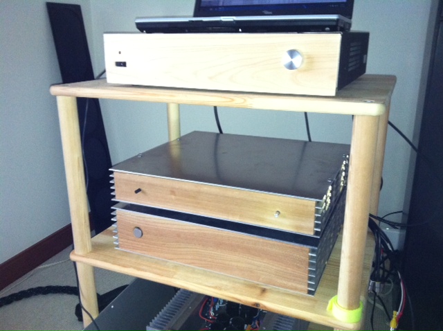

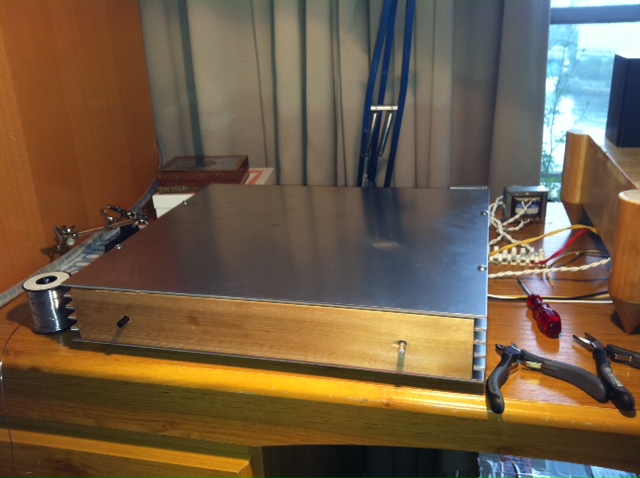

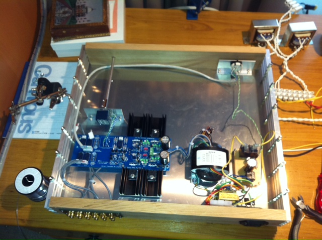

..but at the end I completed my DCB1. Here are some pictures. I am using the same switch to power the buffer and to select input. pos1 is off, 2-5 input select. I have a primitive power supply for the relay that switch on the system.
If I remember well, I have a 3ohm resistor to set the current. (But I could be very wrong here)
I left a lot of space in the chassis, as this is only the first iteration. I have some options that I will consider (and some related questions):
1) Buffer before and after the pot. Question: in this case, can I use a single power supply ?
2) Balanced. Here I guess that the matching and the bias handling can become a mess.
3) Remote control for volume and input.
Thanks,
Davide

This is a Mezmerize multi relay input version board. Has the pot PCB routed before the buffer as it should. Single shunt supplies per channels are inherent too. You probably got 33R, not 3R. Check this out, it defines dissipation. Would not use more than 200mA with your sinking arrangement. I=~2V/settingR. Looks good.
