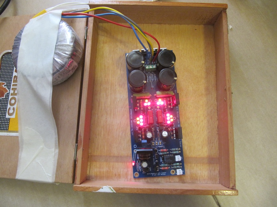

I can see it in the BOM. I hope DimZ did not put 1K there. It is to check currents when setting for reg use only following the guide steps thread. You may jumper if for fixed DCB1 use.
no, I used 1R
the orientation of the leds is right (the triplets are on but not the quintets), I'll try to check them on board or change them all to see if there is a chain break...
Use 9V battery and light them one by one with 2 wires before attempting taking them all out. Do it fast or use 1k in series.
I'll do that with the 1k res ...
Success! Have a cigar.
I will certainly have !!! my humidor is full
thanks
besides dc offset, and voltage across R10, what else of critical importance is there to measure ??
Nothing more. Measure pleasure spinning a couple of fav recordings. Will come up smoother in 48h for the Ecaps to shape up.
