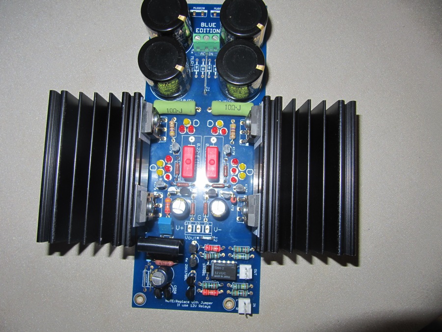

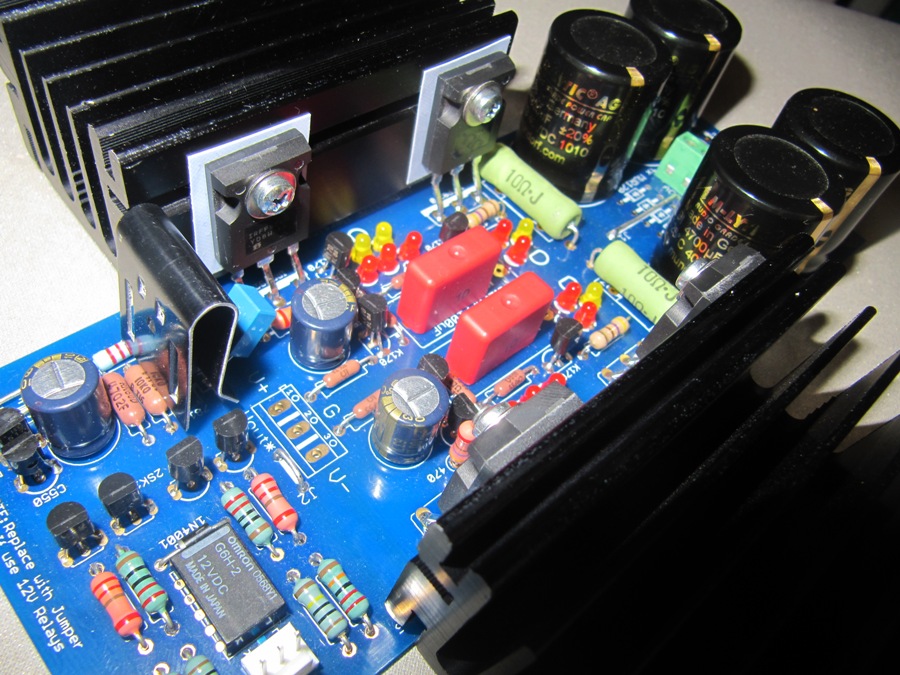

You have more than enough self sinking for 10R setting. No problem.
for the fets its ok, I was wondering about the diodes (mur 820) which I havent soldered yet ....

That's what I mean ''self'' sinking. The TO-220 8A diodes can work at the 10R first step hot-rod self sufficiently. At 0.65Vf with 0.2A no sweat. In general have a rule of thumb, don't get more than 45C on Mosfet sinks or diodes, for a long trouble free life. Nice build execution by the way.

hooked up the transformer
the relay clicks after 6 sec but the leds dont light ...
as far as I can see the orientation is corect
See better with diode check on DMM. If just one string was not lit we could say one in there is installed the other way around or burned. But all strings dark, probably all are reversed.

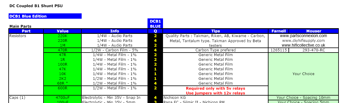

Hypnotize board, resistor marked 1 (1R I presume?), why is this not on any BOM? Or as least I cannot see it...
Can I use jumpers here?

I can see it in the BOM. I hope DimZ did not put 1K there. It is to check currents when setting for reg use only following the guide steps thread. You may jumper if for fixed DCB1 use.

Salas that 1R on my BOM is 10R:
You don't have the blue board and blue bom? Post#10 this thread. That one you show is from black boards, says standard and deluxe.
Face palm slap, “ouch”!
I now understand I have the Blue Edition Hypnotize version not Standard Hypnotize boards.
No problem, I’ll just jumper 1R position.

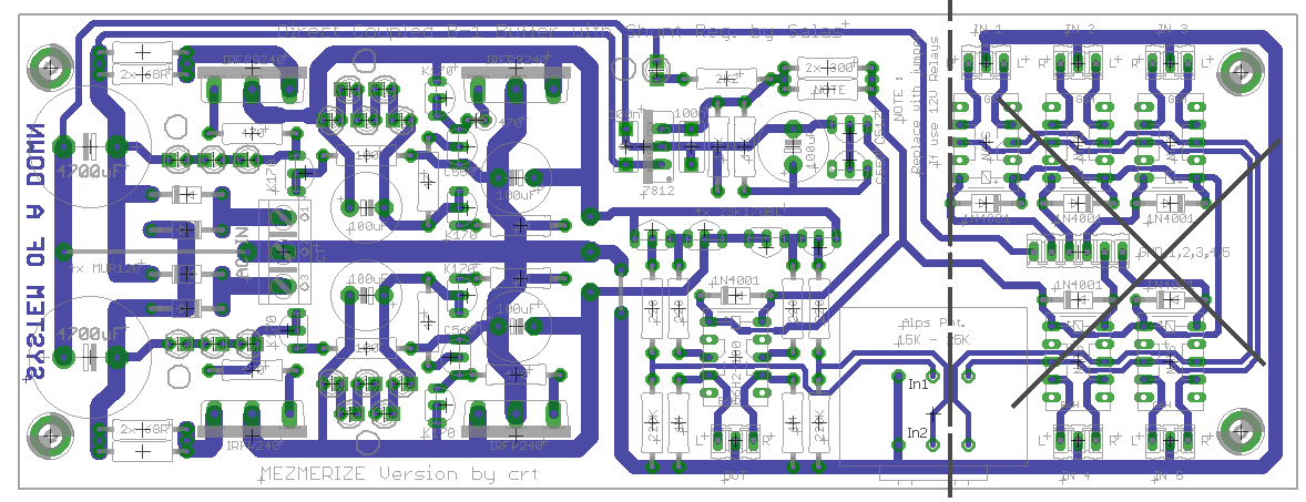

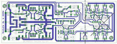

You think that's bad - I got Mez boards not realising that there were blue Hypno boards. And that's after reading the various threads for a couple of weeks to try and figure it all out. It's no problem for me and I'm hotrodding them at the moment (pics will follow), but there's a bunch of parts not populated of course (on the board).
I now wish there was a "Which B1 to build" thread to just sort this out. It could have a description of the various designs and boards, the BOMs and where to get things and so on. Just to help people in the future who come to this and try to figure out what they need.
Why you did not post a question what is hypno what is mez mentioning your application in mind? Cut the excess board parts off, they can still be made to relay switched inputs pre amps in the future if needed when fed from a +/- 10V PSU.And that's after reading the various threads for a couple of weeks to try and figure it all out.

But at the time, new to the board or thread, coming in as a new user and late to the party, there seemed to be several old and new designs, and at least at the time there was no centralised explanation of the several designs. So as a new user, I read many different threads, and it seemed that the Mez boards were the latest design, and importantly they seemed to be the only boards available.
I never saw anywhere an explanation saying - if you don't want input switching, get a Hypno board, (which colour I don't know), if you need input switching, get a Mez board (from TeaBag - many thanks). Etc. Maybe it's there and I missed it, there is a lot of info in the various threads, and finding what you want is not a trivial task, especially if you're new.
Its there many many times in the course of the threads. Any late comer could open a DCB1 short guide FAQ thread though.
*Correction, you can use the left off parts as multi input switches only, the way I showed the cut, fed from +V/GND 5 or 12V PSU given the relays at hand.
