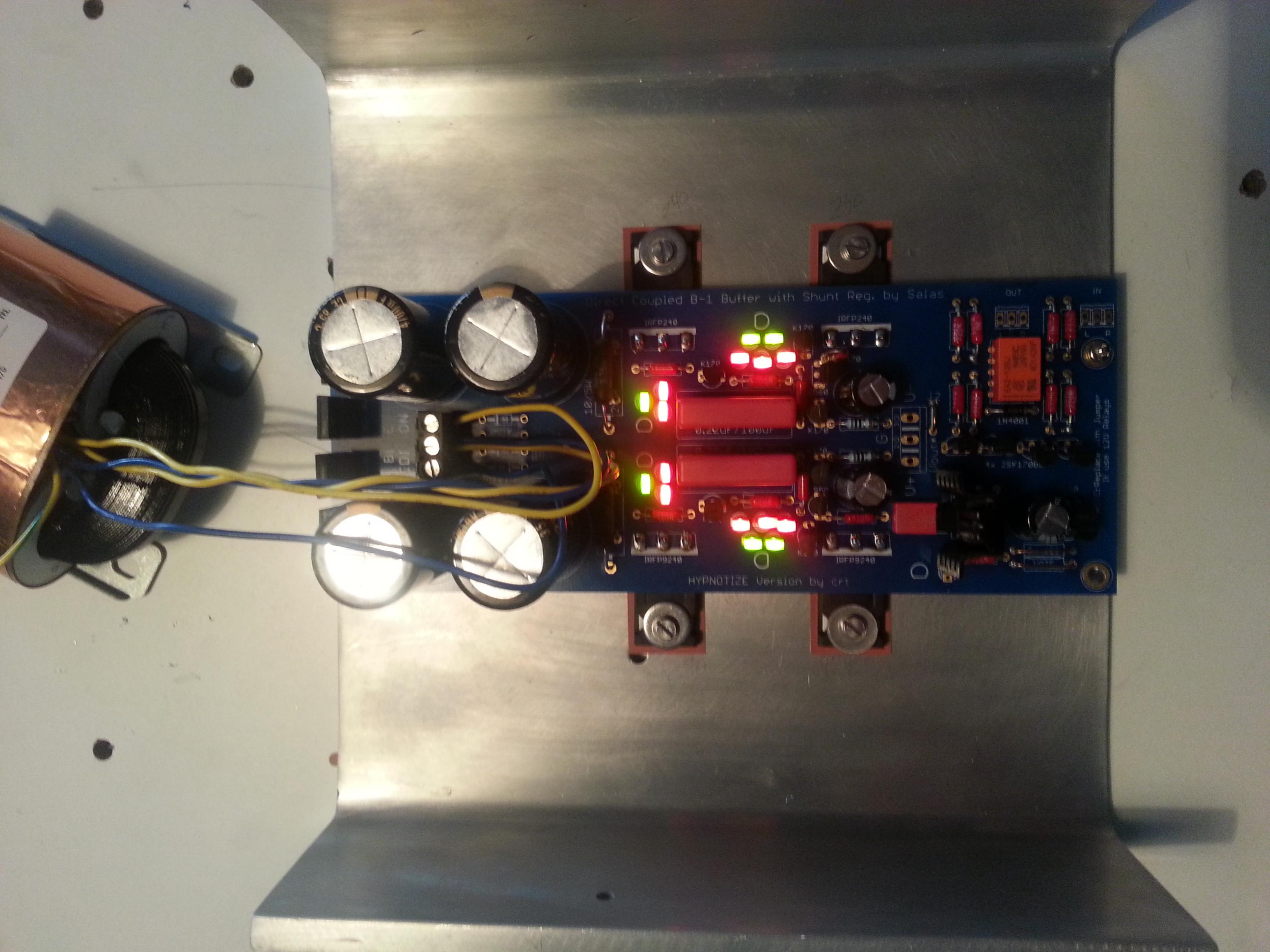

Had time for some soldering between work and supper to day. (As it is friday, today's menu was grilled and sautéed beef, mushrooms and onions, Hasselback spuds and home made red wine gravy).
Anyway; holes for the IRFPs were drilled and threaded, 100uF caps and IRFPs soldered, power connected and the lovely DCB1 lit up like a christmas tree 🙂
I measure a difference 0.04V between pos and neg rail and there is an offset of 0.029V between the left channel and signal ground. After half an hour the temperature had reached approximately 35 degrees centigrade on center legs of the IRFPs. The 10 Ohm resistors were just a tad warmer.
0.029V offset is 29mV which is not good. You are looking for 0.005V (5mV) or less in both channels output. Use the mV range of your meter also or another meter to make sure. If there is a coupling capacitor in the power amp's input no worries for now but get a better matched JFET pair for the left channel to drop the offset. All other things look good. Measure voltage drop across each 10 Ohm resistor also.

Paired secondaries, and the wires will be twisted; this is just a mock up test rig.
I suspect bad soldering, but I'll check the jfets also.

Hi there JCP, saw you picture, may I ask for your heatsink measures? I mean, the footprint of your DCB1.
I'm putting it together after some months it's been in a shoebox with other components (yes... 🙁 ) while I was away; I had a plan to dissipate on the face down the MURs also, but now I'd like to order a new heatsink for when I'm back at home.
The heatsink is a piece of aluminium U-bar, measuring about 20 cm wide. Length is just about equal to board lenght. The thickness of the base is 5 mm and the sides are 7 mm,- if my memory serves me right.
Resoldering didn't solve anything but looks. Is it the jfet quadruple by the output relay I need to look into? If yes,- how? I'm on thin ice here 😉
Yes the quad by the relay. Very good IDSS parameter matching between each pair is needed for minimum DC offset per channel.
Each left and right duet from the quad is a channel pair. Each duet's JFETS flat faces are looking at opposite direction to the other channel's duet.
