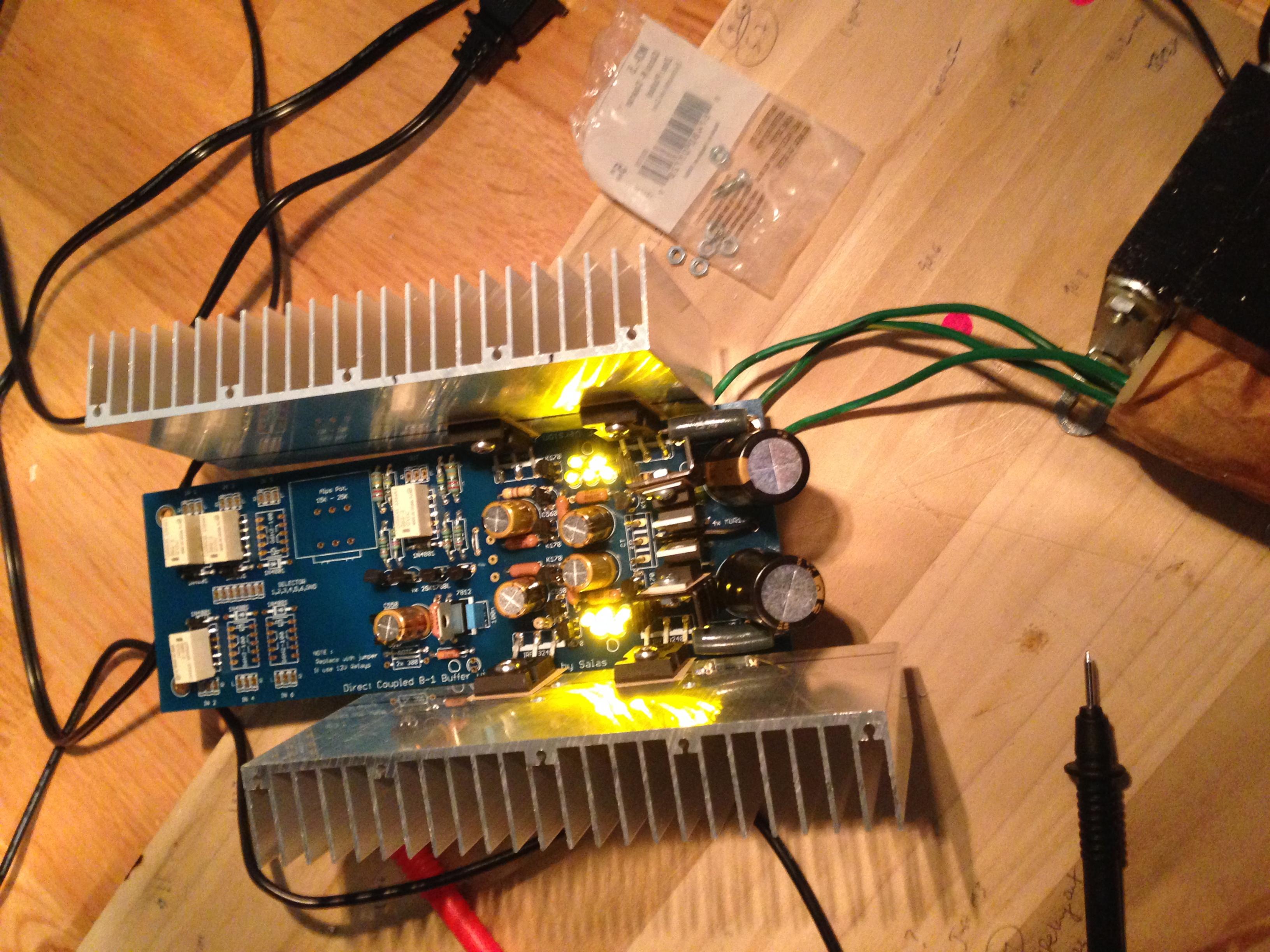

The values on the current setting Resistors is 17 left side and 19 right side I have 10 ohm resistors

What do you mean 17 & 19? Volts DC on their inputs in respect to ground? If you measure each resistor leg to leg do they show 1.5V-2V drop each? That would be OK. Also did you measure DC offset mV across each audio output? Up to 5mV is a pass.

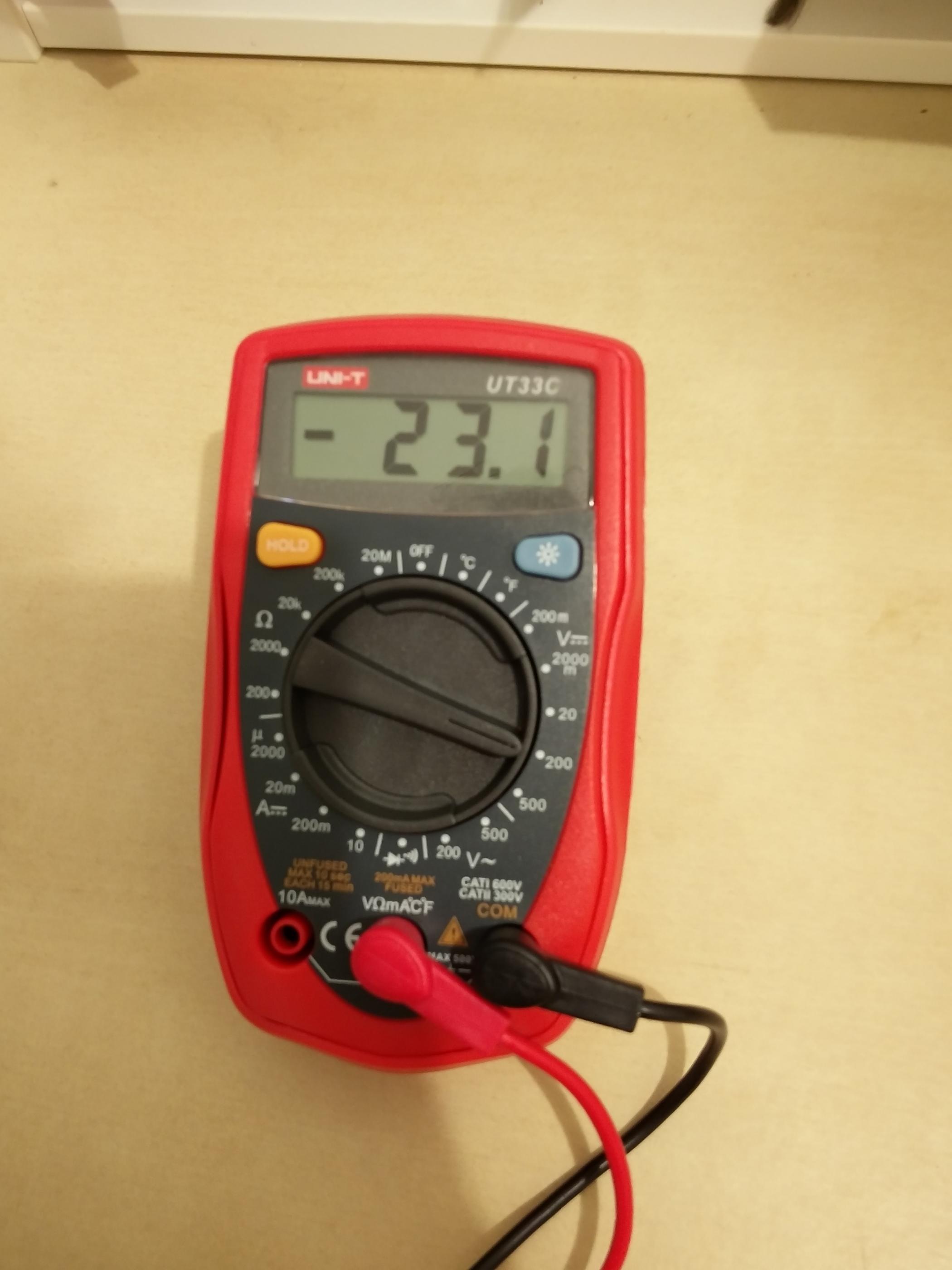

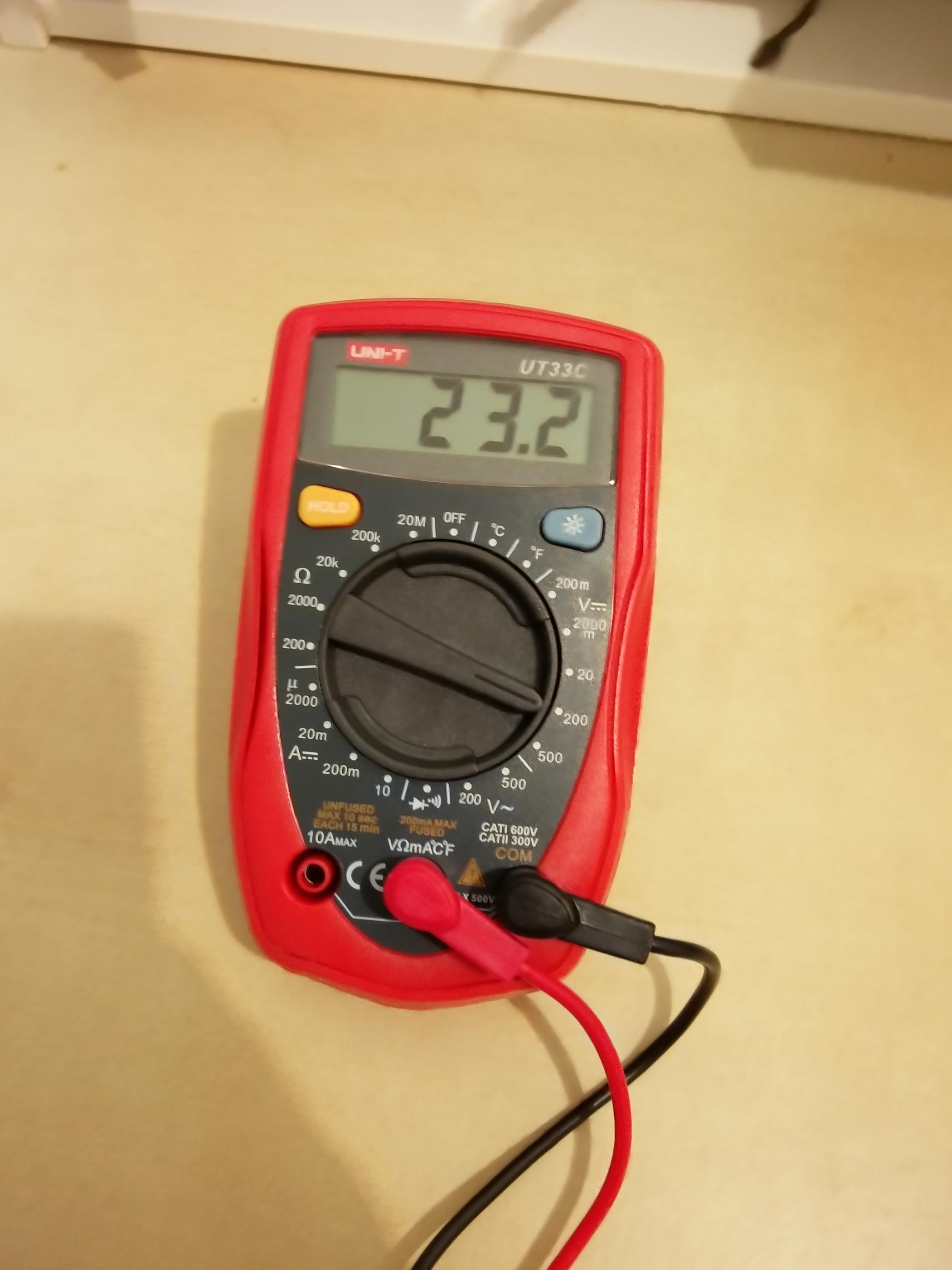

I was measuring the values on resistors only. Will need to modify the probe to measure the values between rectifier legs and ground and Andrew suggested
The voltage drop on the resistors was measured in 2000m range so actually my values should be
1788 mv and 1900 mv which should be under 2v

1800mV and 1900mV on those 10 Ohm current setting resistors mean 180mA and 190mA CCS. Very good ballpark numbers for LEDS and MOSFETS range of VF & VGS expected, also close together. Things look good so far.
I think it's my precision issue. Will try the lower Voltage settings on the meter and report

VGS of the big MOSFETS can be measured between their gate and source pins when they are on and running current. Pins 1 & 3 face side. This figure is subtracted from the three LEDS combined forward voltage drop and appears across the big setting resistors. In that way those resistors value controls the current level by Ohm's law I=V/R. Advanced hobbyists sometimes make special test circuits and they pre-select their MOSFETS at a given current for close or matching VGS when making power amplifiers. Its not a big deal here for their specific operation so we don't select them.
Salas, thanks again. As an exercise I measured the mosfets vgs. I got about 4.2vdc for each. So, with my vtot for the 3 LED per side, that would be 5.7vdc-4.2vdc to equal 1.5vdc which is almost exactly what my vdrop is across the ccs resistor.

Your understanding of the current setting works in this circuit is correct. Keep also in mind that the VGS is a curve that rises along higher current and that is mainly why aradan's build is closer to 2V because he targets just 200mA. There is variation between batches of MOSFETS also. So the more current you chase the narrower the gap gets and the lower the resistor's value becomes, not linearly so. Thus, stronger LEDS make the exercise more practical for low value resistors standard numbers when chasing very strong current settings.

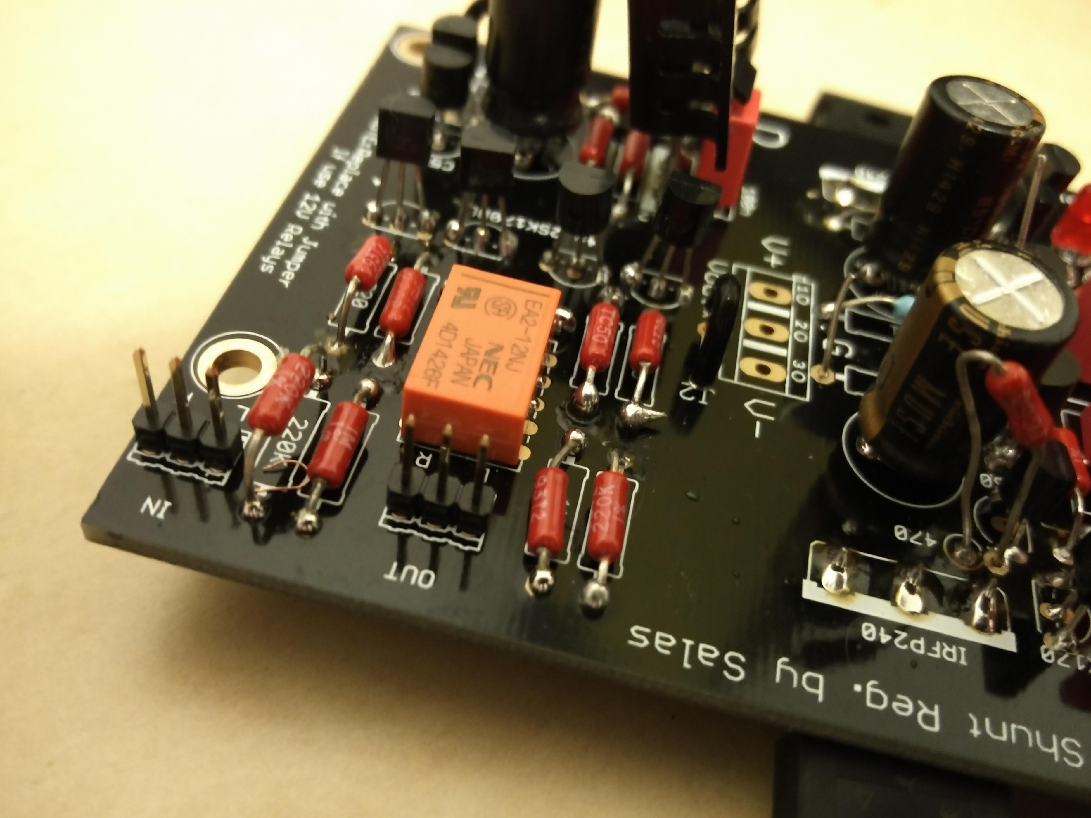

Ok I have done one more step the measurments on the rectifiers.
But somehow I am getting 0s on the outputs.
Measuring between channel and center pin of the output
View attachment 512248View attachment 512249

Your raw DC is much healthy, will produce some more heat on the CCS MOSFETS which is controllable at your 0.2A current level. Extra raw DC level also means lower capacitance parasitics in the CCS MOSFETS though, which is a good thing. Not that much better, but a small return gift for the extra heat.
Provided that the relay clicked, zeros probably mean very few mV that the DMM did not resolve. At least at the range selected as you say.
Many builders achieve 1-2mV DC offset only and sometimes below one mV. That can escape some low sensitivity DMM but not your 22000 counts new one that's on its way.
