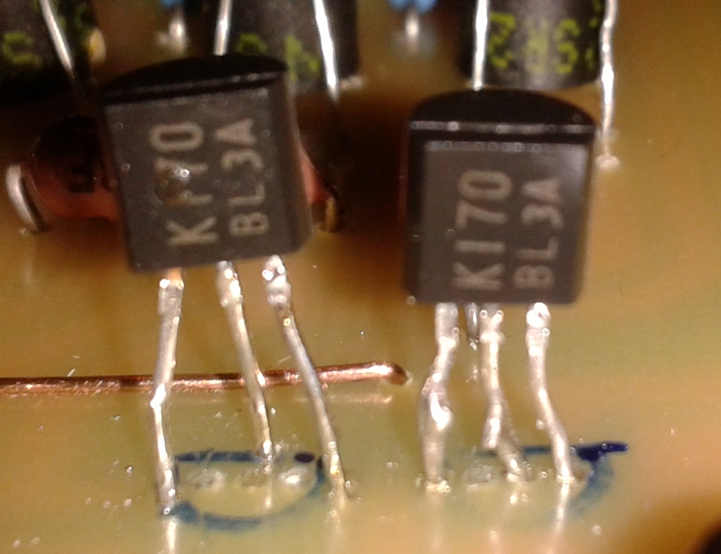

Ok, testing everything I have found something unexpected. If I don't apply any signal to the B1 buffer, the output DC voltage on one channel is 0V and on the other channel is 150mV. Sorry if you already covered this scenario in one of the previous page of this thread. Is it possible and acceptable? Something wrong in my implementation (bad solder joint, not well matched K170)?
Ok, we'd like to have 0V, but in real life what's an acceptable DC offset?
Properly selected k170 should give output offset less than -0.3mV
0V probably doesn't mean 0.0mVdc
150mVdc means something is broken.
Max, how close did you originally match those four signal handling K170s? Maybe you mixed a non tested one with big idss difference during the assembly by mistake. No more than 5mV DC offset should be your goal. Many achieve +/- 1mV

Yes, the problem was the matching: I bought 2 couple of already matched K170 from ebay just to avoid to do extra work.
I didn't have so many spare k170 (just four) but I tested few combination of them and now I have something that works better: 2.8mV
Next time I will ask to someone in this forum to have a well matched set of 4 K170 🙁
Just a generic question regarding K170. Testing the ones I have here I have found better values in case of K170 with the same tag "K170 BL xx" in my case the "xx" was '3A'. Is there any meaning in this last two characters? I haven't found anything using google
Factory code xx. Probably batch. Not meaning something of practical value to the end user. Can you take a clear macro shot of a JFET you pulled and show it here? Genuine ones have some tell tale signs we could confirm or not.
Two pictures (the best my mobile can do), not sure you can see what you are looking for.
In the first one you can see 2 of the 4 'ebay' K170, the ones perfectly matched (DC=0.2-0.1mV)
In the second picture you can see the 'not so well matched' k170s. The one on the left comes from ebay and the one on the right comes from a standard channel (mouser if I well remember) - they look like the same to me. As you can see, life was harder for these components: lots of test directly on the circuit.
They all look alright for proportions, pins style, and print. I see you populated them in reverse to your outline marks.
Yes, but they are right this way 🙂
I picked up a generic transistor during the design of the pcb but before soldering I review the datasheet of K170 and ... I reversed the orientation.
