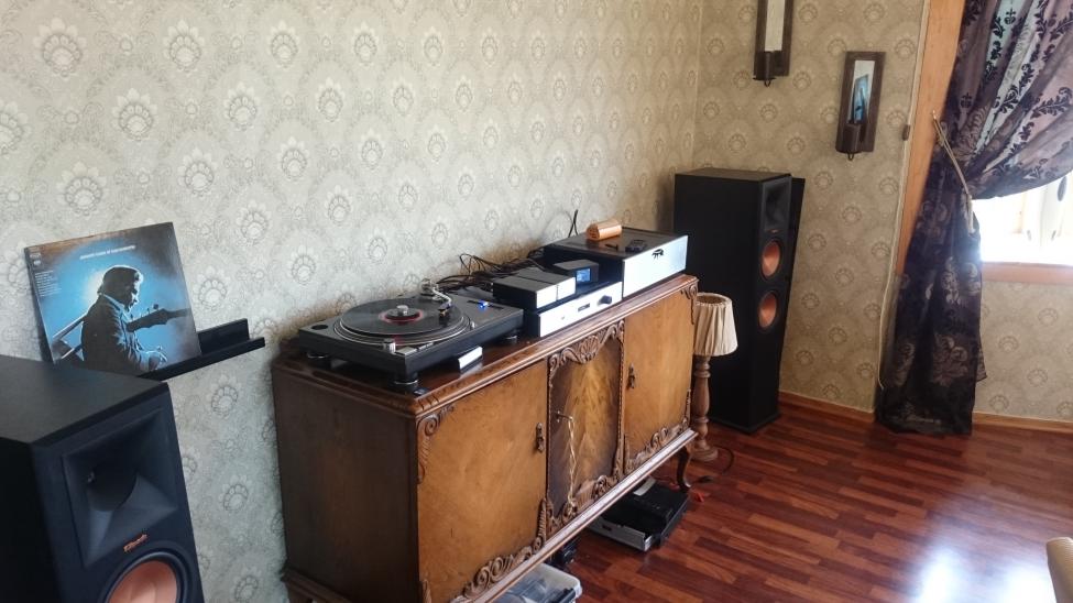

I'm running a At150mlx on a technics sl1210 through Audiokarma Cnc phono stage through Lcduino selector/attenuator, dcb1, Honey Badger amp and Klipsch rp280f.
I will try 3.3 ohms first as I don't have any 4.7 ohms available. If it overheats I'll put back the 10 ohms and put 4.7ohms on my next order.
Nice classic surroundings, loud long throw system. Correct choice to use horn speaker for that positioning. I also like your cartridge model. Congratulations.
