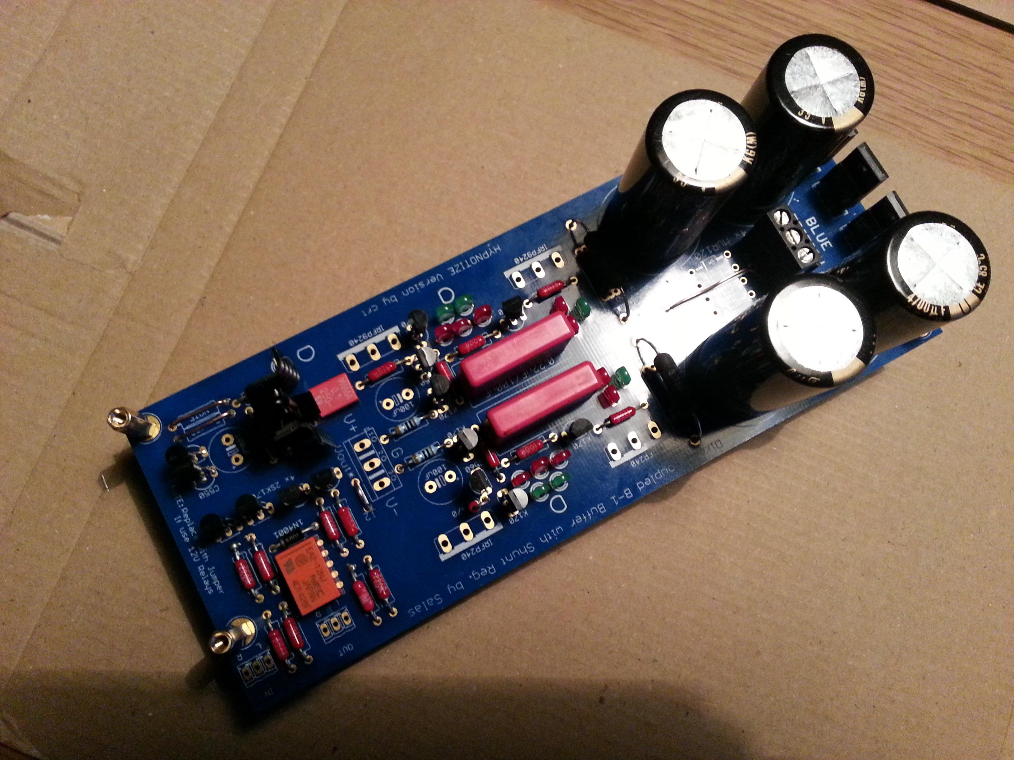

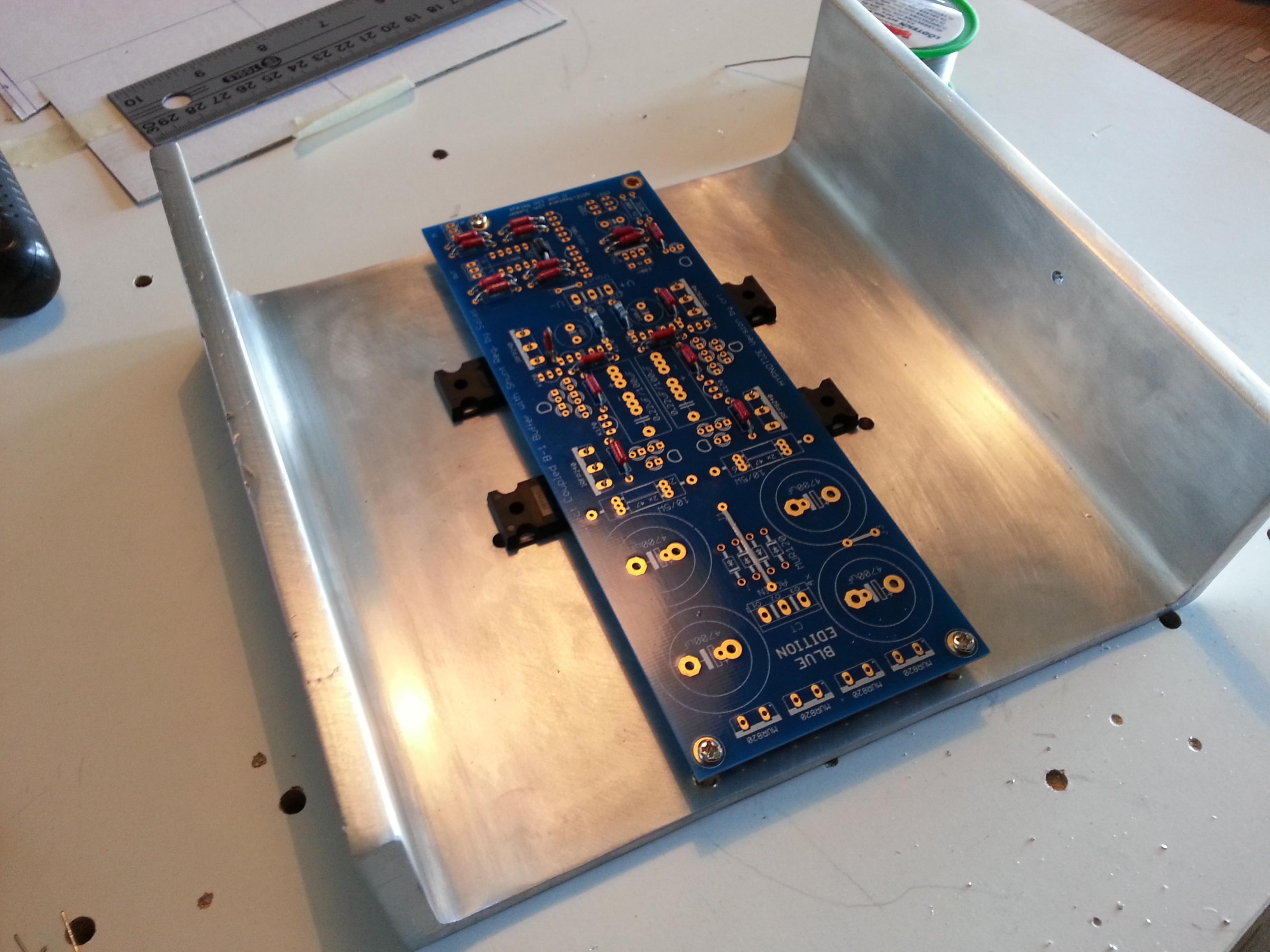

Finally, after having read the full thread, I feel brave enough to share a picture of my yet unfinished DCB1. I am still lacking some essential parts and due to holiday economics and home refurbishing it will remain unfinished for quite a while.
The chassis/heatsink is an aluminum U-beam I got from work. I am tinkering with the idea of making a nice wood enclosure.

Are my pictures too big; my browser is having trouble opening them...? Good thing I know how they look 😀
