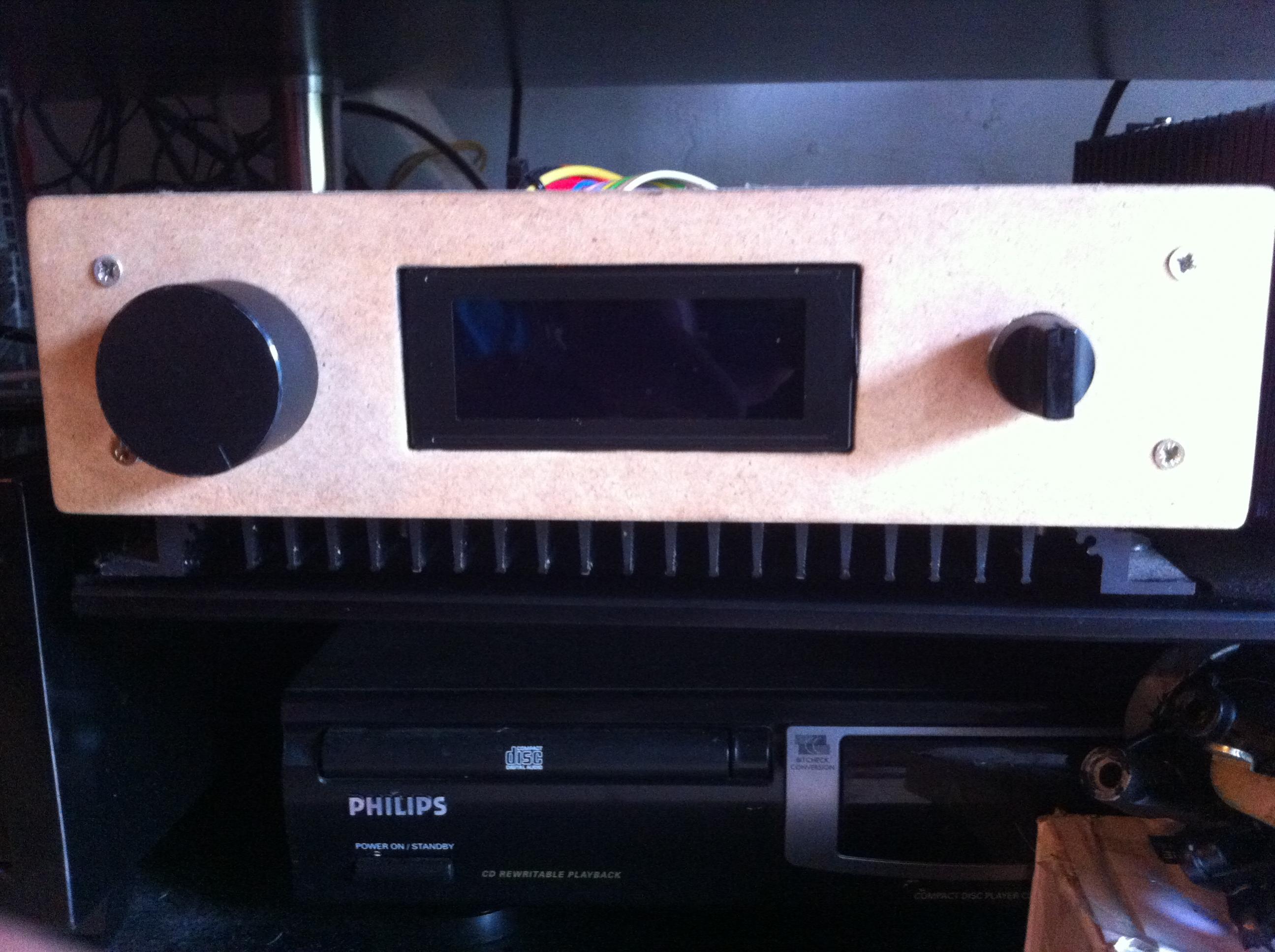

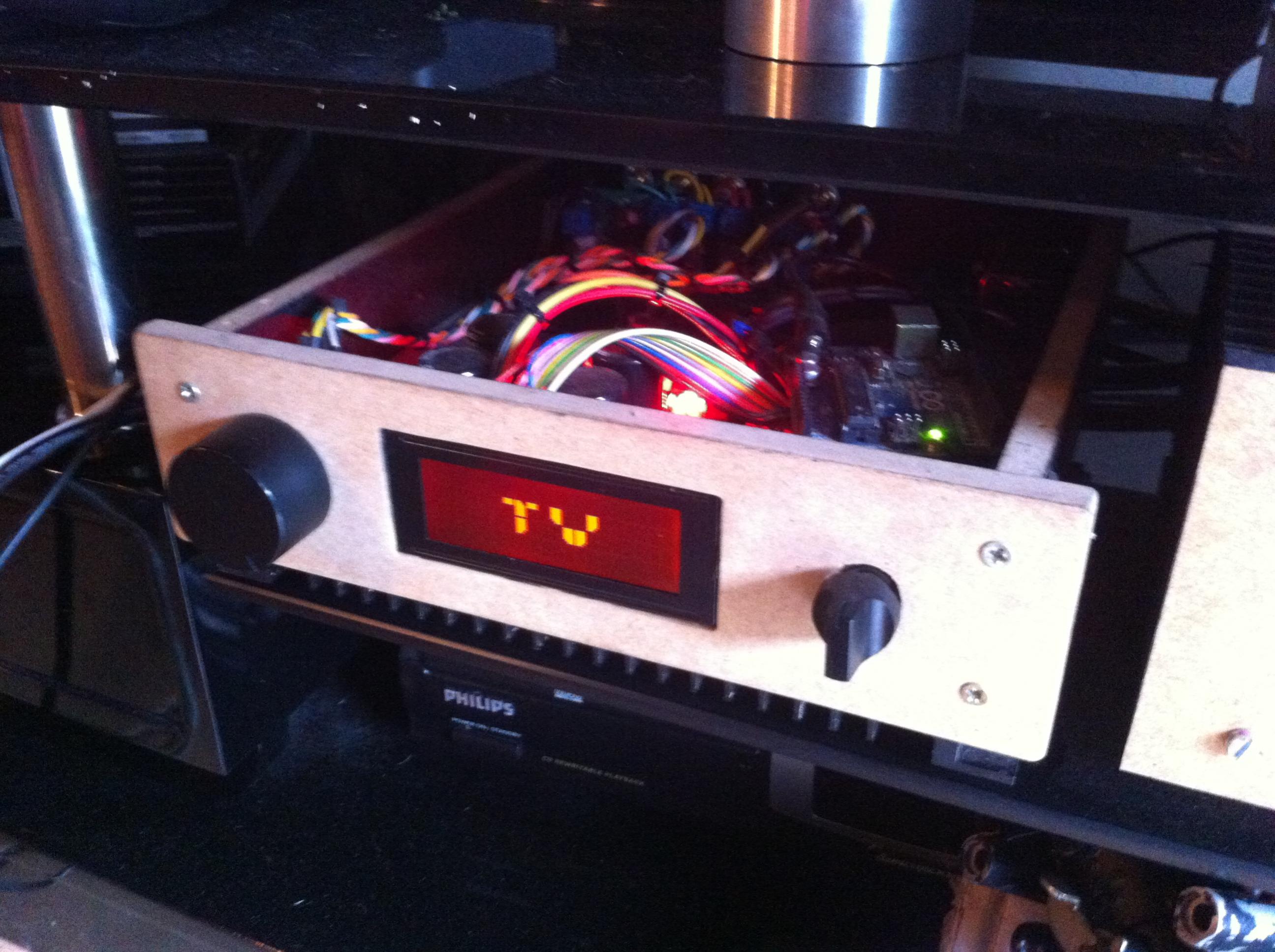

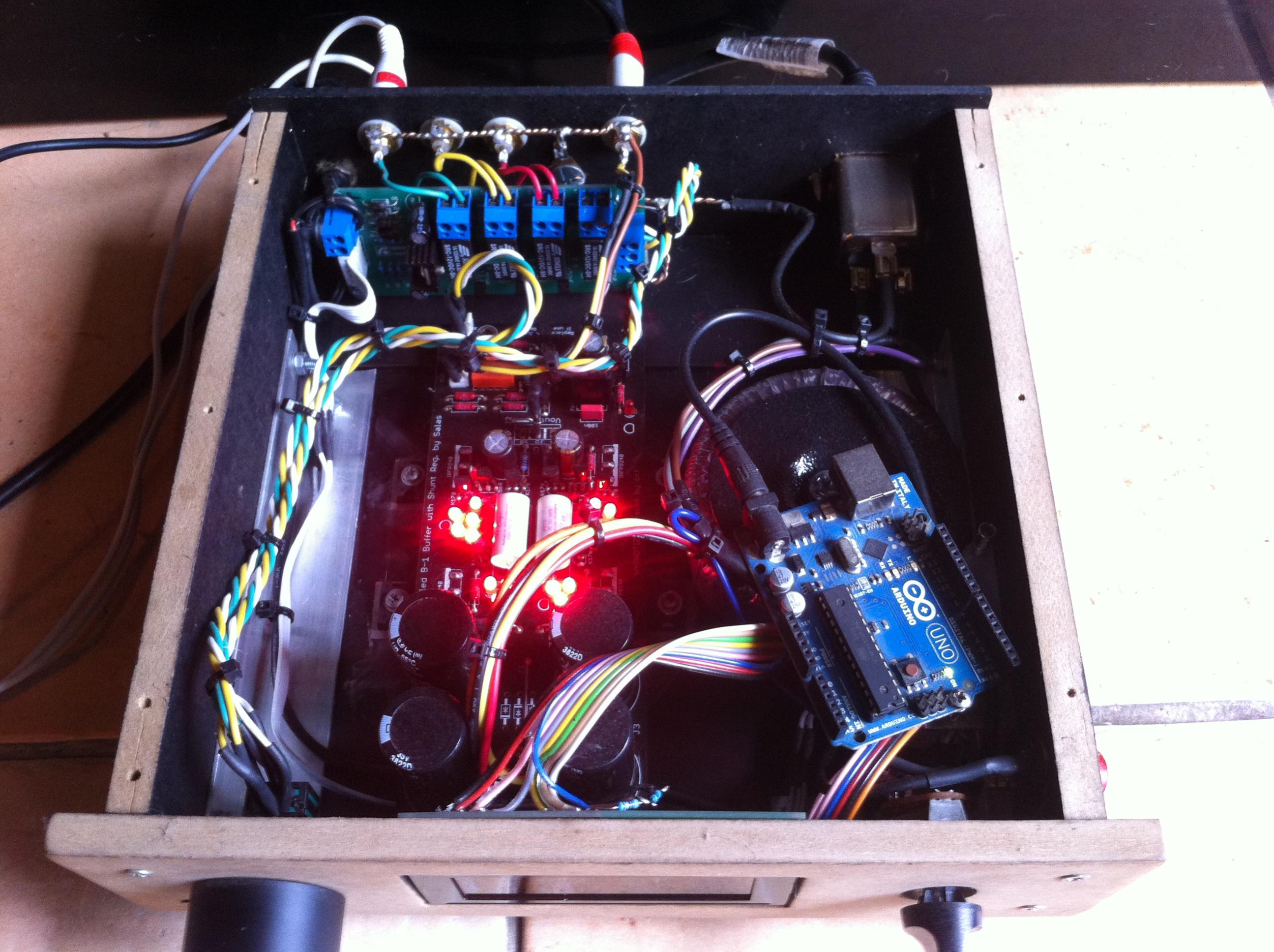

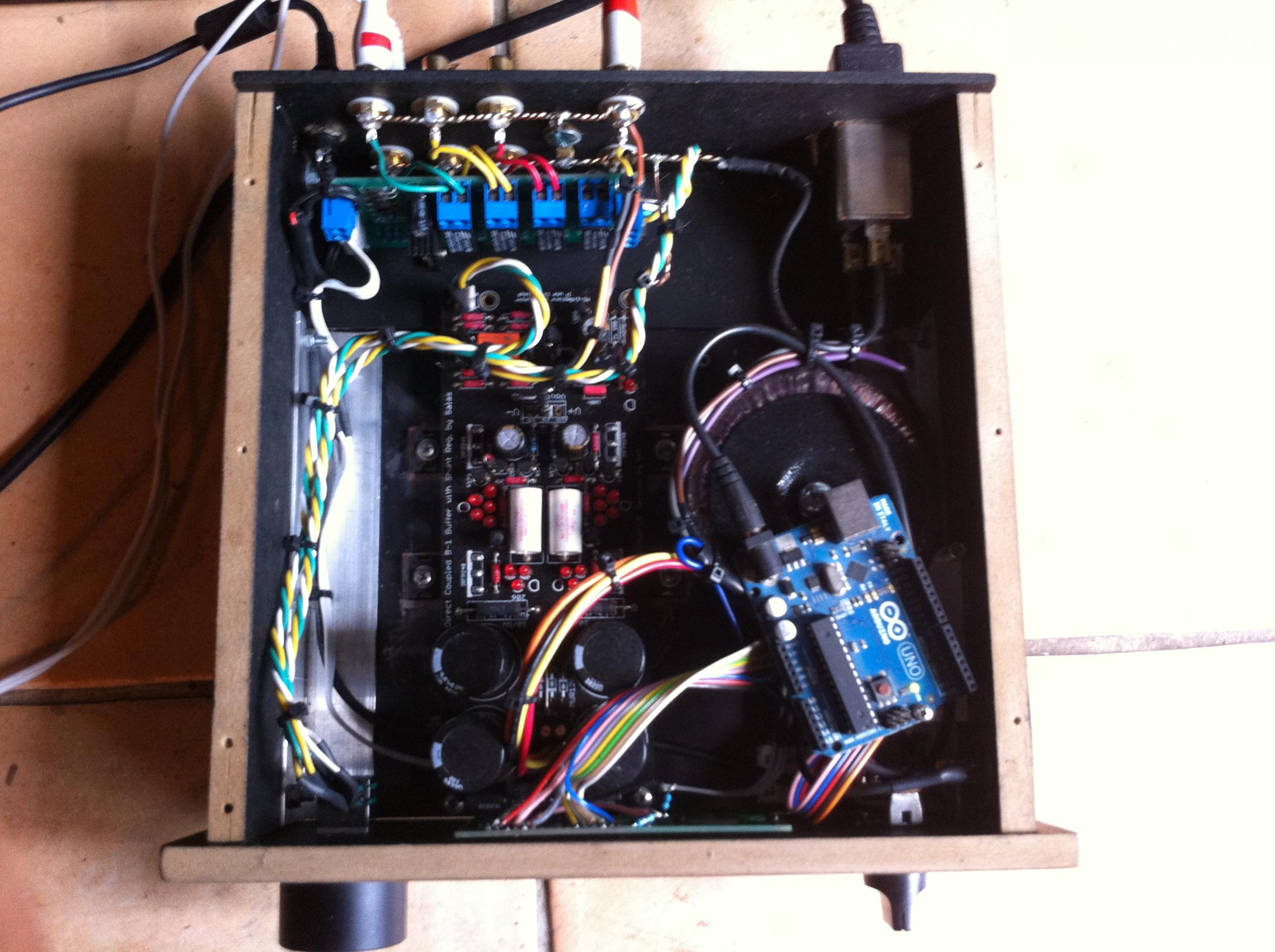

i enjoy my dcb1 with my litlle ACA 🙂🙂. big thanks to all and diyaudio
some pictures to my modest work .
Magnifique!🙂
Tell us more about the rest of your system.
Magnifique!🙂
Thanks 🙂
Yes , i use m'y system with Tv and music only on phono .
I made Tony gee lbs clone ,m'y tournable is a 1200sl mk2 with ortofon blue , so dcb1 , ACA, and a preamp phono grado ph1 clone . A day .. I want to make your simplistic phono pre .
