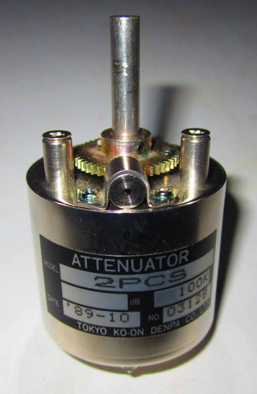

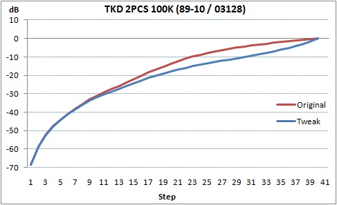

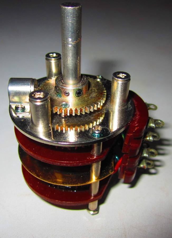

TKD 2PCS 100K measurement

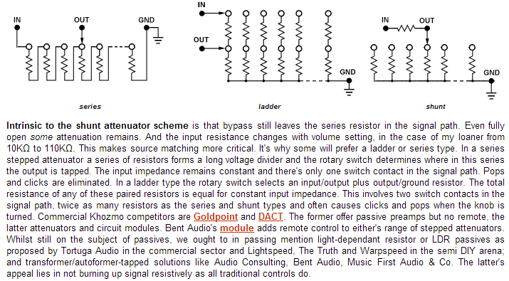

I just completed measuring this tkd by using sanwa pc500a dmm and the result on attached pict 1&2. Channel matching is very good, when I measure from In to Gnd, the result on dmm always shows 125.2 kOhm from step 1 to 40. I think that this tkd is series type based on measurement result and pict 3 explanation.
To keep Salas sugestion @25K and keep full attenuation capability, I'm planning to tweak it with R paralel 33K from Out to Gnd, where calculation seems good.

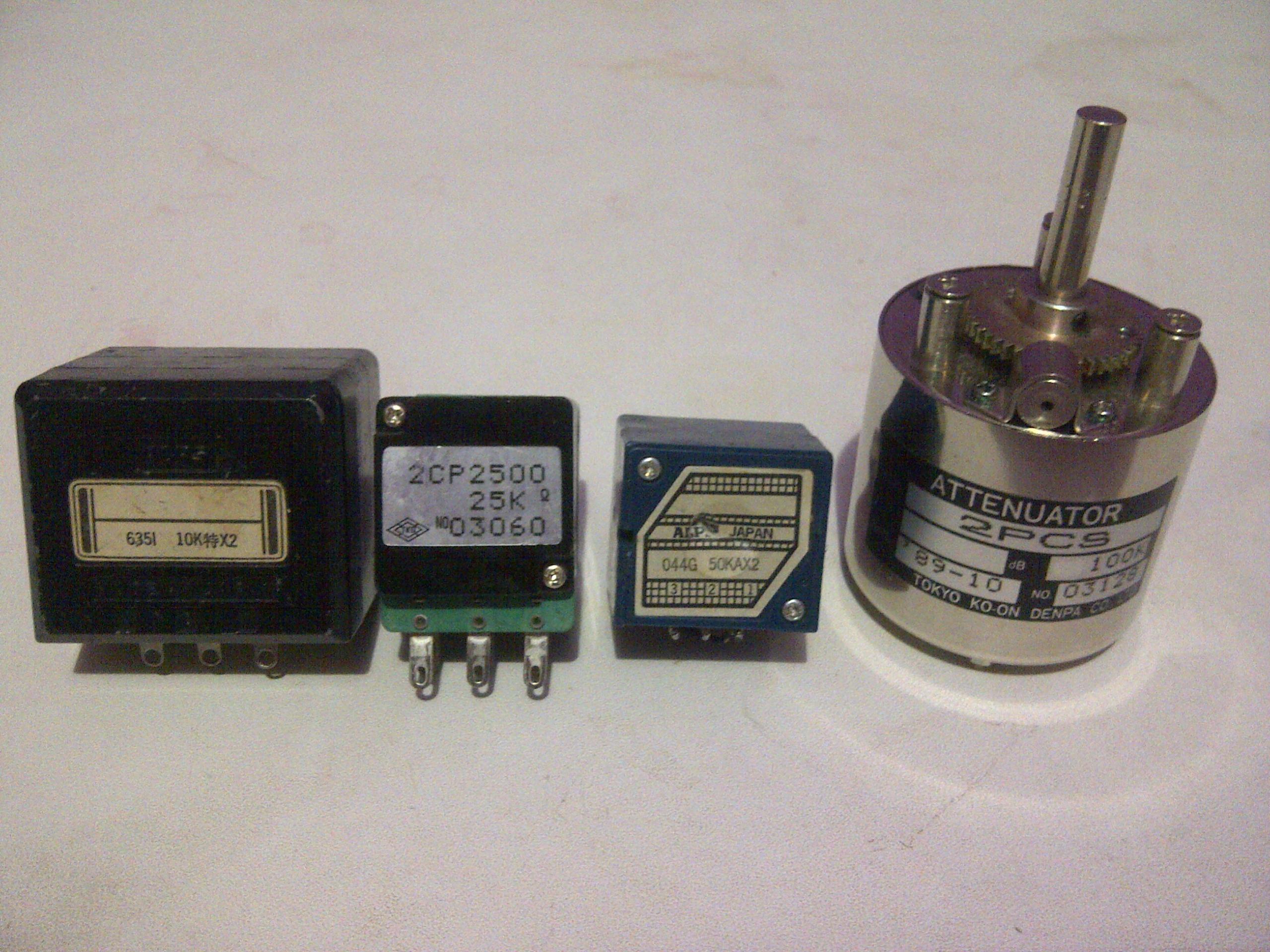

Other pictures are just reference for anyone if interested, since I can't find much info about this att on google. Another exploration is that on first 20 steps are using smd resistor,while next 20steps are using very small through-hole resistor.
