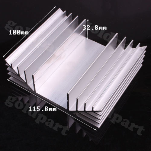

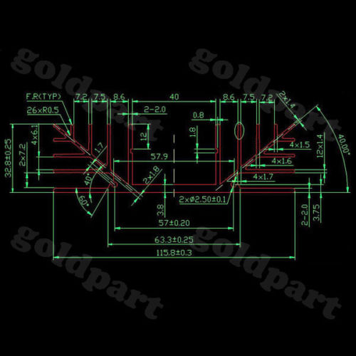

Salas, I bought this heat sink on eBay just using a dumb "that looks beefy enough" approach; it's from China with no real specs except the dimensions. My plan is to bolt cut in lengthwise down the middle and bolt two transistors to each resulting half, as well as down through the bottom plate of my case, which will be large and is a perforated 1mm aluminum sheet. The case will be well ventilated.
If I'm running 600 mA, do you have any gut feeling about whether I will have adequate cooling? Thanks.
I don't think you will have excessive heat with those. Get a cheap K thermocouple temperature probe from eBay or somewhere too so you can monitor your results. Just 100mA less can make a good difference if some thermal scheme is on the edge of becoming uncomfortably hot.
The MOSFETs are quite tough themselves but too high sink and case temperature makes a build problematically hot to operate and touch plus it creates a baking pan for the rest of its components shortening their lifetime.

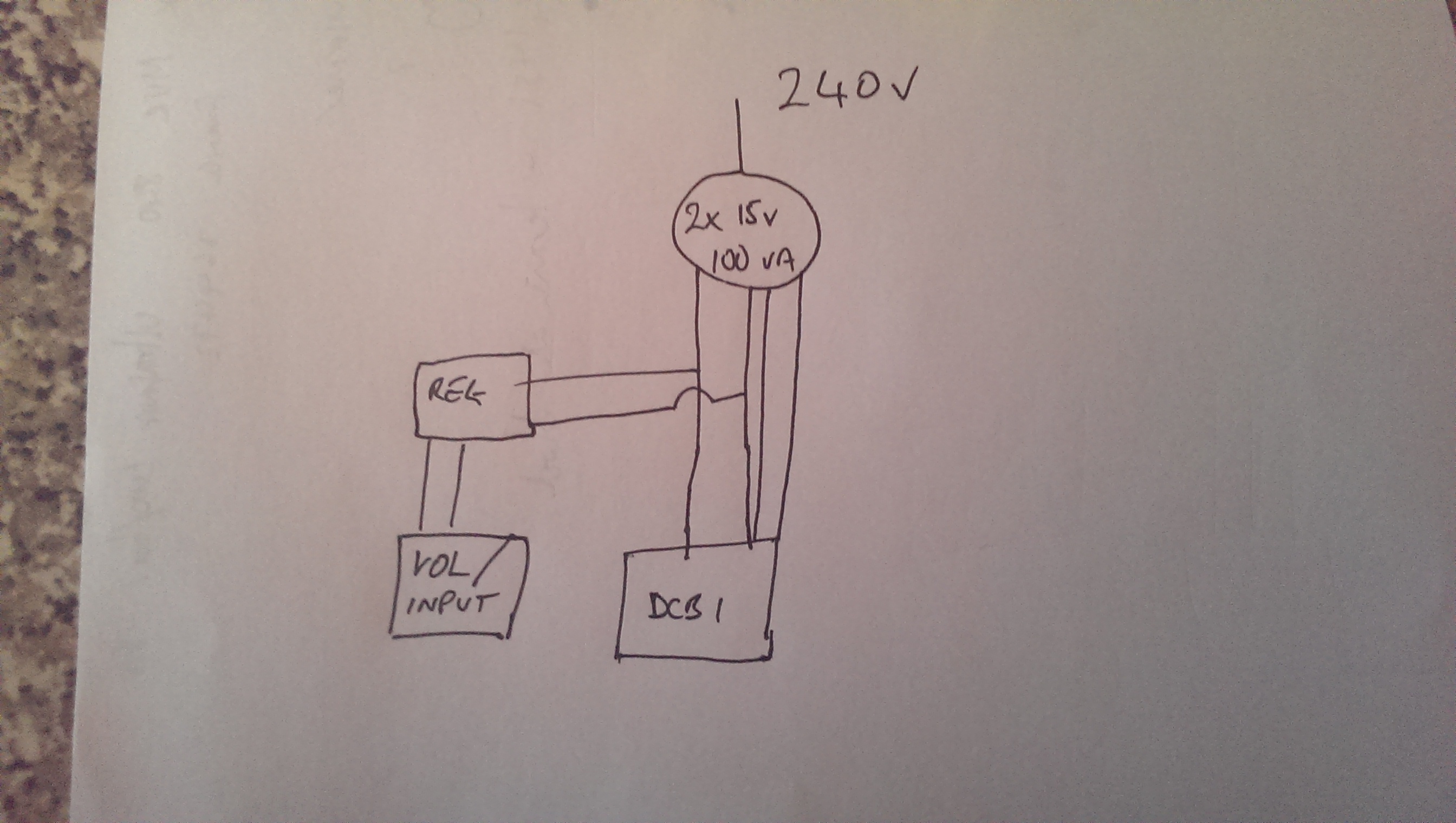

When powering a remote input/volume unit how would recommend doing it to minimise possible interface without using a separate transformer? U

ZIt looks like we are trying to achieve the same thing except I was hoping to power everything off of one transformer and the Goldpoint and Bent audio stuff is a bit out of my price range.
I can't measure any interference so I might just plug it in and see what happens.
I've attached a very tough sketch of what I'm suggesting.
