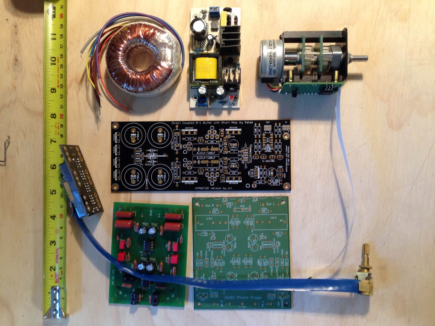

OK, here's my latest layout, while I wait for the 50VA transformer (and before I return the 30VA). You can see I have the Bent Audio remote control on a Goldpoint attenuator, and a 12 VDC power supply ($7 on eBay!) for the remote control motor.
Waiting on heat sinks.
