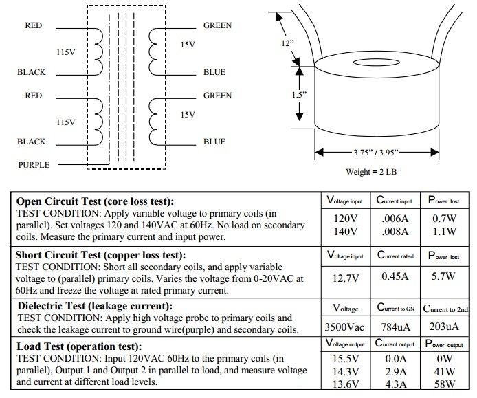

Hey, I know this is buried somewhere in this thread, but how should I wire up my Antek transformer (see image below) to the AC In (01 02 03) eyelets? Thanks!
The two secondary wires that are close together in the picture go to the middle connector screw. The outer ones go to one side screw each. Ask Antek if you ain't sure which wire is which and on how to recognize/configure the primary wires for your country's mains voltage.
