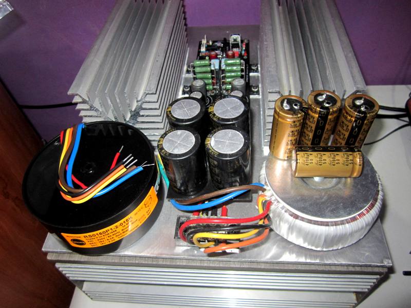

Just received talema encapsulated 2x15V 160VA after 3 months waiting. I need advice for below questions:
- Currently I'm using 4x 10.000uF off board with speaker cable connecting them to pcb trace. I'm confused now after reading latest comment from salas, should I keep it or changed it with 4x 4.700uF so I can solder them on pcb?

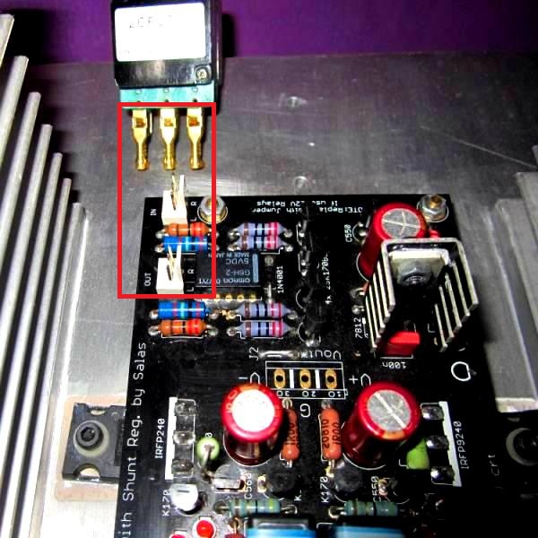

- Will it degrade signal quality if i use socket connector and potensio leg connector instead of direct solder?

You got to try out the caps in both ways and see what you like best. Its not only the connection its they are different types and value as well.
Solder brings additional security, but proper press fit mechanical connections can be very good too if they feel well designed and tight.
I think i'll swap those caps with 4.700uF to simplify connection, I'd rather try out different potensio/attenuator (i'm saving extra money for tkd 2P65CS) which resulting me thinking of those connectors. those mechanical connections are so tight 😀
