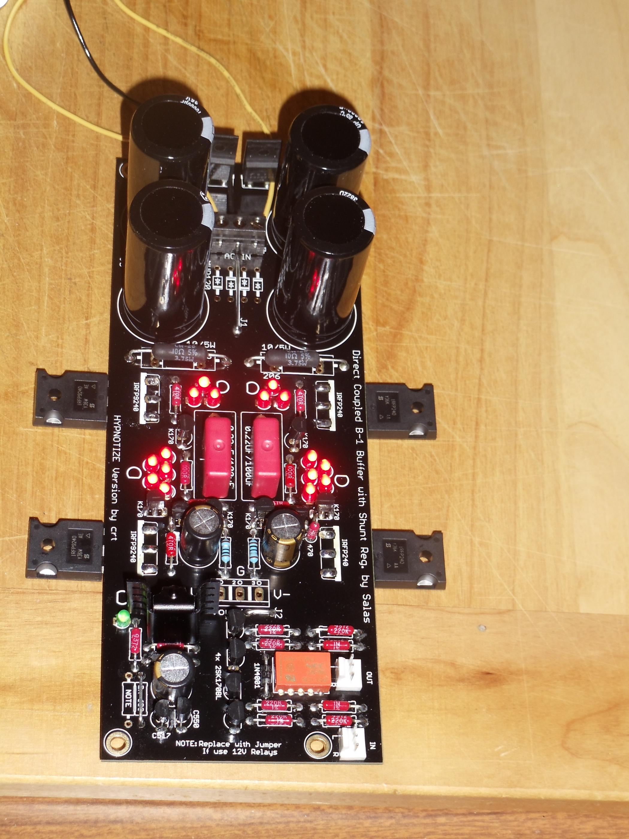

Measured voltage drops across the current setting resistors are OK, do DC mV offset measurement across each audio output also. To post a picture press the "Go Advanced" button under the reply frame and use the "Manage Attachments" menu.
http://www.diyaudio.com/forums/attachment.php?attachmentid=408645&stc=1&d=1395959331
Here it is , I hope. Please review how to measure dc offset at outpost.
Looks very well put together. But don't run it for more than minutes without sinking on a metal surface or real sinks at this current setting. Don't forget it needs insulation pads on the MOSFETS backs when you will do the sinking. To know DC offset you just need the DMM on DCmV range with black probe on center pin of the out Molex and red probe to L, then to R.
DC offset: .004v and .003v
Using inexpensive Radio Shack 25.2 VAC with center tap. 12v to each side.
You got no DCmV range on the DMM I assume. Its still low enough an indication even if possibly rough. Concludes that the relay makes contact, the buffer circuits are alive, and the outputs are safe for connection to an audio system.
