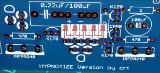

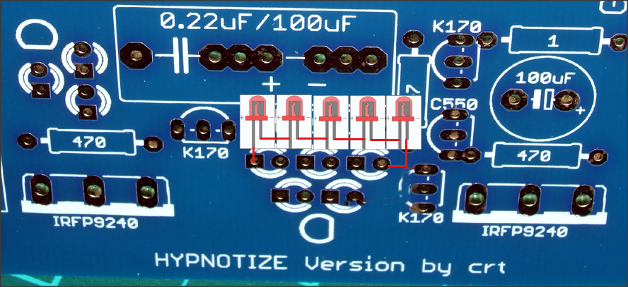

Hide the botch legs by doing the work underside pcb and verify the continuity with the DMM. Make sure you will not make contact with other irrelevant nodes along. Good luck.
I was working on this... I had both groups of 3 going and the group of 5. The group of 5 on the bad side I was working I got wired like above... i turned on the unit and the one set of 5 I was working didn't come on... I cut power and then that set of 5 I was working came on for a bit while the power was coming down. They were running on the capaciator load I'd guess.. I tried a couple times more and now none of the LEDS come on. I'm guessing the 240 pair or the 9240 pair are killed in all of this.
Too bad. At least you gave it a go. You could have had damaged semiconductors also as you say.
I was hearing switching when the bad set of 5 came on.. That switching sound stopped and then no LED lights at all.
