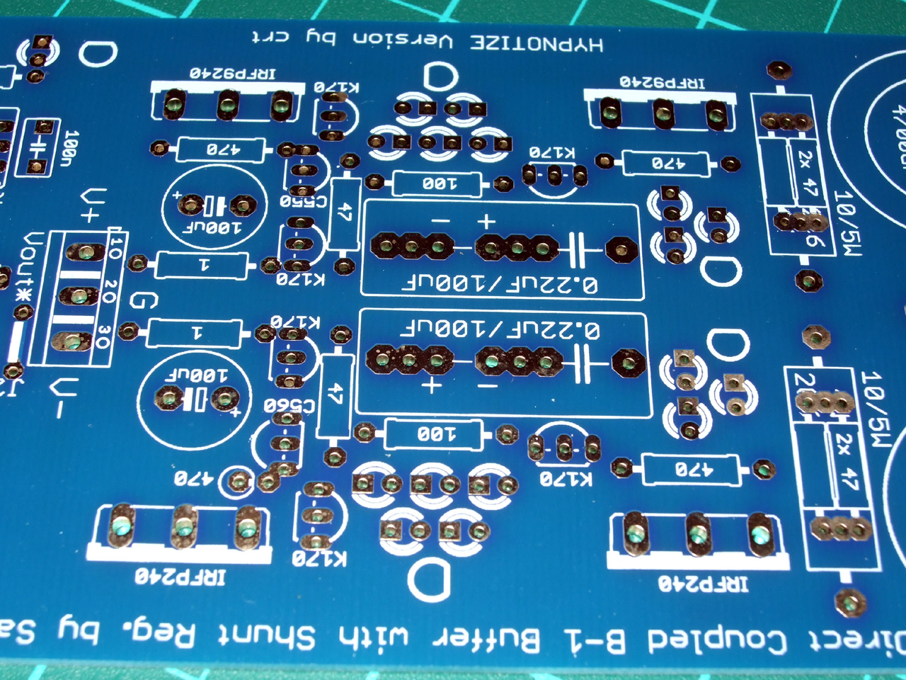

Do you position the led and have anode in square like position image on pcb or do you go with the anode in round?

Its impossible to have different connections and pads in boards circulating since the Gerber file that drives the production machines is the original for dcb1 blue and I am sure I never issued a later one by further collaboration with Crt. Just follow the D symbols for positioning the LEDS.

Here is a picture I just took from an original blue from the couple I kept. Its like your black for pads and D symbol. ONLY FOLLOW the D symbol next to the rows of 3 and 5. Don't think about the pads. Straight side of the symbol means straight side of the actual LED's rim, it is the cathode's side.
This is perfect
