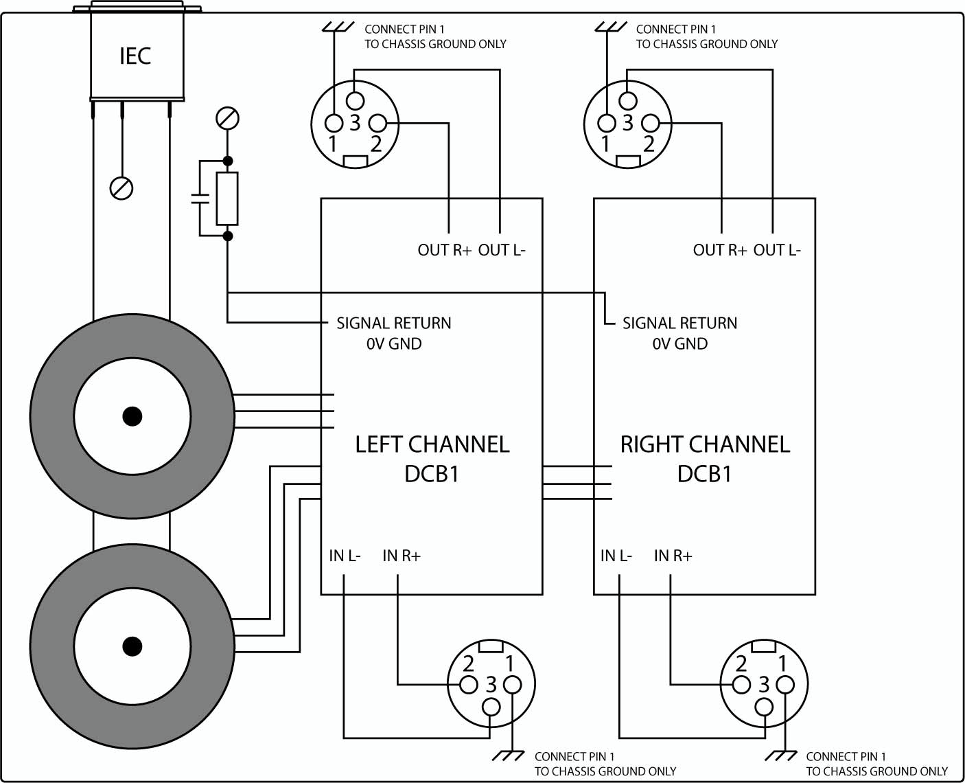

I got 2 PCB´s (one for each channel) from Thea-Bag because I want my DCB1 to be balanced. I'm pretty new at DIY amplifiers.
So I got a question about the wiring at the inputs, I can't find the answer anywhere, searched this forum and google a lot.
I will have most XLR inputs and only XLR as output, but I would like to have one or two RCA inputs but don't know how to wire them, hopefully one of you help me???

Thanks Salas. The XLR looks very easy to wire, but still can't figure out how to wire the RCA connector when I have two boards?
For RCA yes, L- points will be left unused. RCA is single phase.
So to have the option of an RCA (unbalanced) output, one would apply the same logic to the output side?

Is the DCB1, as configured in Salas' post above, able to drive BOTH Balanced and SE outputs simultaneously?

Is it correct to determine the combined load as follows?:
(1/Zin1 + 1/Zin2)^(-1)
Where Zin is the input impedence. (I realize that balanced inputs may/will have different Zin than the SE inputs)
